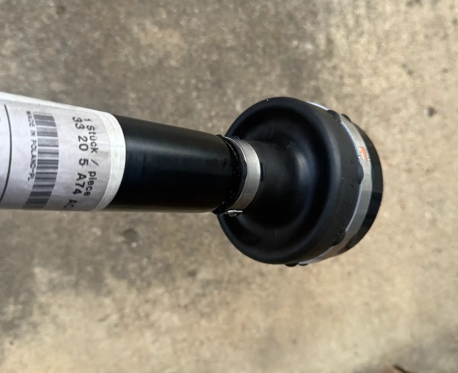

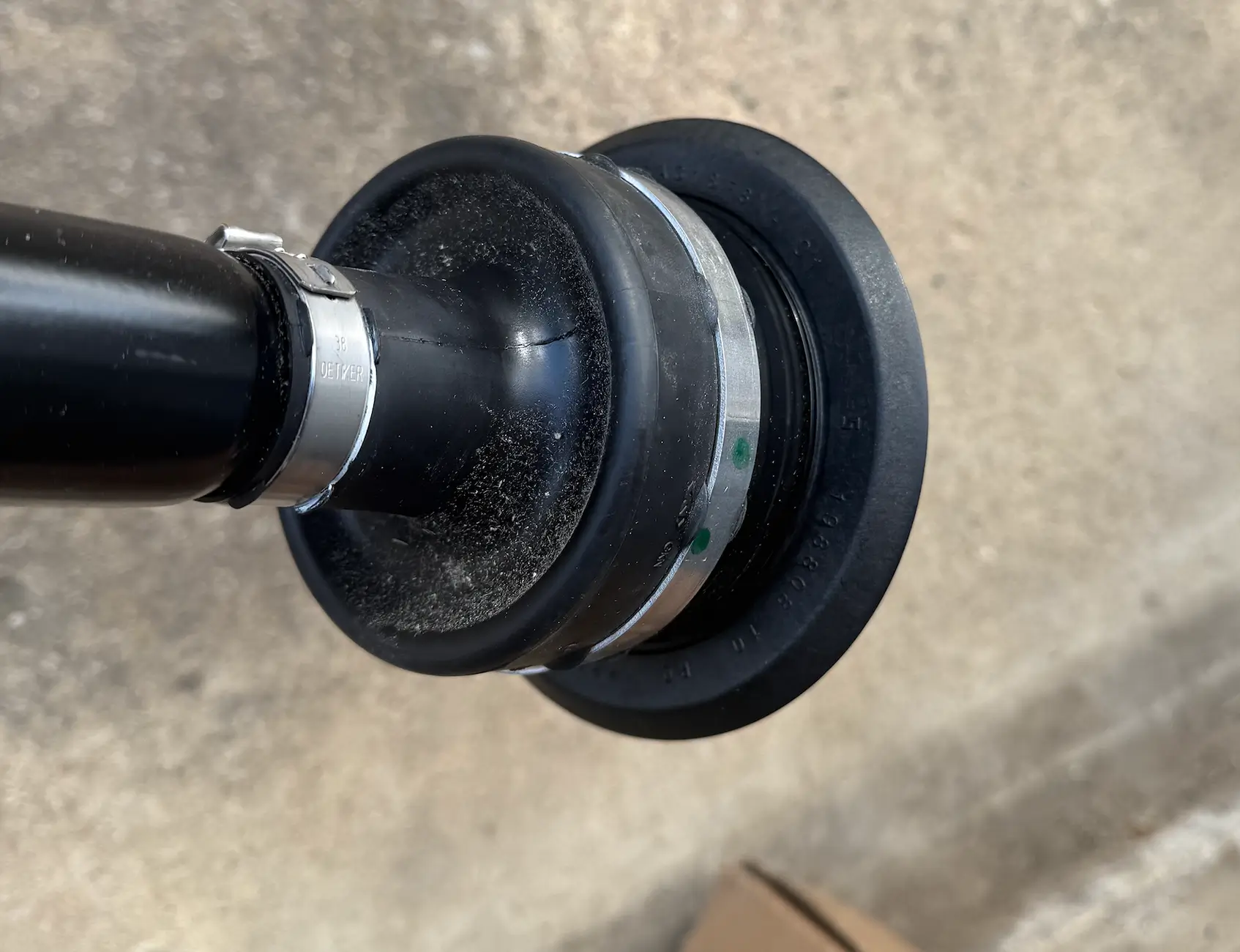

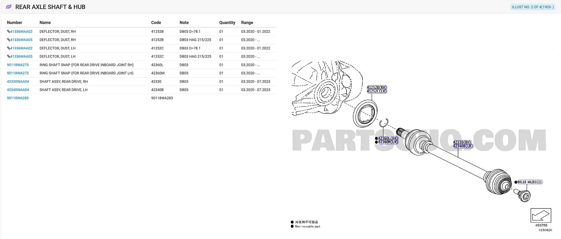

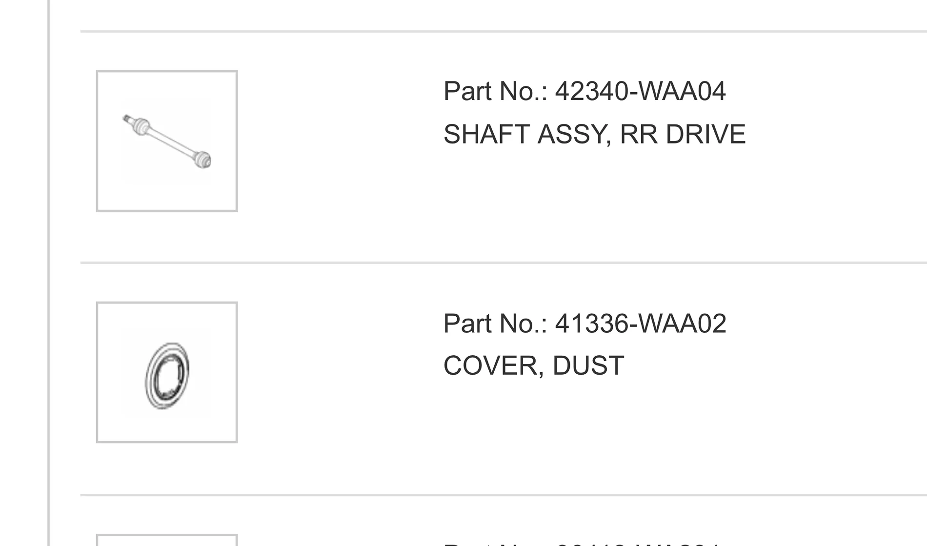

So I have an update/question.... I ordered part number 42340-WAA04 from Toyota parts online and received a different looking part. I was wondering if anyone here can help me validate the part number? I entered the car VIN and it is supposed to be correct according to the website but I am now doubting that after comparing both parts.
Edit: Attaching a picture just not working right now :/

is yours 42340-WAA06 instead of 04? apparently toyota replaced 04 with 06 for the left side axle

yours look like the new updated part number: 42340-WAA06
the boot looks different on the updated part like the one you got

new revision. bigger boots, thicker bars, better cvs.
