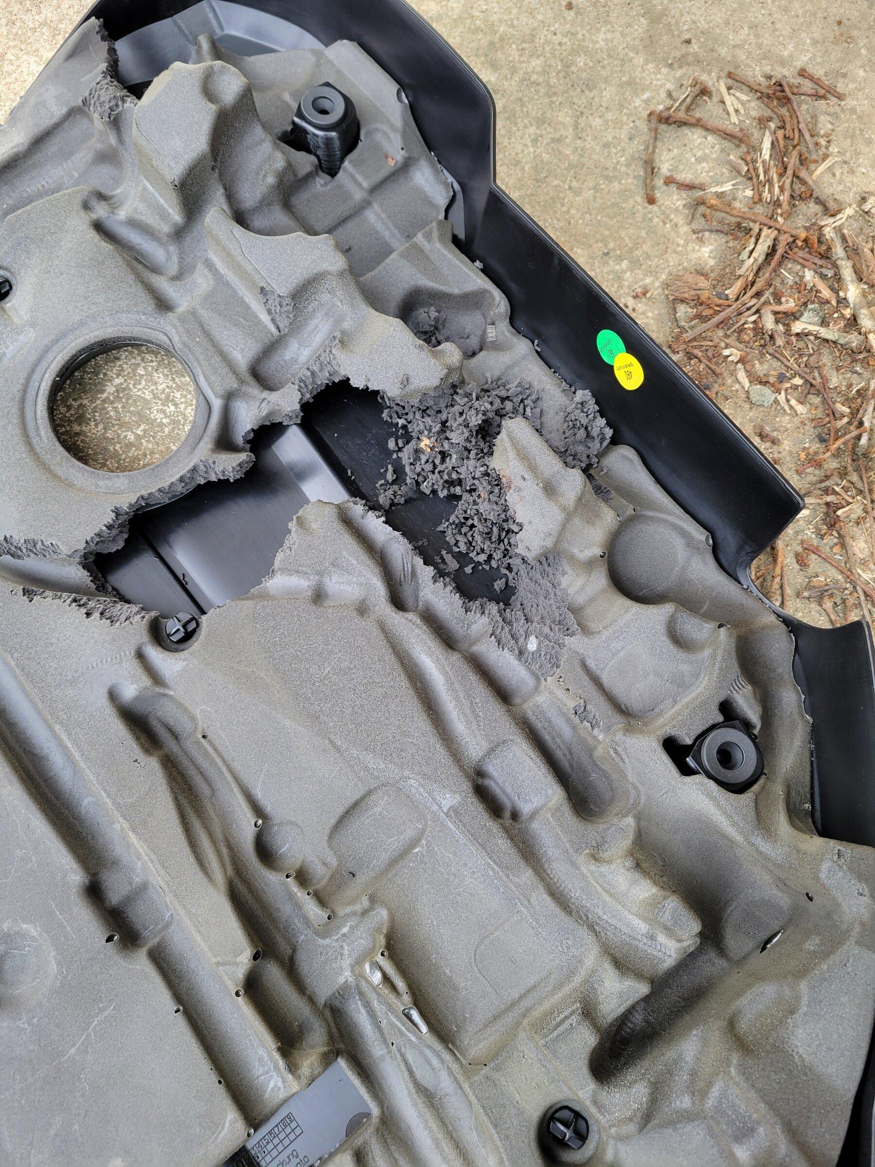

I live in the woods. It was mice.

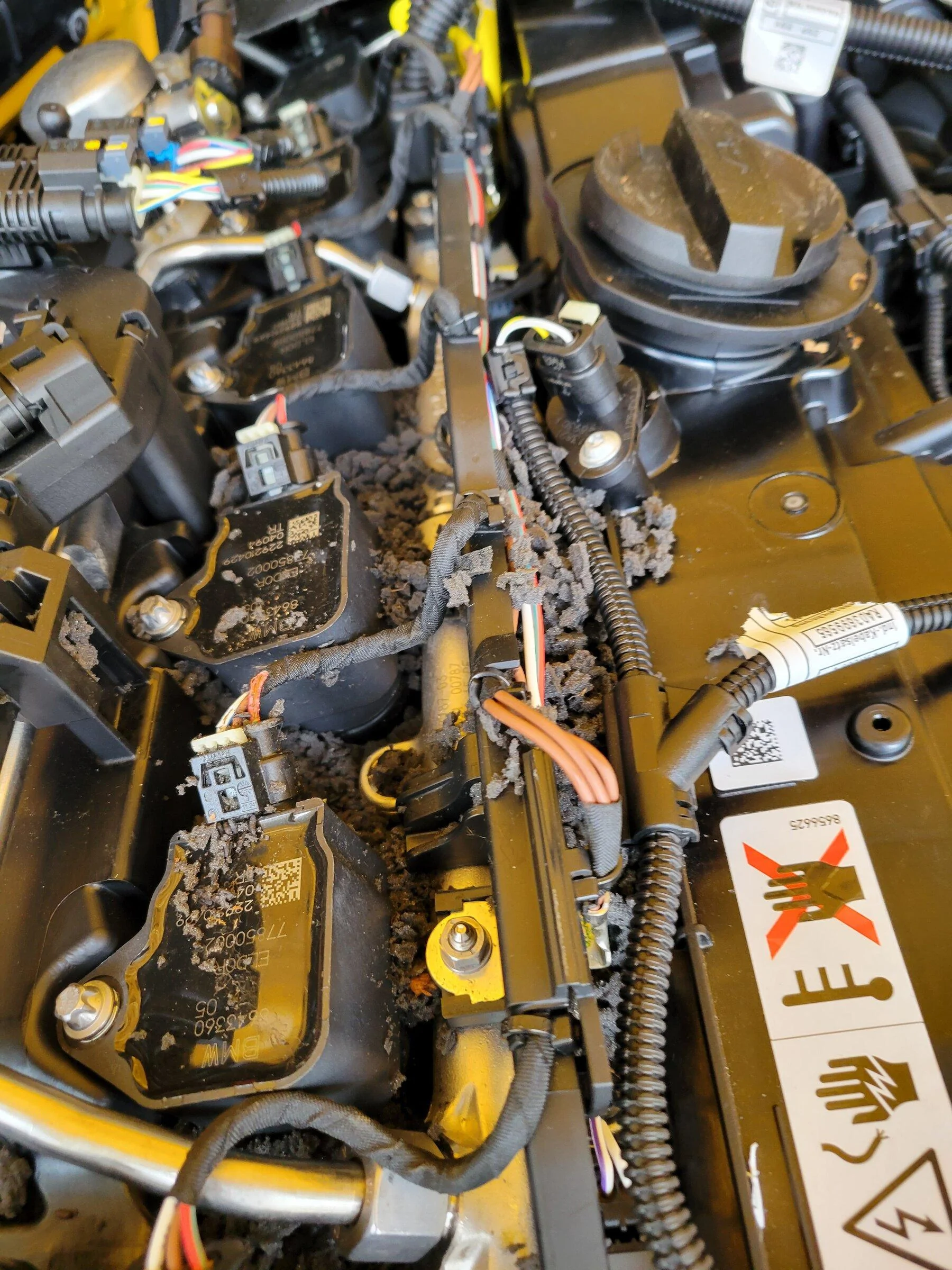

They gnawed on one. Looks like they ate the sleeve of the wire but not the copper. I wrapped it with electrical tape.
I was popping the hood to check my ecu to see if it was easily tunable. It isn't and my car is being eaten. Not a good day.

Anybody know the part number for the wires that plug into the coil packs? I wrapped it for now but I should probably replace it.

Wow... I thought my 24 hour rabbit fiasco was nerve wracking... and all he did was shit all over the garage and a bit on my engine cover. Thank God he was a committed vegetarian, and didn't chew on anything at all that I can find!
Looks like they were working on making your engine bay their new winter home and doing some pre move-in renovations! :eek:
