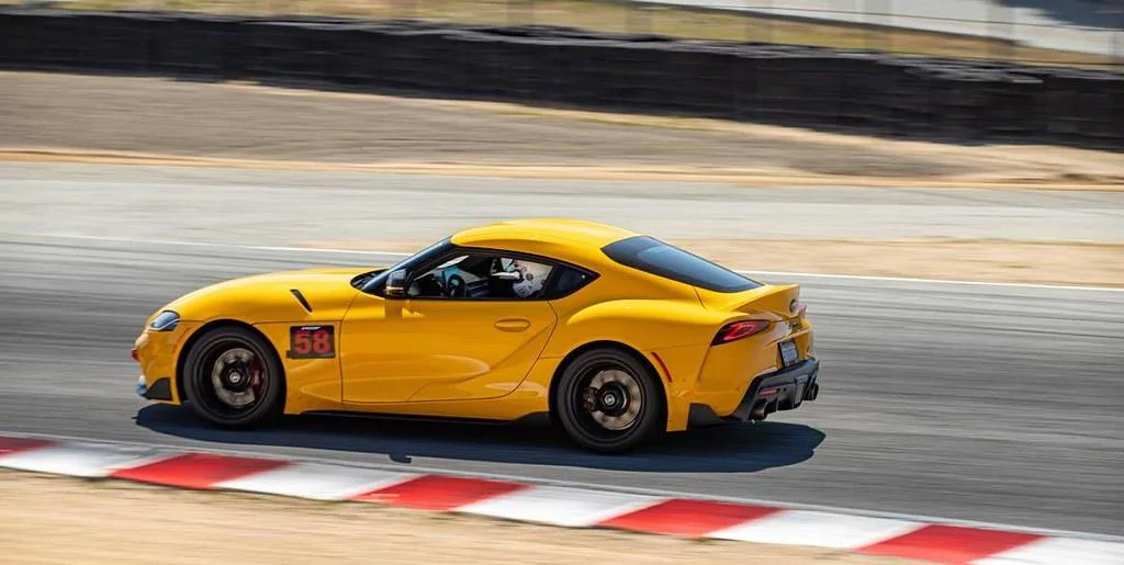

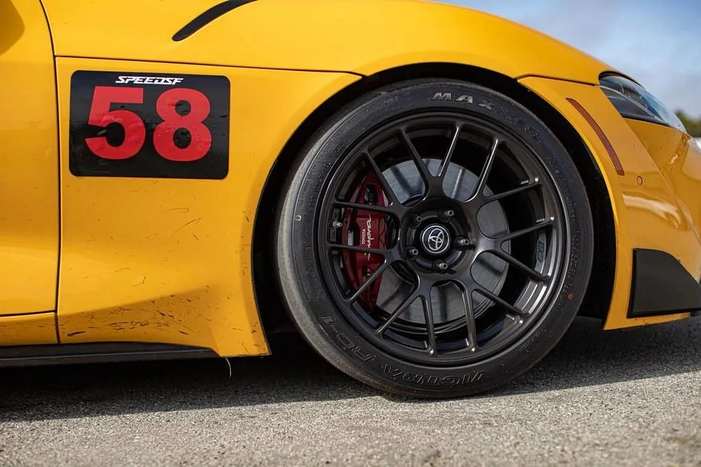

Our Market Research Manager Joe McGuigan is actually an instructor with Speed SF (red MR2/MRS, white BRZ) and several of his friends are running our 18x10.5 ET38 Forged EC-7Rs on track on their Supras at the moment. We don't have any full sets of the SM-10s on track or running around right now as they have yet to arrive. This Group Buy is for the very first production run so we don't have any 4 wheel sets for you to look at before the Group Buy ends, unfortunately.

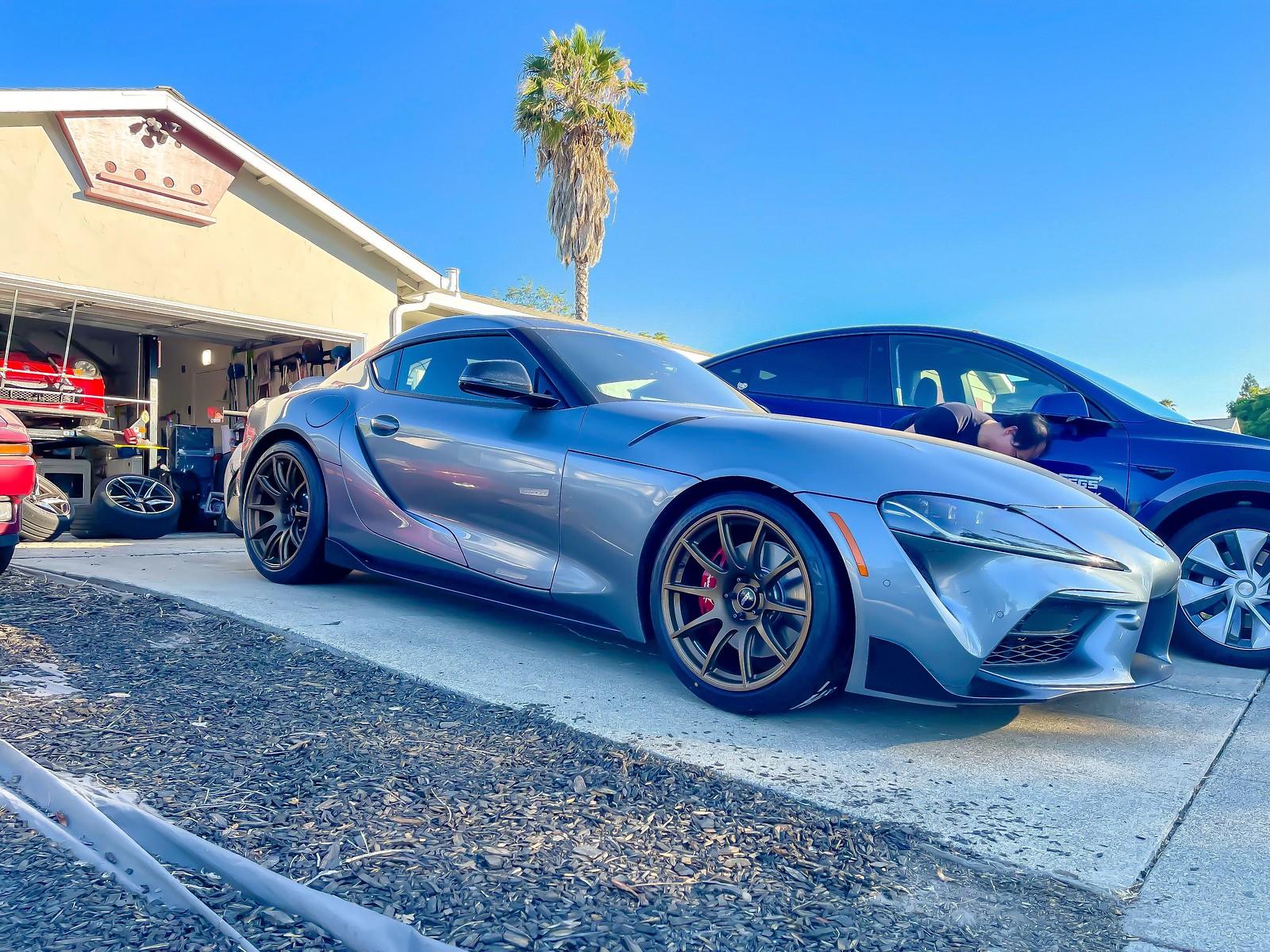

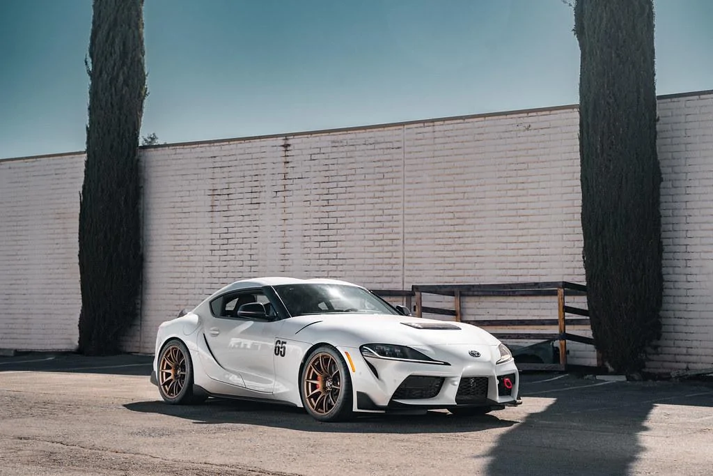

Another image of The Racers Line Supra on 19" SM-10s.
APEX SM-10 in Satin Bronze
F: 19x9.5” ET25 - 275/30-19 Michelin Pilot Sport 4S
R. 19x11” ET40 - 305/30-19 Michelin Pilot Sport 4S
Megan Racing Coilovers

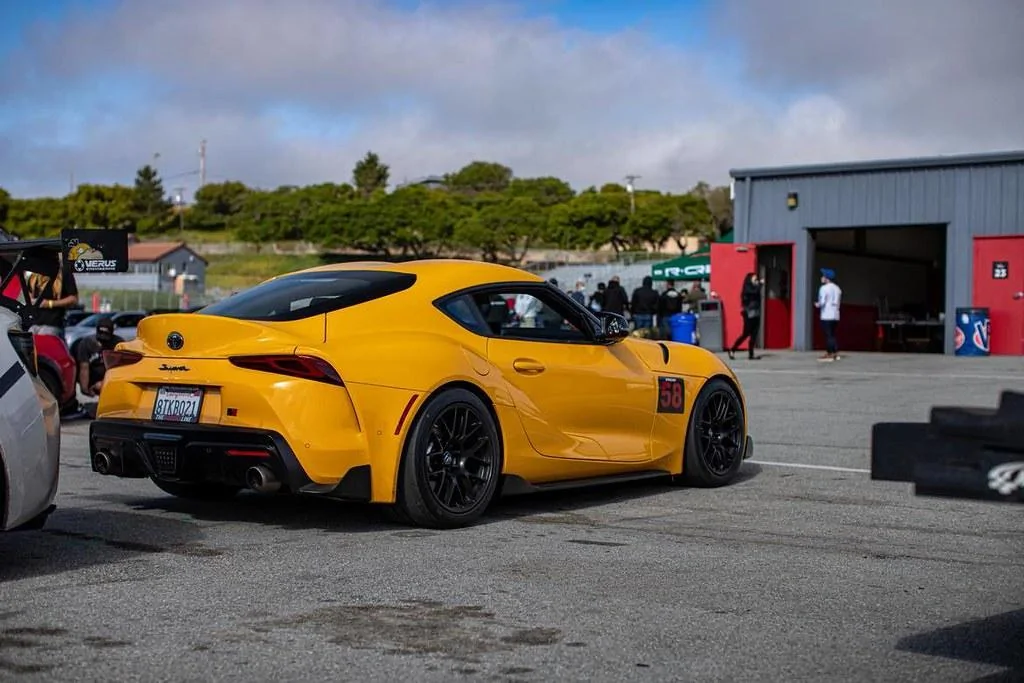

Our 18x10.5 ET38 Forged EC-7Rs wheels are the perfect width to support wider 295/30-18 or 295/35-18 tires front and rear and were specifically designed to be run as a square fitment. The higher offset allows for more ideal rear fitment with wider tires and is well suited to cars running aftermarket coilovers with improved inner clearance up front or spacers with the OE suspension alongside additional negative camber. The wider EC-7Rs are also ideal for 275 section R compound and slick tires that run wide if autocross becomes more serious:
275/35-18 Hoosier R7s on our 18x10.5 ET38 EC-7Rs.​

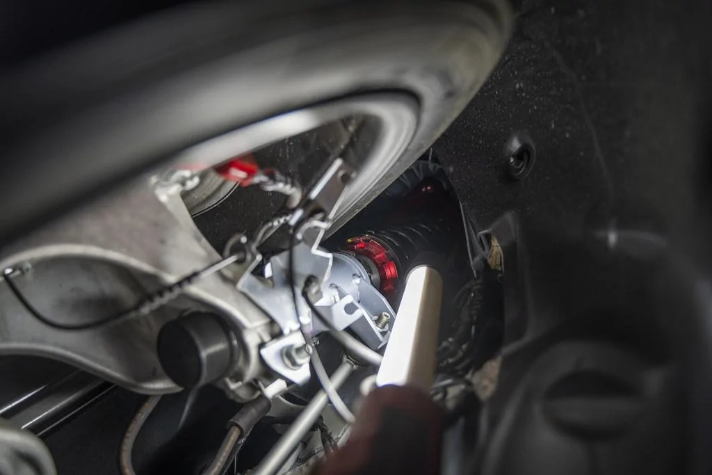

Lastly, if you are looking to maximize tire width overall, and fully support the sidewalls of those wide tires, I would recommend our 18x11 ET40 SM-10 wheels front and rear. This is our most aggressive square fitment and is ideal for supporting 295 section and wider 305 and 315 tires. These wide wheels require coilovers with better clearance than the OE suspension specifically for the clearance around the front shocks and struts:
SM-10 18x11" ET40 with 295/35-18 Yokohama A052 with Megan Coilovers​
Significant negative camber is required up front for fender clearance and recommended in general for aggressive setups to improve cornering grip and reduce excessive tire wear when on track. This fitment is quite aggressive and likely overkill for your current needs, but you could potentially choose to run our staggered fitment with the 18x10 ET30s in the front and the 18x11 ET40s in the rear for a while before upgrading to coilovers and the square 18x11 ET40s at the same time. This would allow you to purchase 2 18x11 ET40s in the future instead of 4 right now with an immediate suspension upgrade.

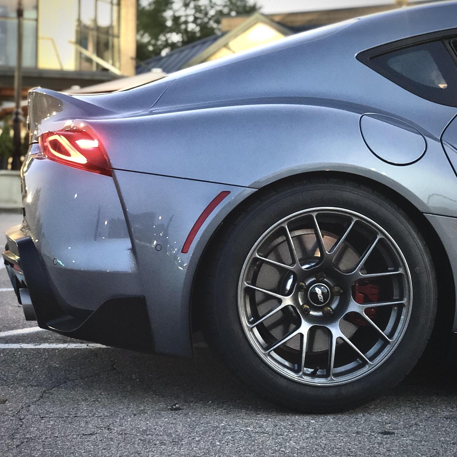

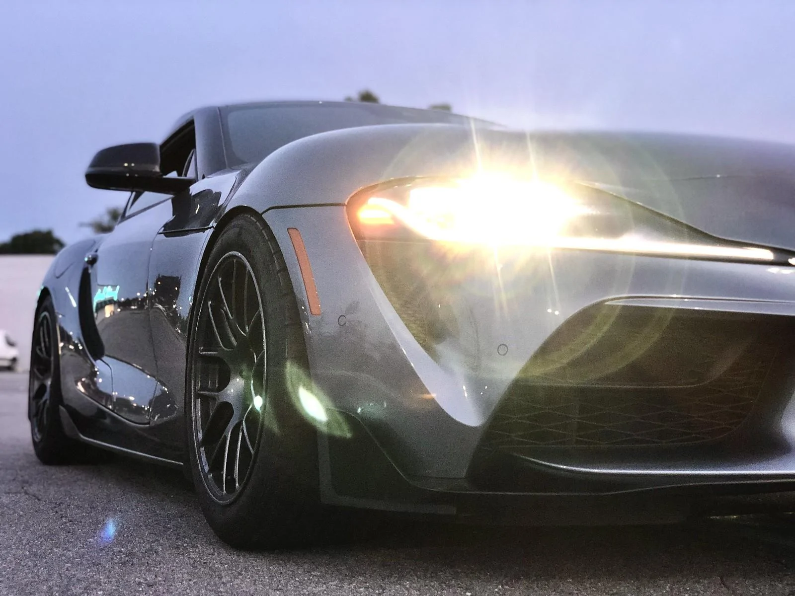

Our customer Tim sent in these shots of his Supra on our Forged EC-7Rs! Loving the look of this square setup on a mildly lowered car.
Wheels: Anthracite EC-7R
Front & Rear: 18x10.5 ET38
Tires: Yokohama AO52s
Front & Rear: 275/40-18
Additional modifications:
Swift lowering springs
12mm front spacers
Owner's IG: @timkainu

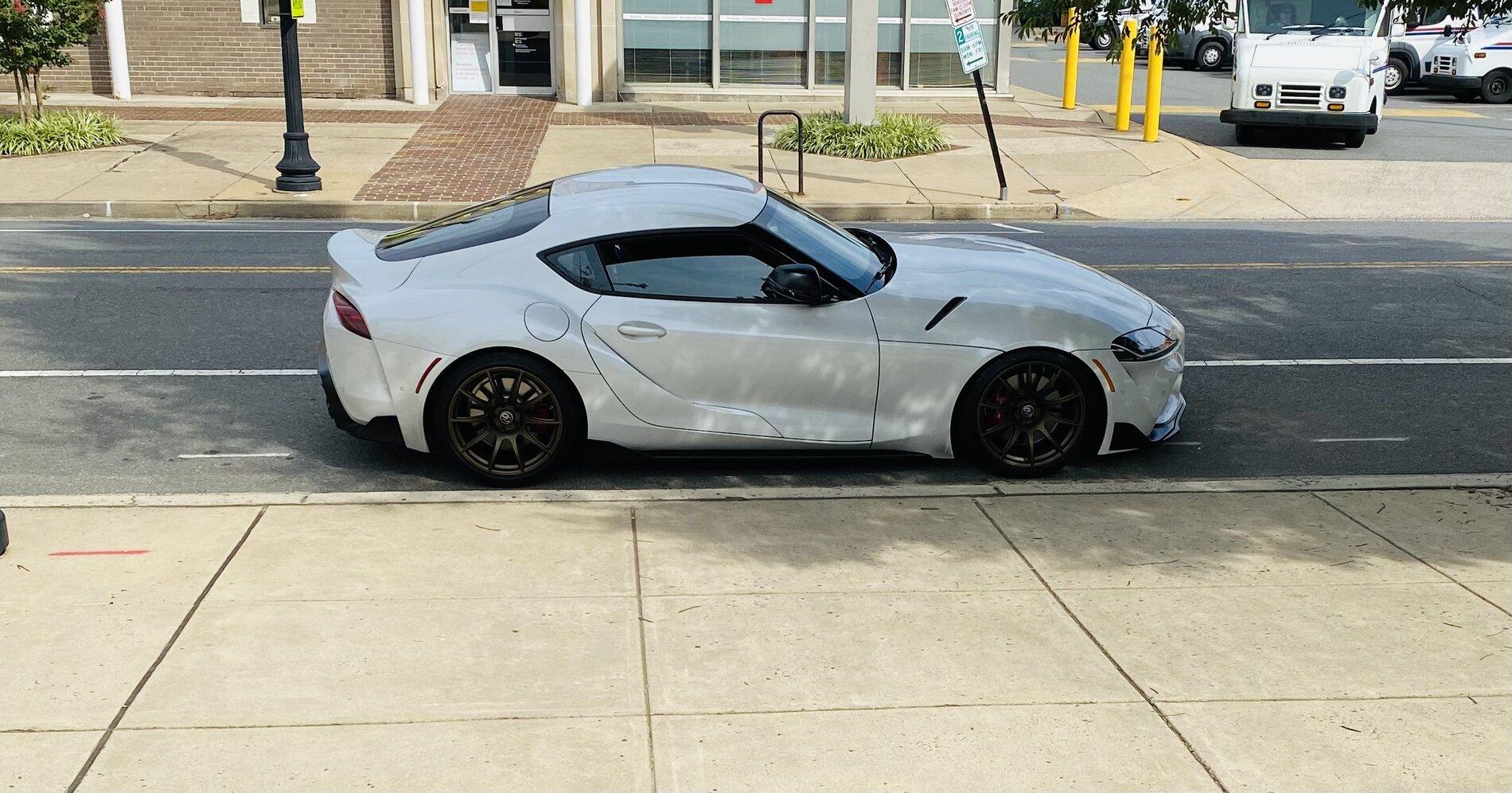

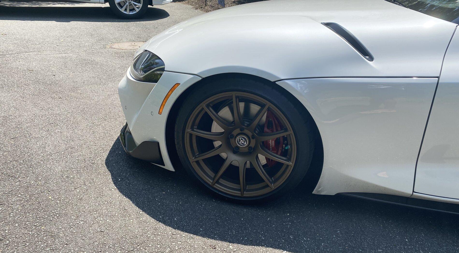

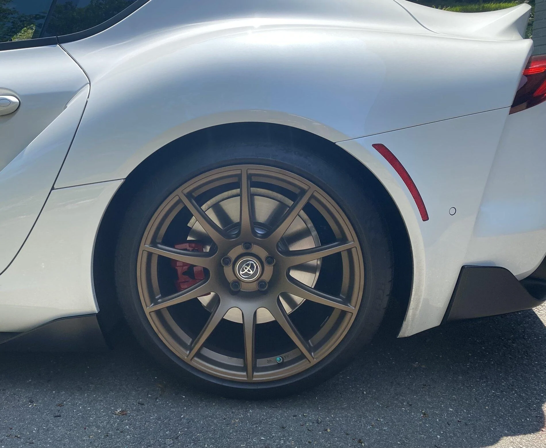

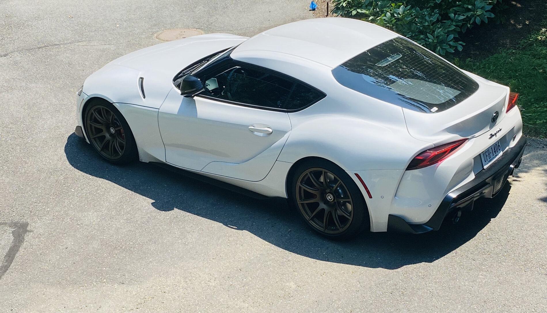

Some pictures of the SM-10 in Satin Bronze, 19x8.5/11. This is lowered on H&R springs, using stock tires, which I think fit nicely.

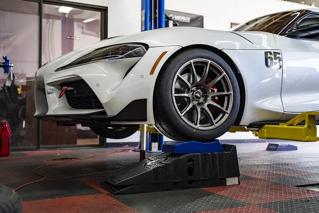

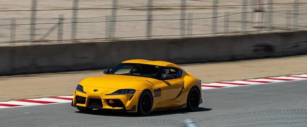

It's time to go wide! Our customer Jimy sent in this shot of his A90 on our 19x11 ET40s front and rear. You can see our Market Research Manager's red MR-S in the background getting aligned for its next track day. We should have more shots of this car on track shortly.
Wheels: Satin Bronze SM-10s
Front & Rear: 19x11 ET40 (suspension mods required)
Tires: Falken Azenis RT660
Front & Rear: 275/35-19
Additional Modifications:
HKS sleeve kit
Verus brake ducting kit (slight rubbing with 11" front wheels)
Custom camber bushing for LCA
Vorshlag Camber Plates
Alignment:
Front camber currently -3.3°
Owner IG: @jimyssi

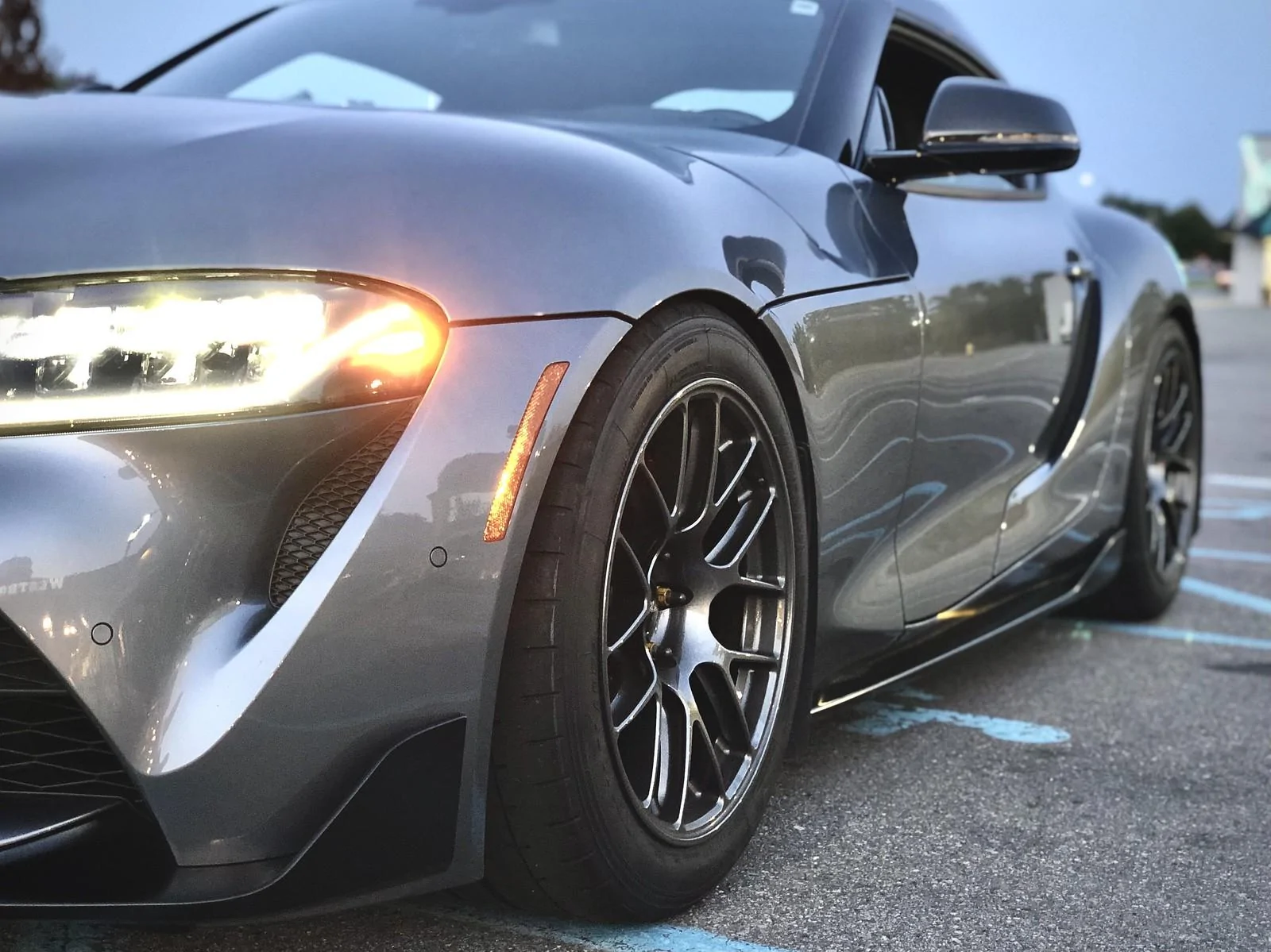

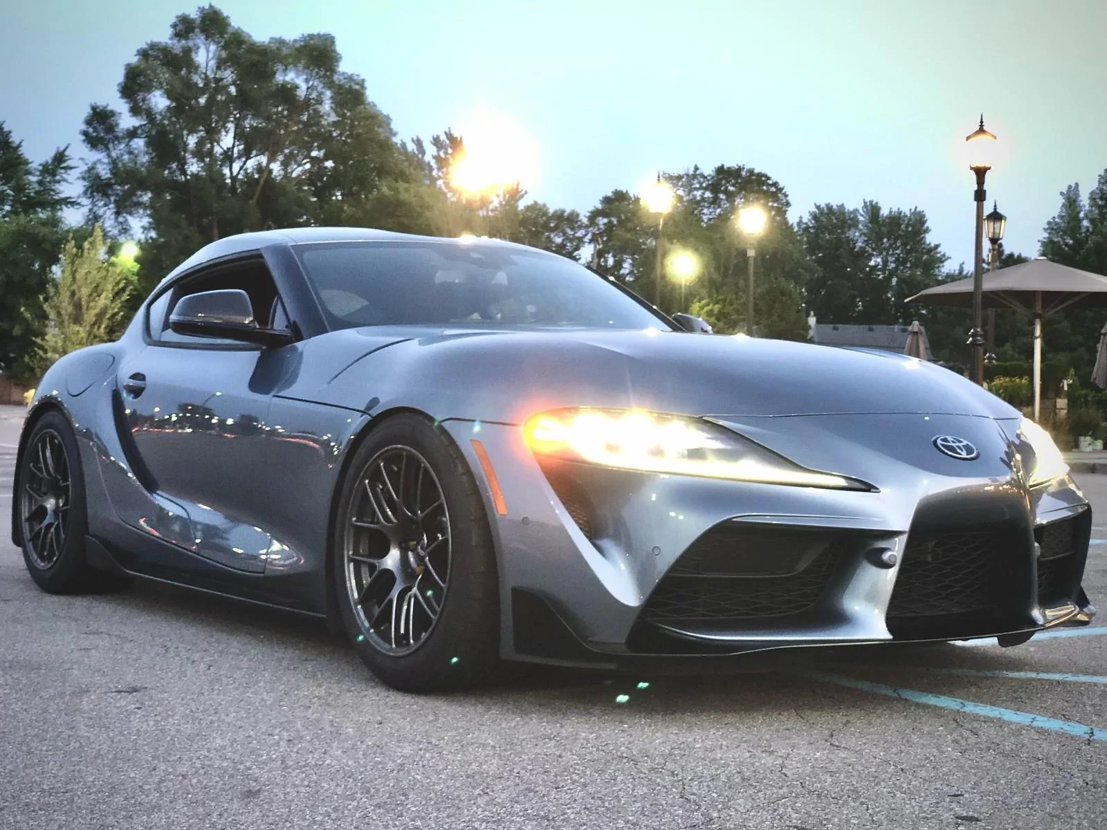

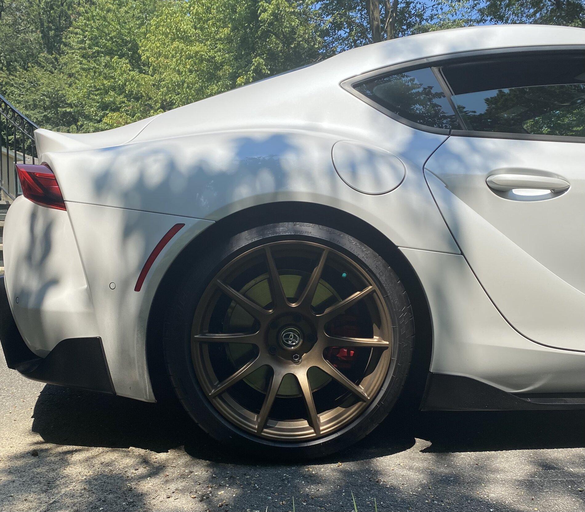

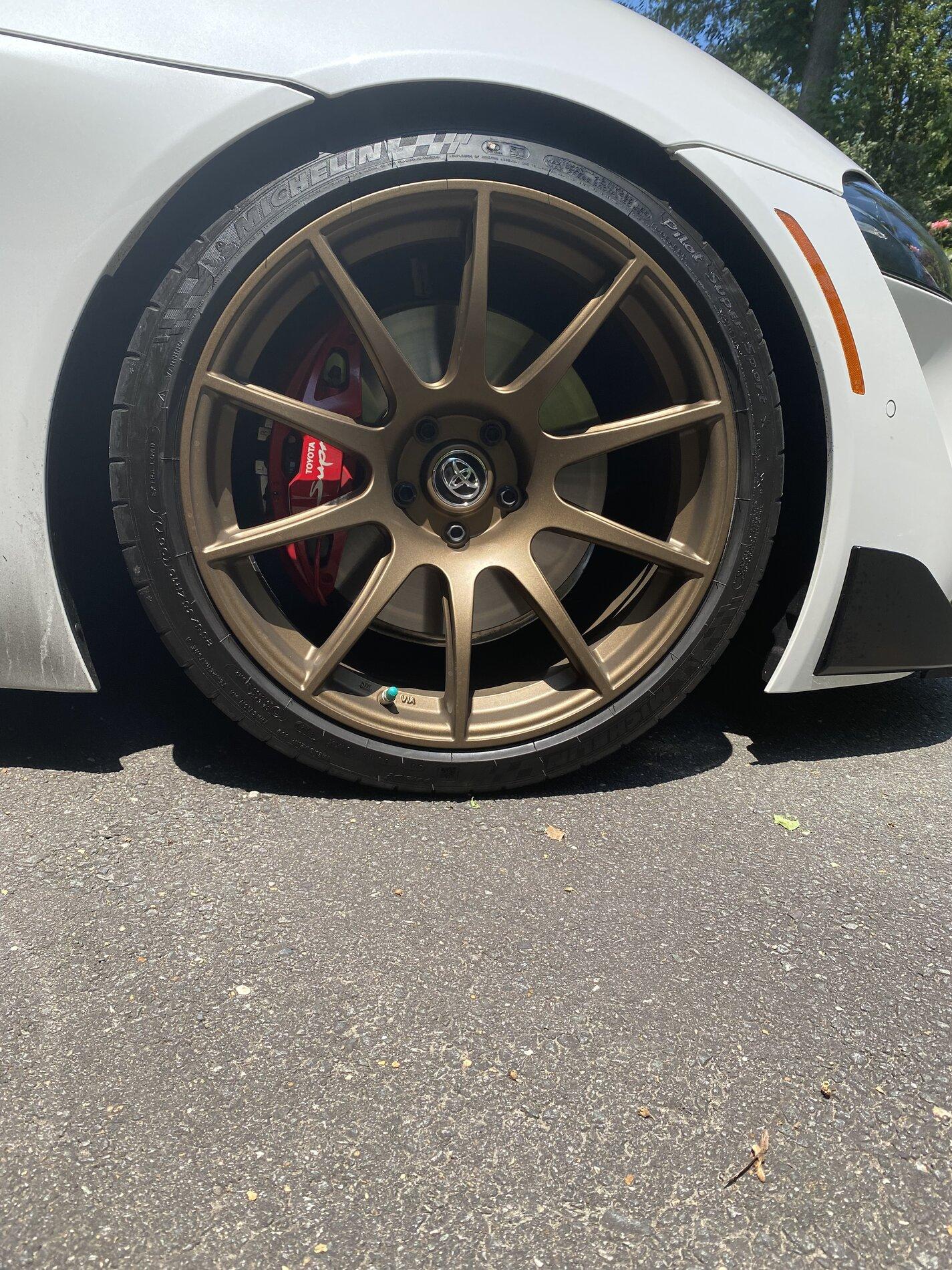

Order placed on 8/16. Mounted and Balanced. Shipped 8/18. Received 8/24 in NJ which is 2,800 miles away. Putting them on the car this Friday 8/27. Stay tuned. Thank you @APEXRaceParts !
APEX SM-10 in Anthracite
19X9.5" ET25
19X11" ET40
265/35-19
305/30-19
