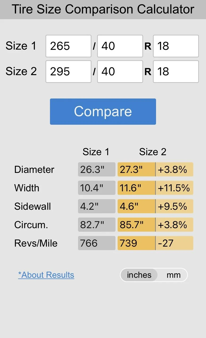

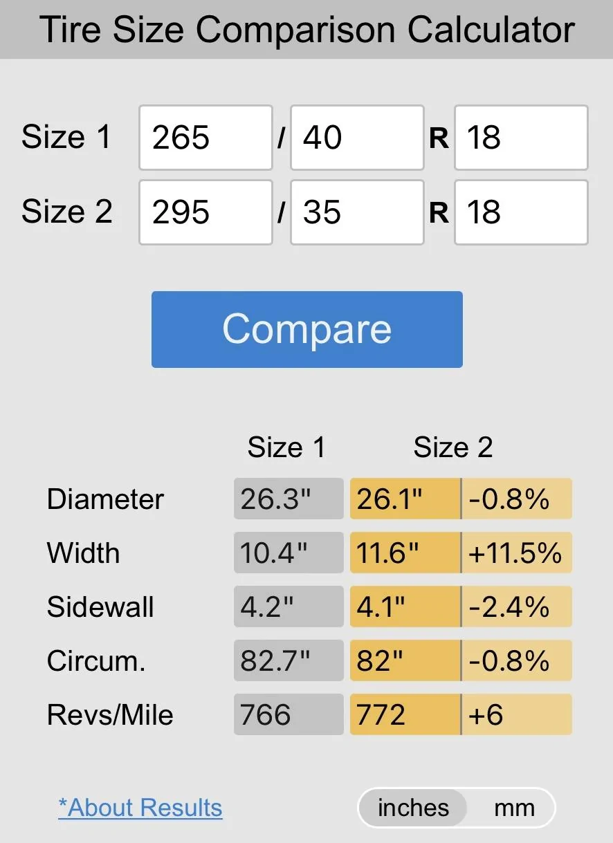

The reason I went 40 aspect ratio front and 35 aspect ratio rear is to minimize size differences between front and rear.
Here is the comparison of both setups using a tire size calculator:
Currently lowered on H&R springs with a TRD style front lip and have not scraped once. šŸ¤™
