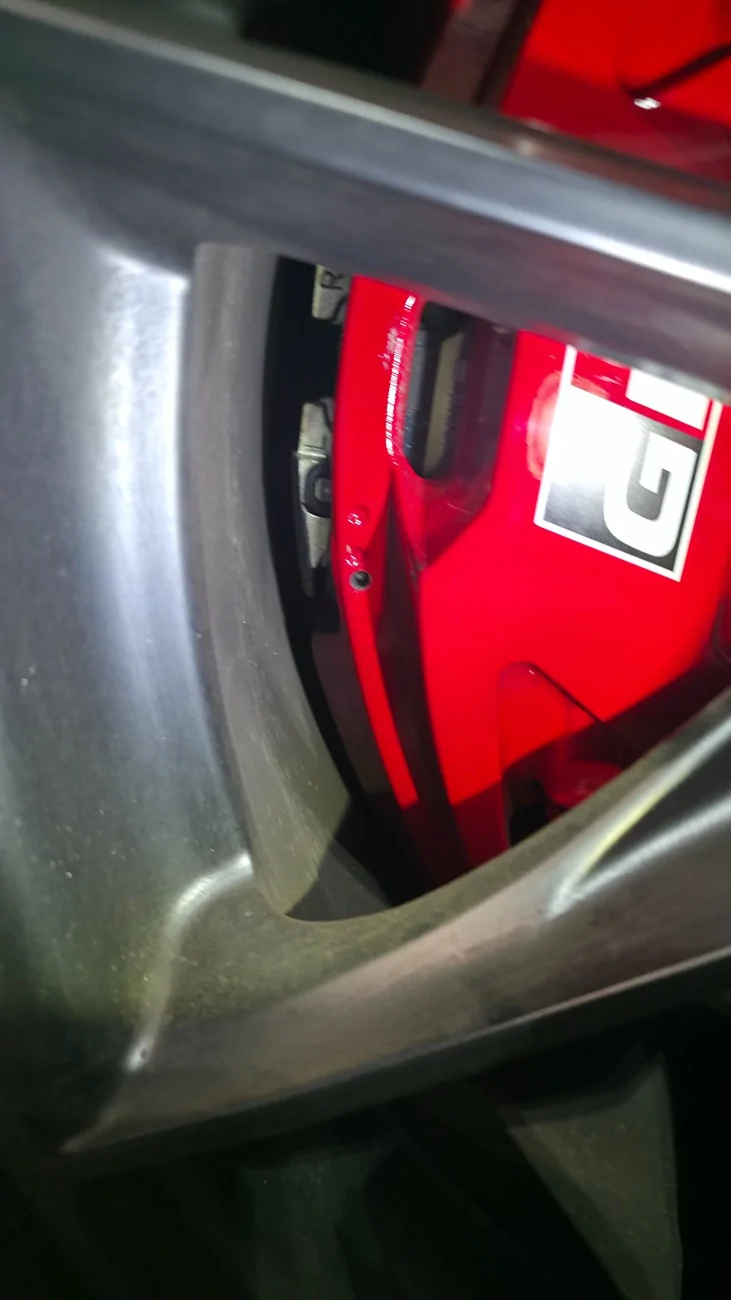

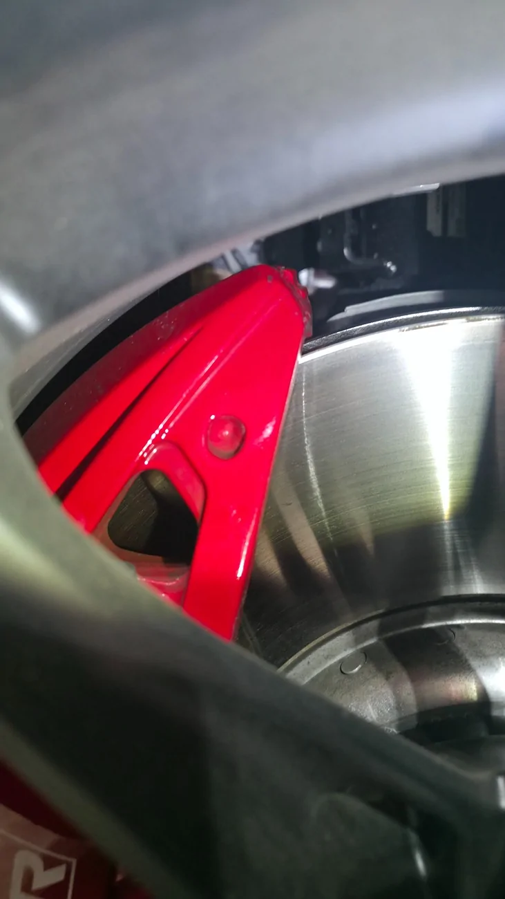

Has anyone looked at fitting 18" wheels on the final editions with the bigger brakes (374mm rotors)? Googling says 18's do fit on the M lite cars but from a quick look at my current factory wheel clearance has the barrel about 3/8" away from the calipers. Is the barrel on an 18" a full half inch smaller or does the barrel stay relatively the same diameter and its just the outer edge that is a different size?
A couple pics of the gap for clicks

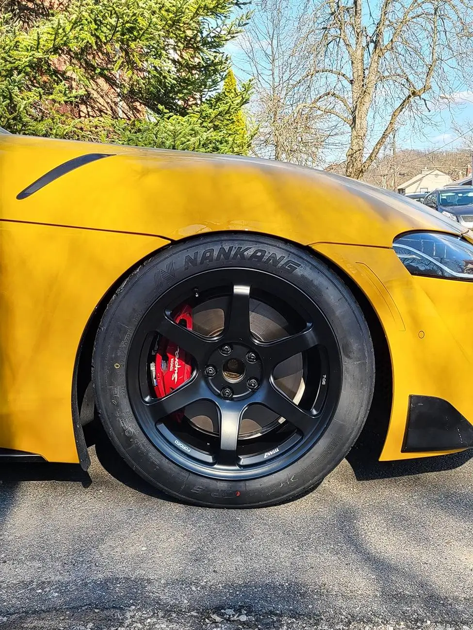

Depends on the wheel, as not all 18" wheels have the same clearance. For example (if I remember right) 18" RPF-1's do not fit over the stock non-FE calipers, but there's quite a few other 18" wheels that users here run for track days that do fit. The difference from one wheel to another can be pretty significant.

Yes it looks like its going to be very wheel specific. I was just looking at pictures and this is rwense's and there's not a ton of room with the smaller brakes, probably not enough for the bigger one's

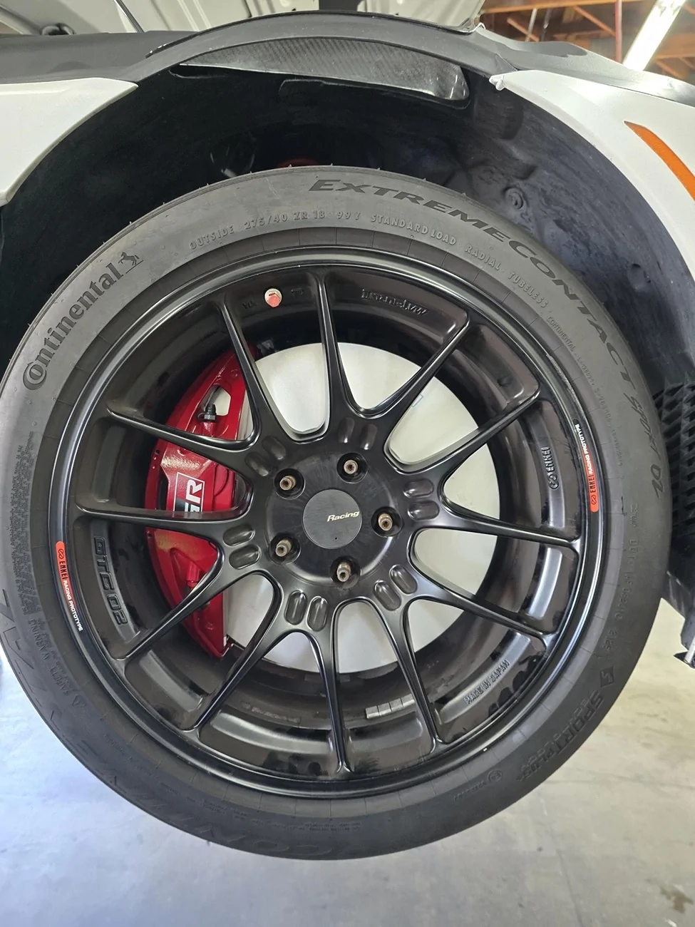

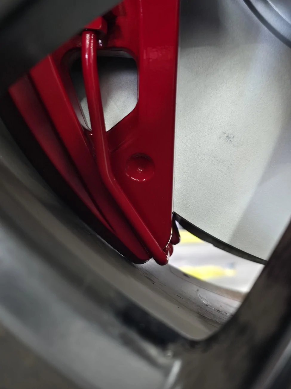

2025 BMW Z4 M40 6spd
Enkei GTC02’s do not fit :(
Close enough. They will "self clearance". I bet you could lose some caliper there and still keep the fluid inside.
I'm kidding of course. Well I think everything I said is true but I definitely wouldn't run that combo.
