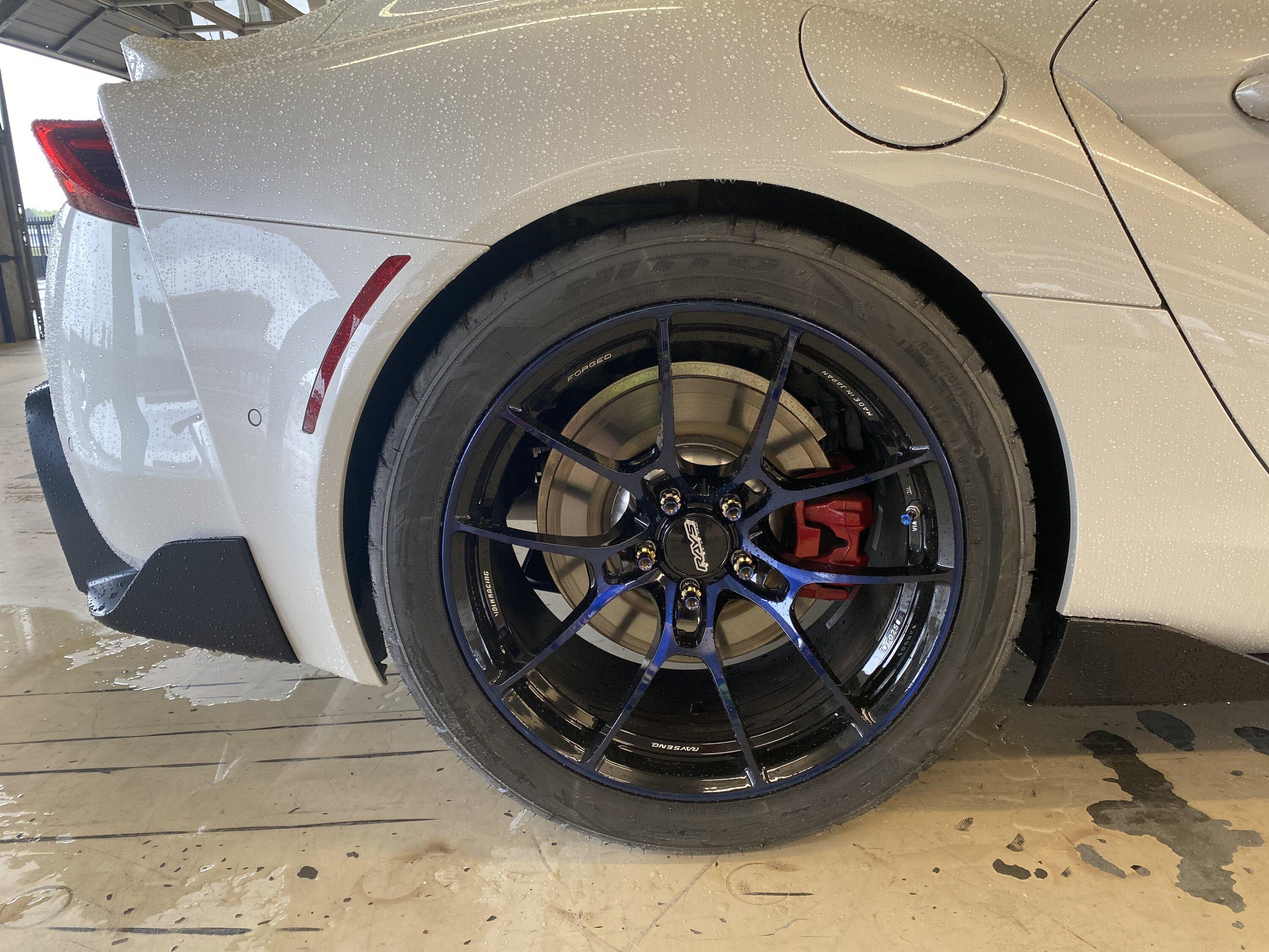

Hi guys,
Just wanted to know if i would have any issues running 295/35/19 in the rear on stock suspension with a 19x11 ET40 wheel.
I was reading Apex fitment guide and on there they have 305/30/19.
The 295/35/19 were for the stock wheels and would like to not have to buy 2 more as they are still quite new.
And if it is an issue would an 19x11 ET35 or ET30 solve the problem?
TIA

I run 295/35/19 but my wheel off set is different. 19x11.0+35 is my rear wheels. I didn't have issues on stock suspension.

Same over here currently running 295/30/19, and you would have no problem running 305's as well. On stock suspension, and stock rims. Seen a few people run 305/30/19 with no problem on stock rims.

Thanks for that.
I may look for +35s instead

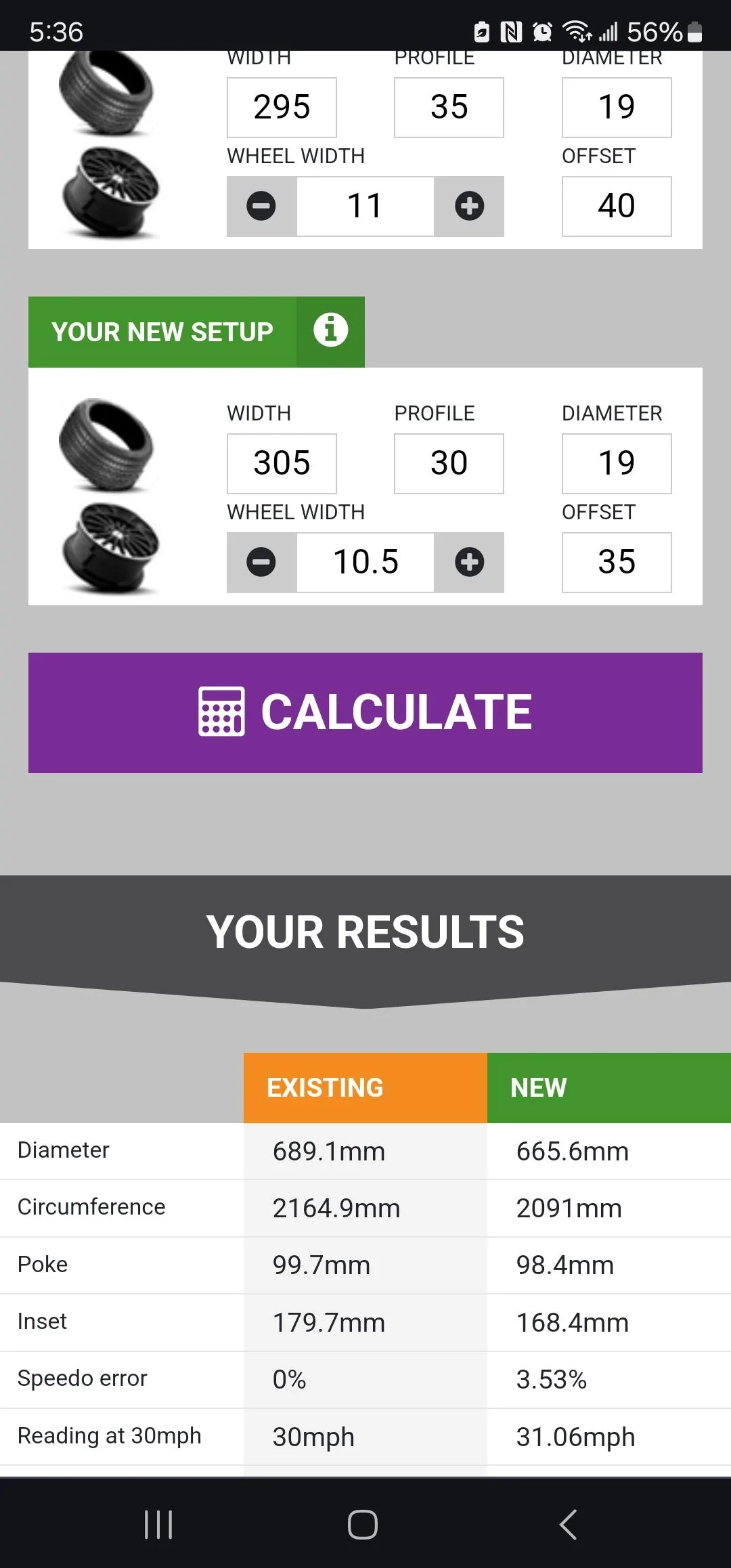

I run 305/30-19 on A90 spec TE37SL that are 10.5 ET35 lowered on Ohlins and have plenty of room
11 ET40 with a 295/35-19 is almost the same poke

What site did you use for calculations?
