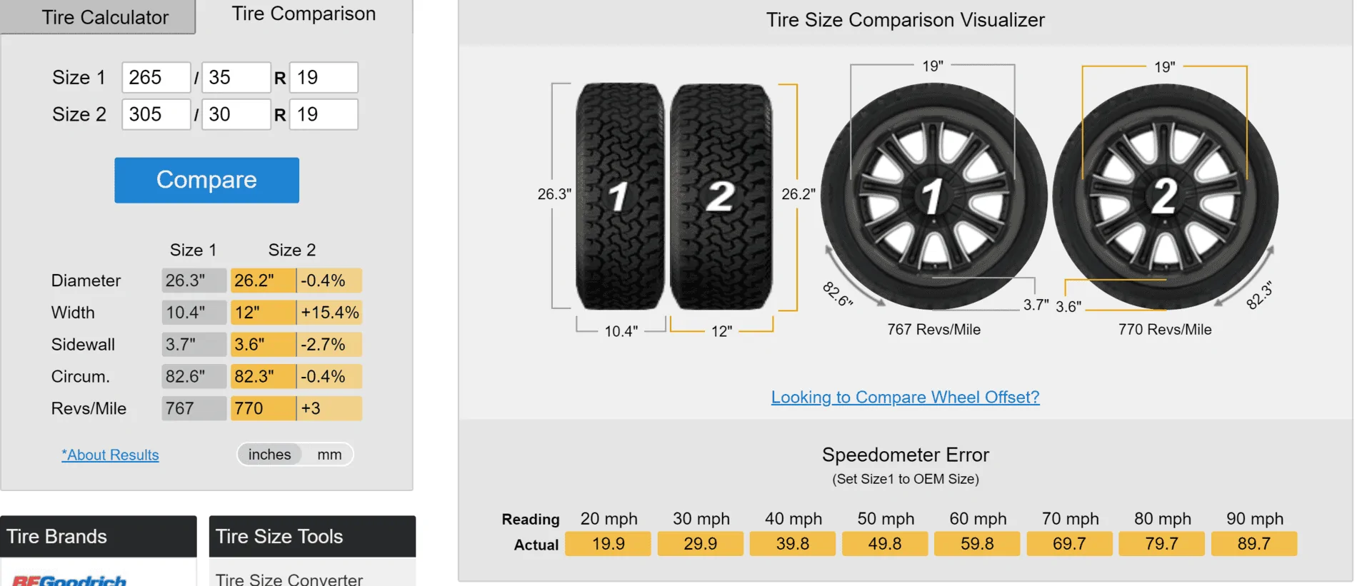

Now I'm looking at R888R's 265/35R19 up front and 305/30R19 in the rear after talking to someone at a tire shop. That's a closer diameter match front to rear than doing 265/30R19 up front evidently. I'm getting closer I think!
Hey,
We'd be glad to help you with tire sizes as well as Adam. We reference from Titan7 as well so our responses would be the same as theirs. Thats a similar tire setup I was running on my prior vehicle (non A90 Supra). The taller tire in the front and lower in the back for looks and speed ratio. However, I found that the tire sizing that Titan recommends is usually pretty spot on.
If you need pricing on those Toyos let us know and we will get you a quote as well. Feel free to text Adam at any time!
-Josh

Looks pretty spot on to me front to back. Just .1" more sidewall up front but much wider in the rear. :)

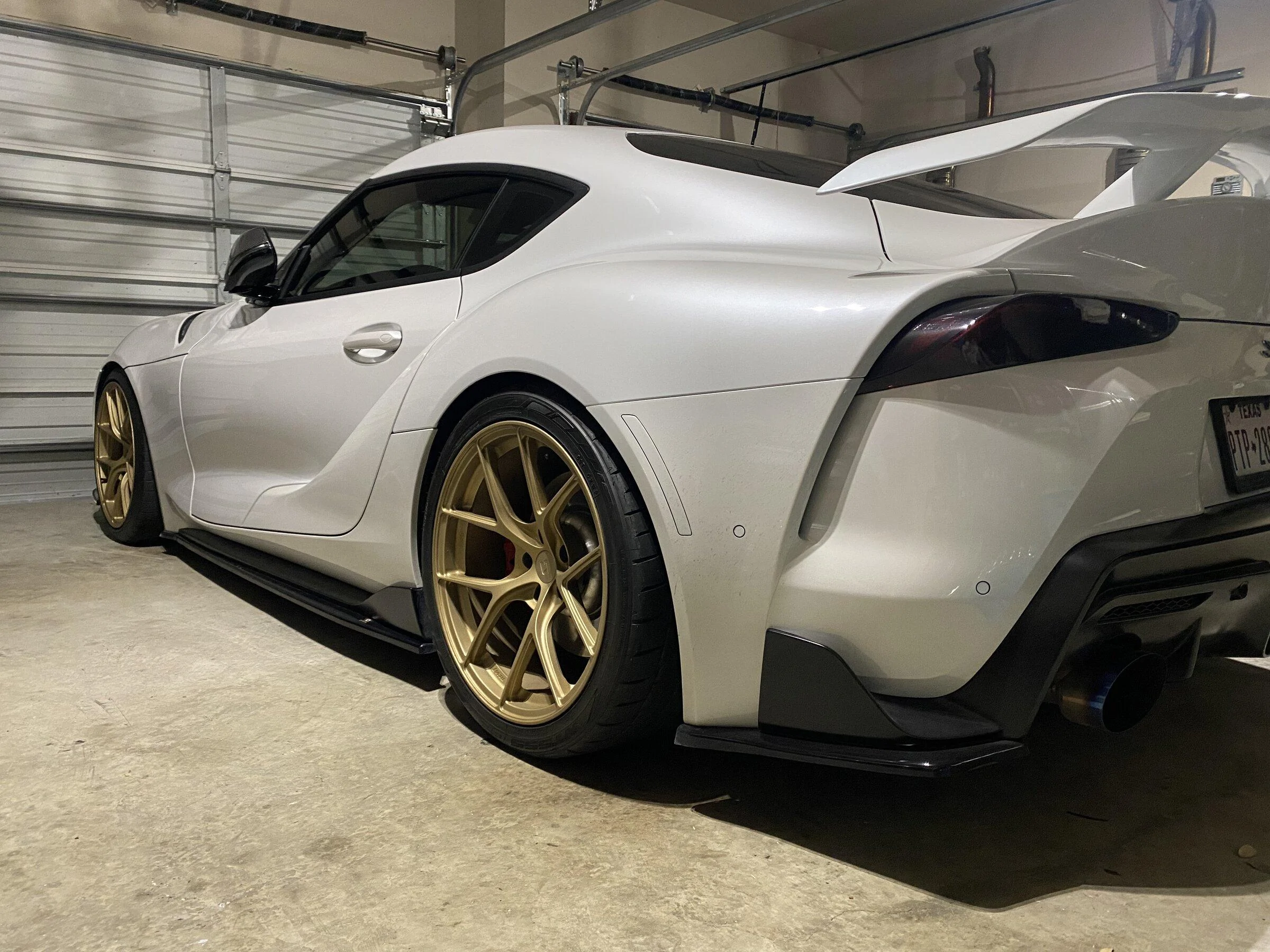

Just to add another data point, I have the 19" Titan7's and run 305/30R19 Falken RT660's in the rear with Swift lowering springs and I do not rub. The RT660's run wide to boot.
19x11?

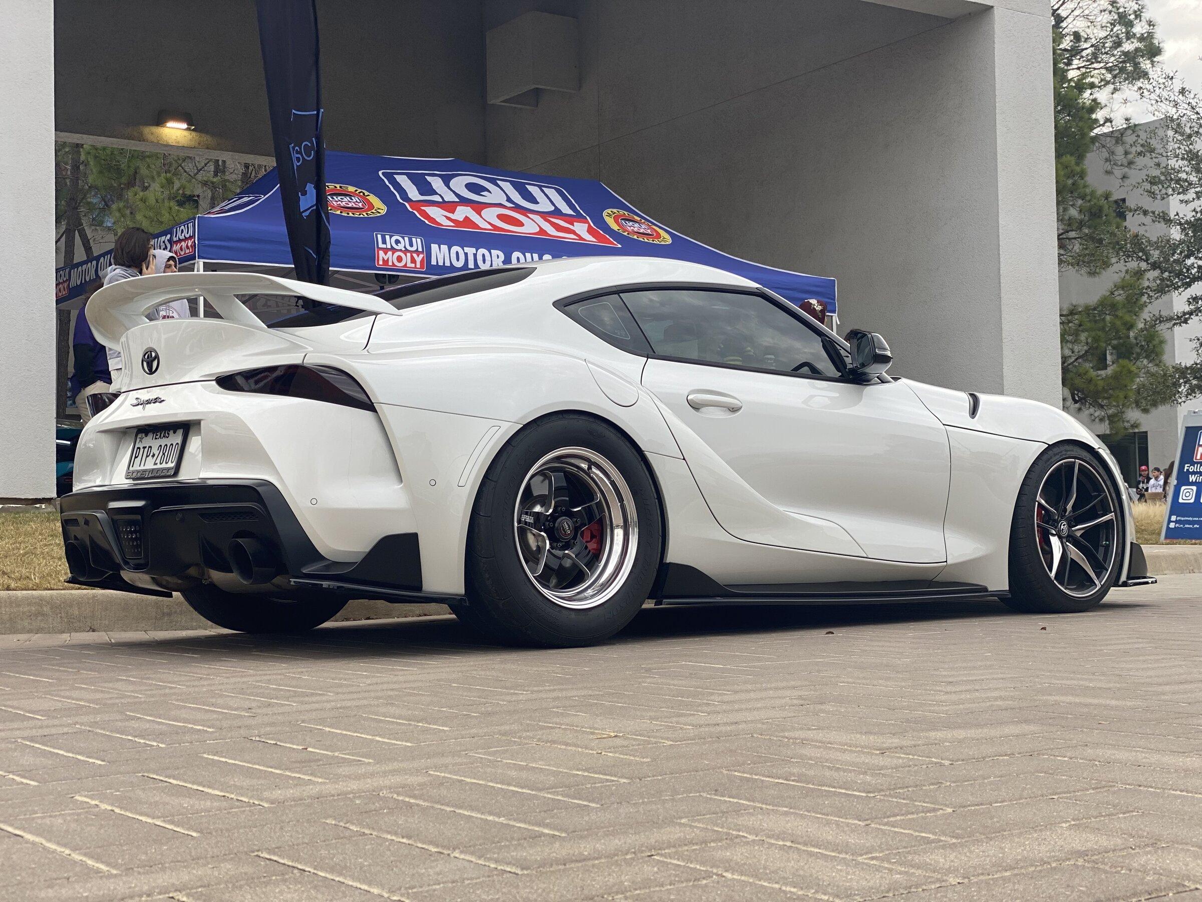

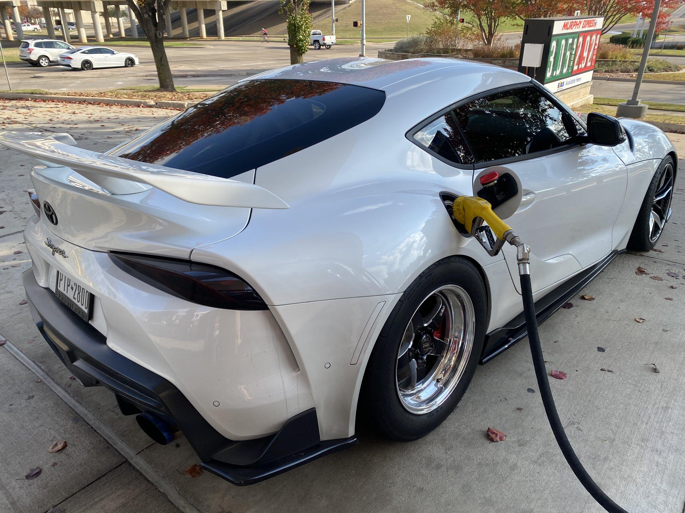

Anyone running the TITAN-7 TS-5 19's? Thoughts on the wheels? Any pics of a white supra with the titanium wheels?
I want a second set of wheels to mount drag radials on. I do not drive the car in the winter or in the rain and would put on my LE wheels if I go on a road trip for some reason. If I get caught in the rain I'd prefer to be able to feather the throttle and get home safely. :)
I like how the rears are 19x11 which should allow for a fairly wide tire. Anyone know what the sweet size for the rear would be with those rims?
That brings me to the topic of tires. Any suggestions? Assuming I'll go some type of drag radial on the rear what should I put on the front?
Thanks everyone!

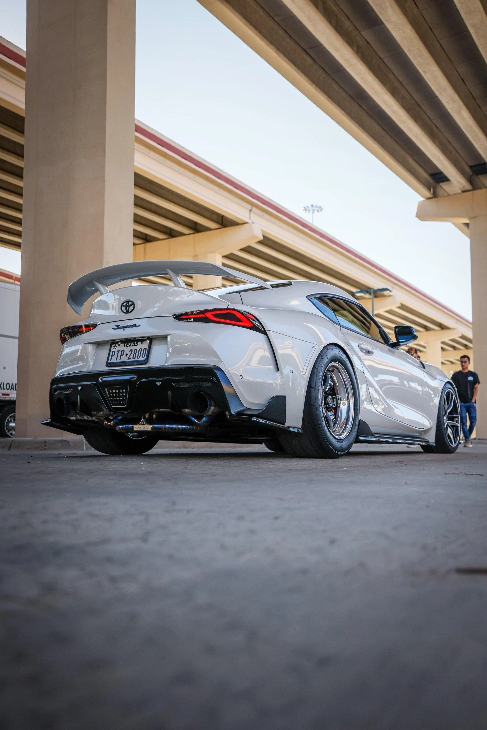

Here you go 305/30 on the rear lowered on Eibachs. No rub issues.
