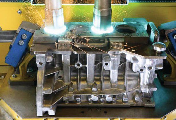

I wasn't talking about cost of the block, I was saying that the fact that the Nissan Z has an aluminum block vs the BMW iron block doesn't mean anything. Actually, it does....if you ask any reputable tuner shop, they will tell you the BMW cast iron blocks are more susceptible to flexing and cylinder warping than an well engineered aluminum block. My point about the R35 GTR is that it has the same basic architecture in it's VR38 motor to a VQ37 in a Z....and the GTR and Z have absolutely no problems handling high boost. Can't say the same about the BMW iron blocks....remember the MKV will NOT have a JZ series engine. There is a difference between a Toyota straight six, and BMW straight six:
The N54/55 uses cast iron cylinder sleeve, but B58 is different: it uses one latest technology called “Electric Arc Wire Spraying”. This is a type of the ferrum plasma spray method, which creates a thin layer (0.3 mm thick) of iron on the cylinder wall surface and thus eliminates the need for using the cylinder sleeves. The ultimate goal is to save weight. For your reference: plasma spray is an exotic technique previously (for example GT-R, LFA etc.), however nowadays its cost is lowered so significantly that even Ford uses it in the EcoBoost engine family.
There are three main advantages (that I can think of) for a only cast iron block over an aluminum one:
Dimensional Stability: Aluminum grows more during the heating process than does iron. Extra precautions must therefore be built into aluminum blocks so as counteract this condition and prevent issues.
No Cylinder Liners: If you ever want to rebuild an aluminum block where the cylinder liners are toast, they must be replaced. This is a large machining expense in comparison to having to just bore the cylinders in a cast iron block.
Cost: Cast iron has been used in industry for many years and is fairly easy to produce. Aluminum, on the other hand, costs a lot more to refine from bauxite ore. Just in materials alone, the cost is greater. Then look at the cost for the cylinder liners and special casting processes which must be employed to get the aluminum block correct and the cost goes even higher. There is some trade-off, however, in the heating process (doesn't take as much energy to melt aluminum v. cast iron), and aluminum is easier to machine (less wear on the machine tooling/fixtures v. cast iron).

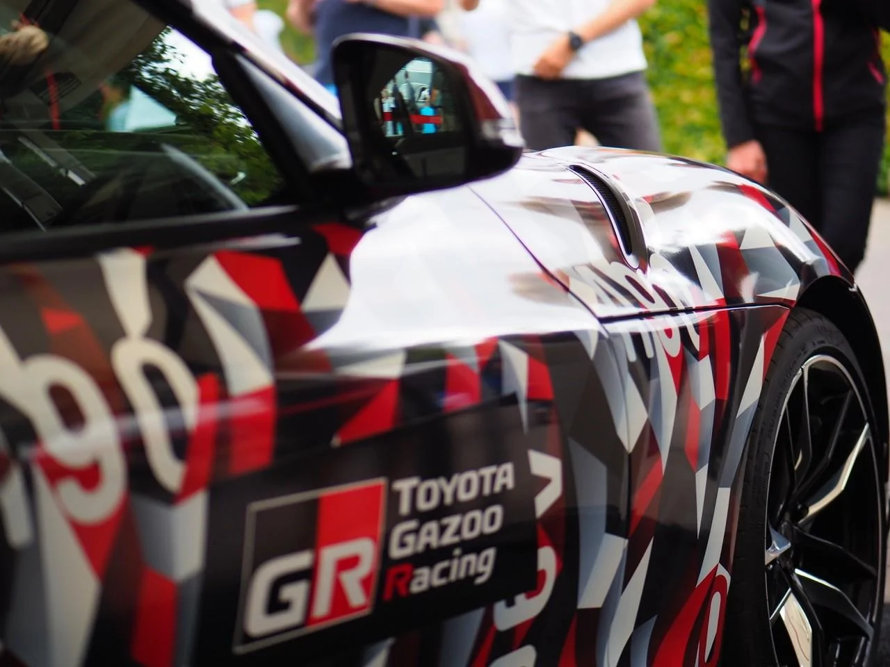

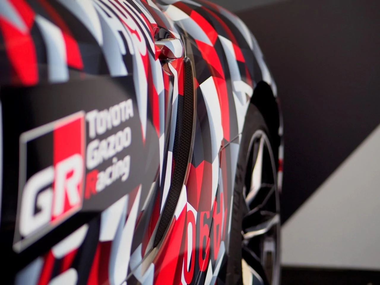

Can’t clearly see if the fender vent is functional or not but the other vents are all fake. :(
