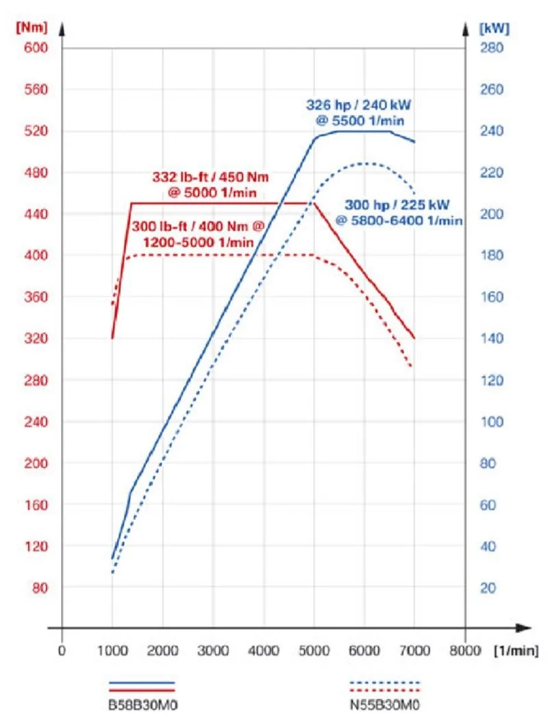

I wonder where the red starts? Clearly higher than 7000, and 7000 is where a standard B58 will redline....

I don't expect much over 7500, but at least being different than a 340i proves it's not a bog-standard B58... :dunno:
I say 7700.
Though, I think people wound be ecstatic if it is 8k like a old school vtec

8k, even 7700, would have to mean that the head was serious business. Of course, we were told that the head would be a hell of a breather before, but again nothing solid that would confirm that. :hmm:
True, but if we were to be realistic, a 7700 redline would be similar to the 86 redline being 7300 if I remember correctly.
I would just think a 8k redline would attract buyers and if properly geared can stay in the power band for much longer.

lol I don't think developing an engine and setting it's redline works like that..if only engineers could just pick and choose what rpm they want, then all sports cars would have a redline over 9000

Oh, no doubts. The Fa20 is not a B58. But I was wondering how far Toyota could push the car's engine

Almost anyone can put in strong enough valve springs to prevent valve float at high RPMs, but the real mission is creating a head design that can flow enough air to make actual power at that fast of an engine speed. Certainly no easy task, and would require a fair bit of modification of the standard B58 head.

Pushing a stock B58 over 7000rpms (stock redline) wouldn’t be any use. S55 does have a better head and turbos and redlines at 7600.
So either the updated B58TU has borrowed some tricks from the S-series, or Toyota did actually modify the head for the Supra. In either case, it points to a higher power target, otherwise you wouldn’t need the extra revs.
B58 vs N55
S55
