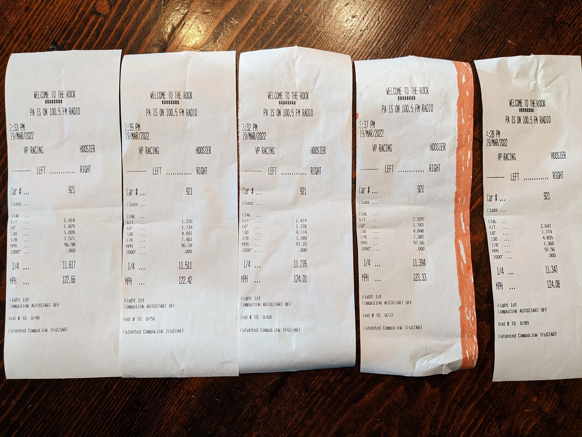

So do you think just the 2nd gear launch is what contributed to higher trap speeds in the last three runs?
No, seems to be related to heat soak. When I arrived I didn't let the car cool down at all. No one was running so I immediately went to tech and got in the lanes and hot-lapped. There were a few more degrees of ignition advance on the last 3 due to better AIT hence the MPH diff. Passes 2 and 3 were hot-lapped but AITs were back down by them time I got back to the staging lanes.
Thanks! I had no idea you could just toss in more etoh and the car would compensate. When you say lean, it’s because the factory fuel setup can’t keep up past around E40?
What’s the unit on the X axis of your graph, time? What’s the scale if it’s time?
Software limitation vs hardware (at this point). The DME trims are limited to +/- 25 (not sure if that is 25% or arbitrary) and once you max out the trims you'll get a lean code. With a proper tune you can extend that until you hit a physical limitation, hence being able to do E50.
No. While there are throttle closures at shift points, there are several more. They can be smoothed out a little bit, but these actually don't look all that bad. It never fully closes. JB4 will adapt a little bit over time.

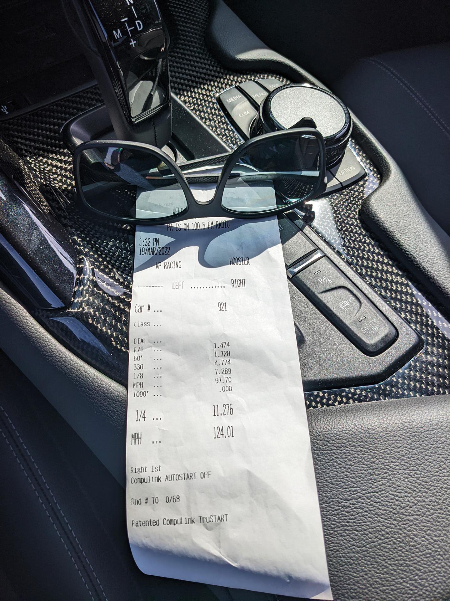

First time out with the car to get some baseline numbers and start figuring out the 60'. Conditions were not ideal ~2000' DA and a gnarly headwind/crosswind but the track was empty and hooking, so can't complain. Goal was 11.5 or better but mostly concerned with getting data and seat time.
2021 Supra
  • MST V2 intake
  • AMS catted dp
  • JB4
  • E30'ish
  • Titan drag pack - 305/45/17 MT ET S/S
  • full-weight, nothing removed
First two passes were 1st gear launch, 2nd gear afterwards. Lots of takeaways so looking for 11.0's with a few tweaks and ideally better DA next time out. Next up axles and ECUTEK (early, unencrypted 2021 :thumbsup: ), at least. I'm experiencing some pretty invasive and extremely annoying throttle closure and don't believe that can be solved with out a tune.
