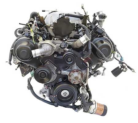

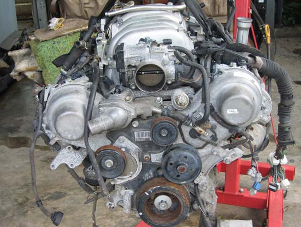

As true as that is, there are times where it happens that things end up being very similar mounting-wise. For example the 1UZ/2UZ/3UZ or the LSx.
1UZ/3UZ Aluminum Block:
2UZ Iron Block:
2UZ Iron Block:
Jeff
I'm very much hoping this is the case. Certainly would be a smart design as it would save a ton of money since they wouldn't have to redesign any of the accessory components.
