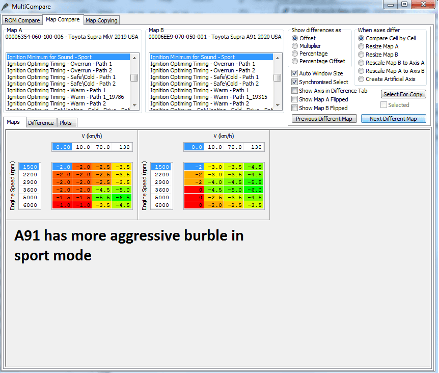

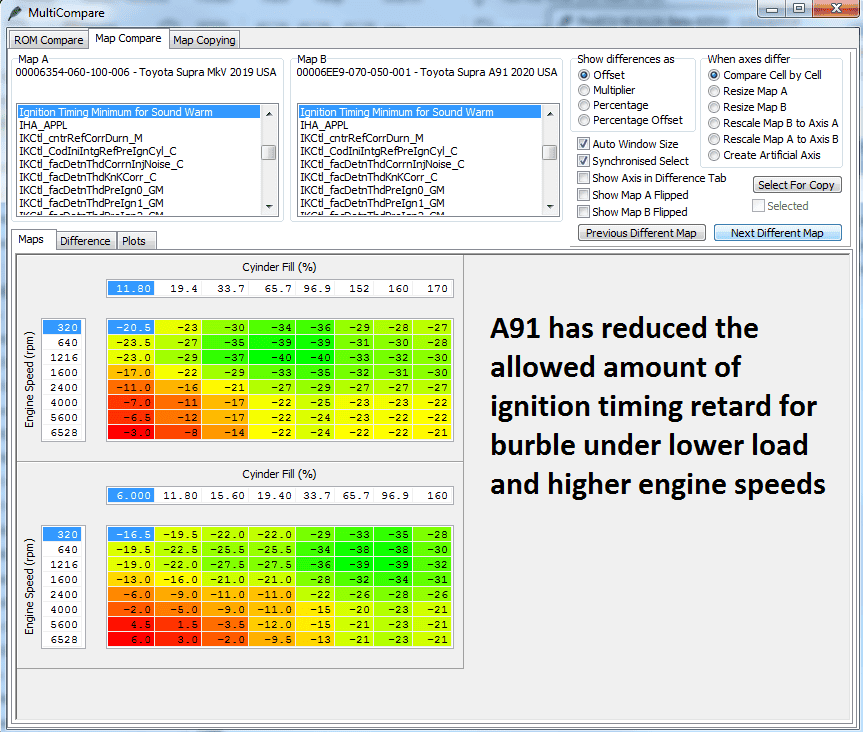

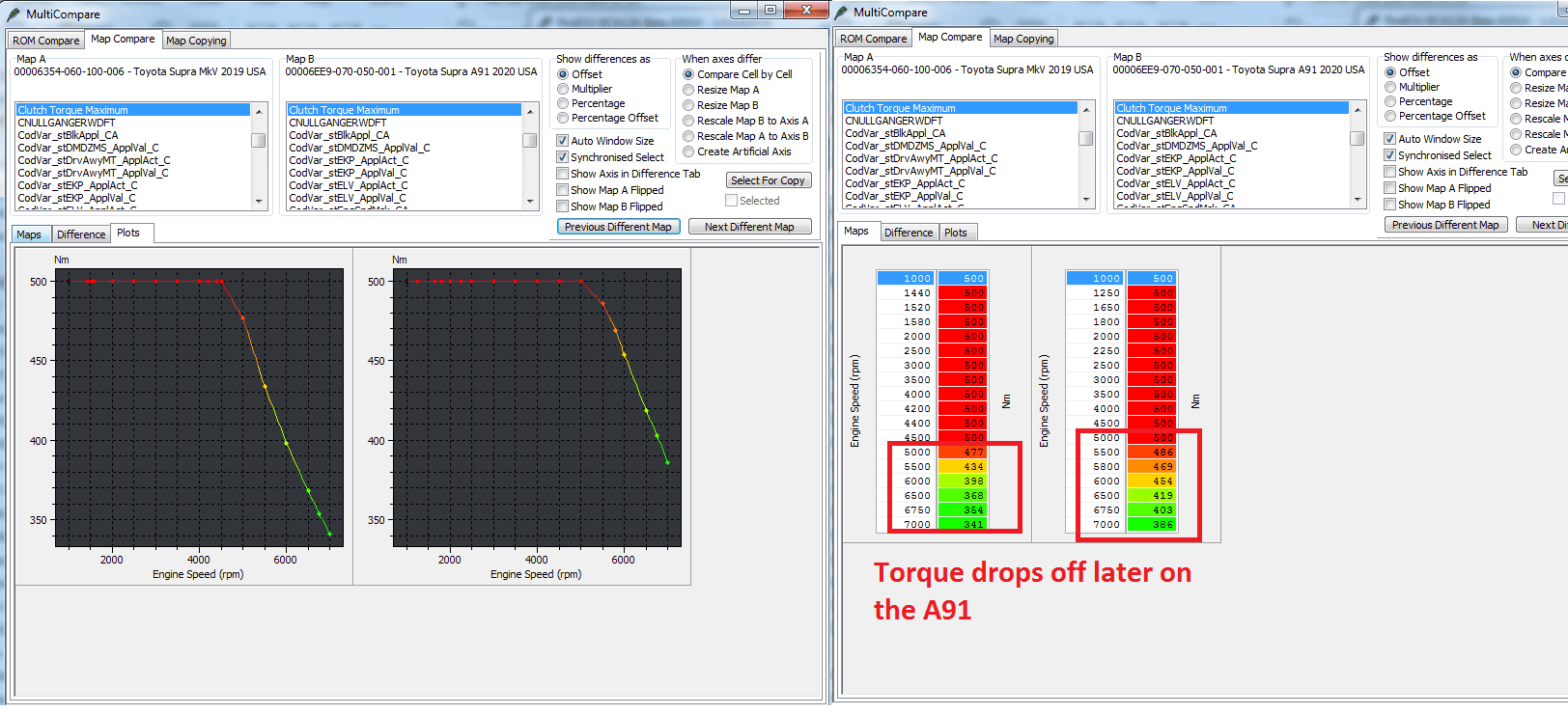

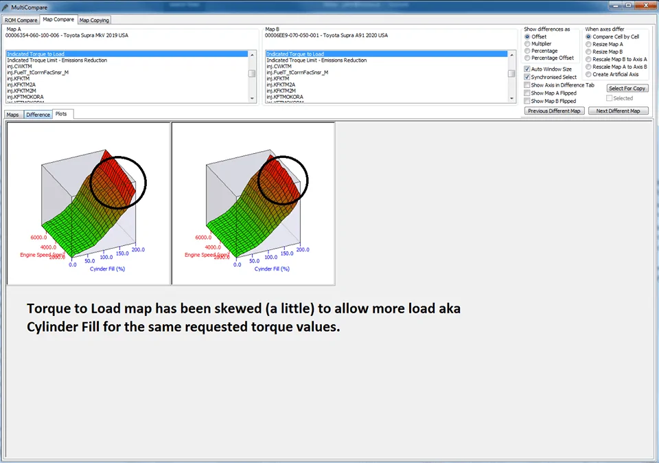

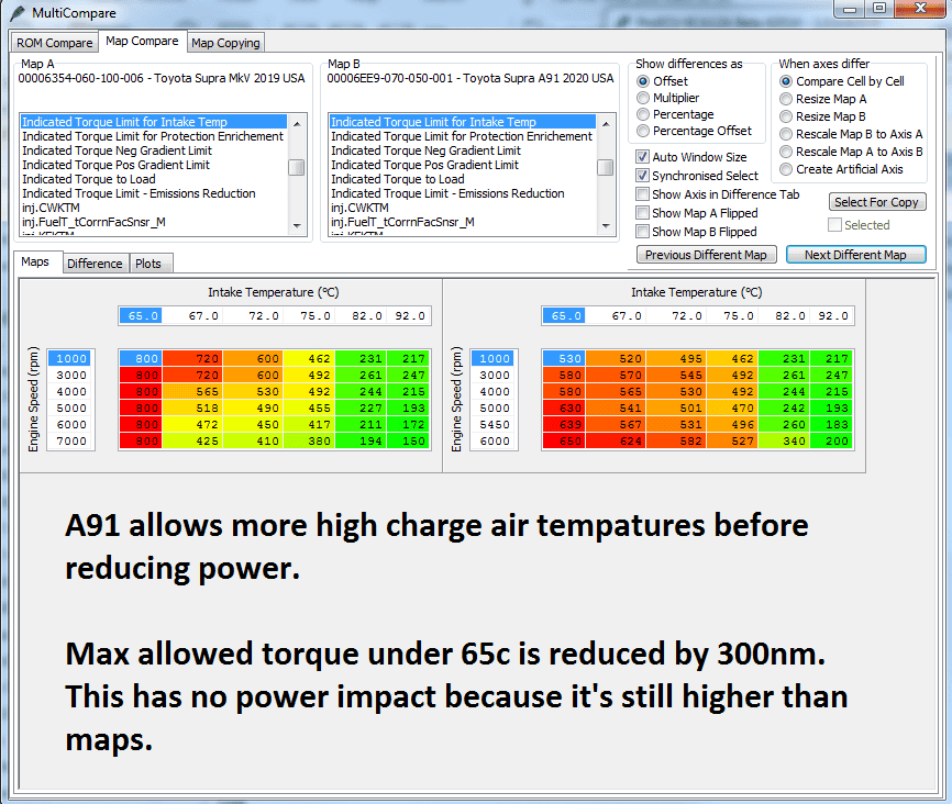

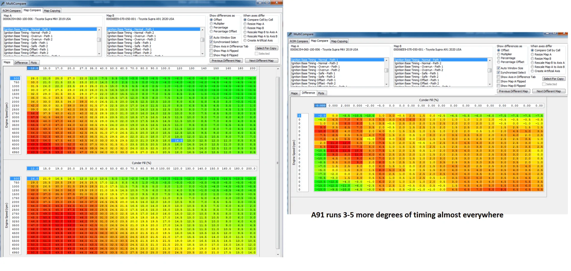

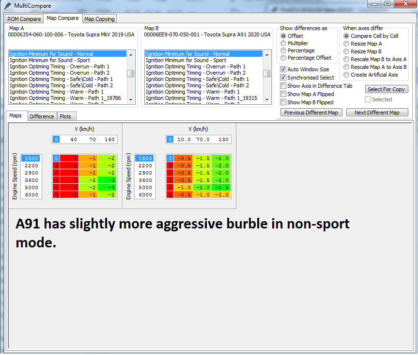

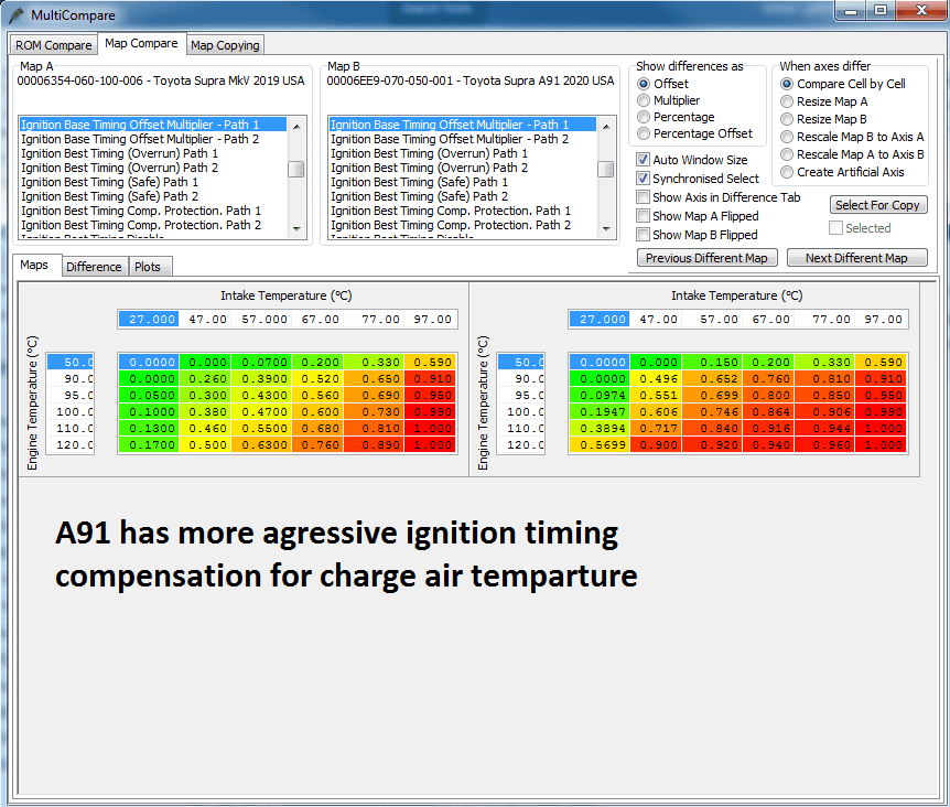

A first look at the A91 stock calibration.
MA617M
Aug 27, 2017
2,303
5,167
lots
This is the video I was referencing:
:dunno:
If you look at the maps, the A91 allows no IGN retard at 0km/h, where as the first 2019 model supras did allow some IGN retardation for that pop bang while free revving.
