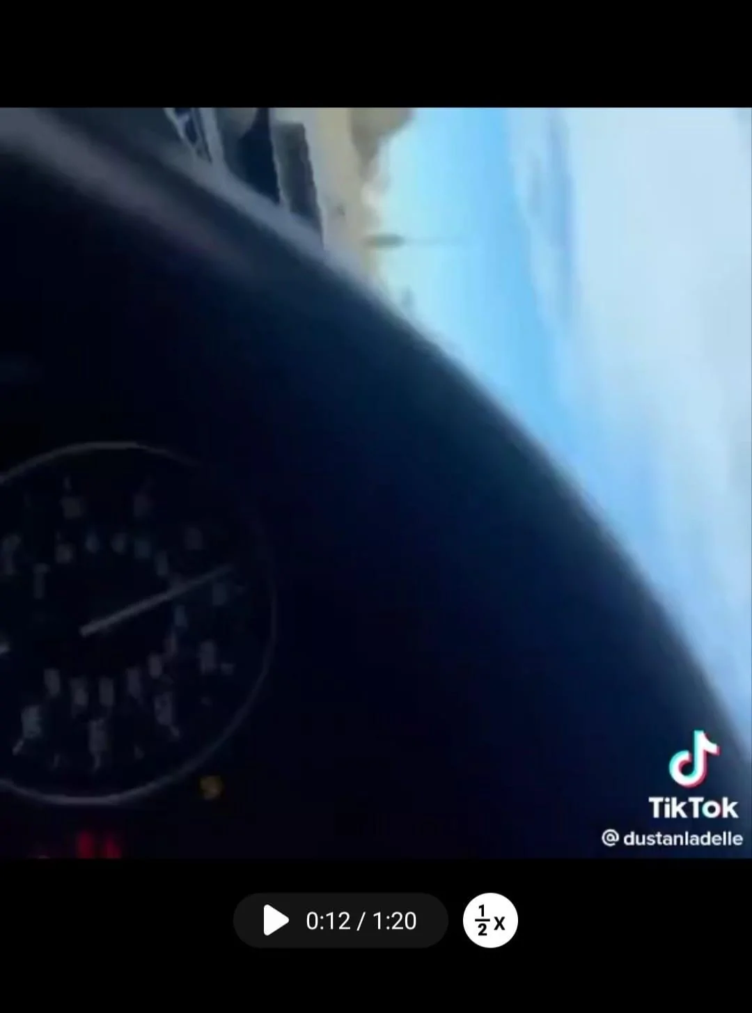

Based on the video and various accounts of the incident, as well as pictures of the wreck, my semi-educated wild-ass-guess is this:
An older ~900hp capable build on older engine management with zero traction control features,an incredibly poor choice of performance tires in general for a high HP RWD car (wreck pics appear to show Nitto Invos), cold weather that made those tires even worse to drive on, and likely a stock torsen diff doing what we all know the stock torsen diff tends to do when you combine lots of HP and especially in low traction situations - unlock unpredictably and seriously upset the car.
In the video you can see the car accelerate and step out a little bit to the left. The driver countersteers but it swings out a bit further to the right with a slight overcorrection. Then you see the car nose-down as the throttle is lifted. At that exact moment it almost looks like the inside (right side) rear wheel starts braking because the car rotates harder to the right, which is very consistent with how the stock Torsen LSD acts. The low traction from the cold and the poor tire choice only exacerbated and lowered the threshold for that shit.
Based on the video again, and how the car accelerated, I'd bet it was on wastegate boost or pump gas boost levels it wasn't on the 'let it eat' setting at all.

They're probably friends lol. Also mistake my @ss... he was flooring it and went well over the 55 mph speed limit. The camera car was already going around 80 mph.

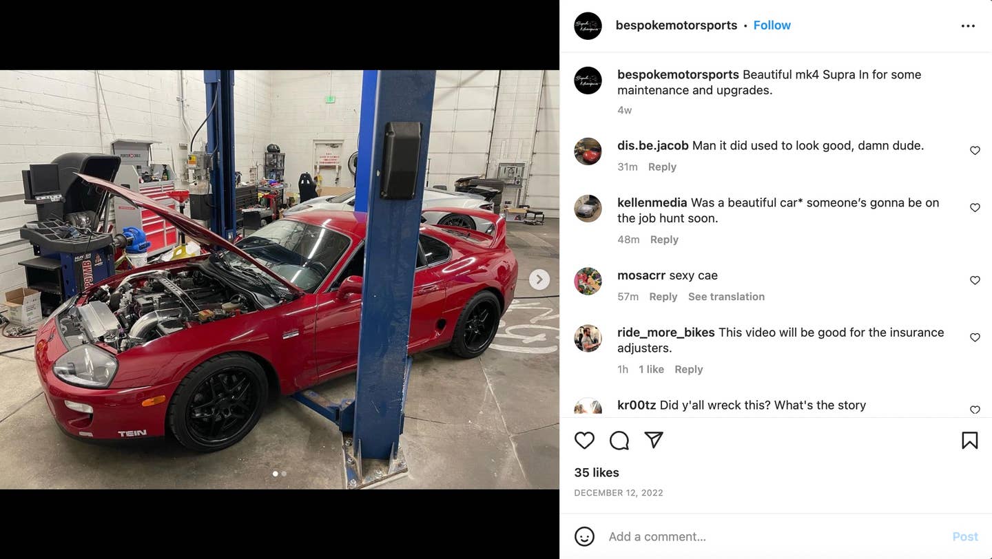

The profile screenshot was removed because we don't know for sure who was behind the wheel. However, I replaced it with a link to the shop which is fair game IMO. Customers should have info regarding good and bad shops, and in the end, it was the shop's responsibility to get the car back safely to the owner.
