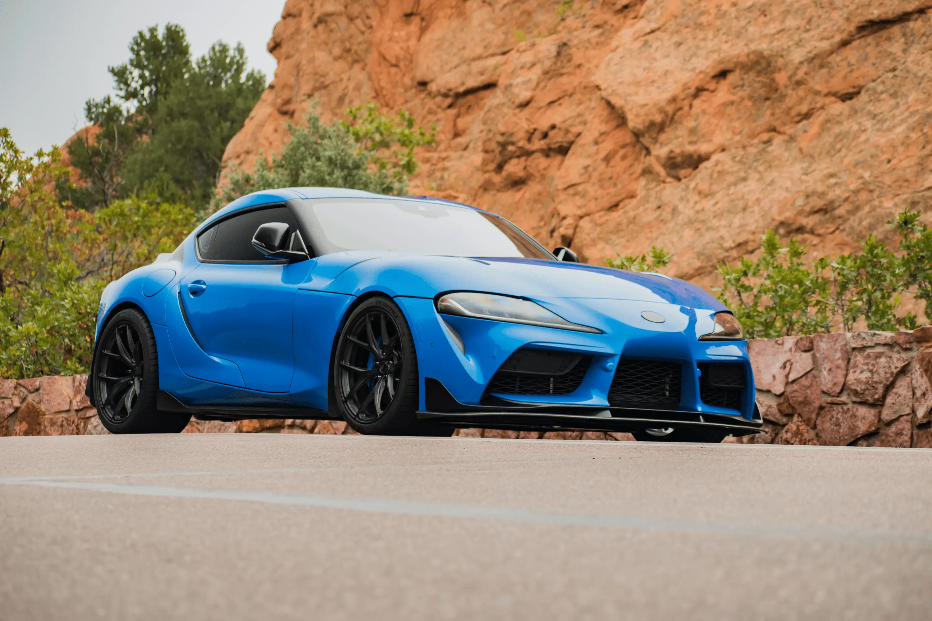

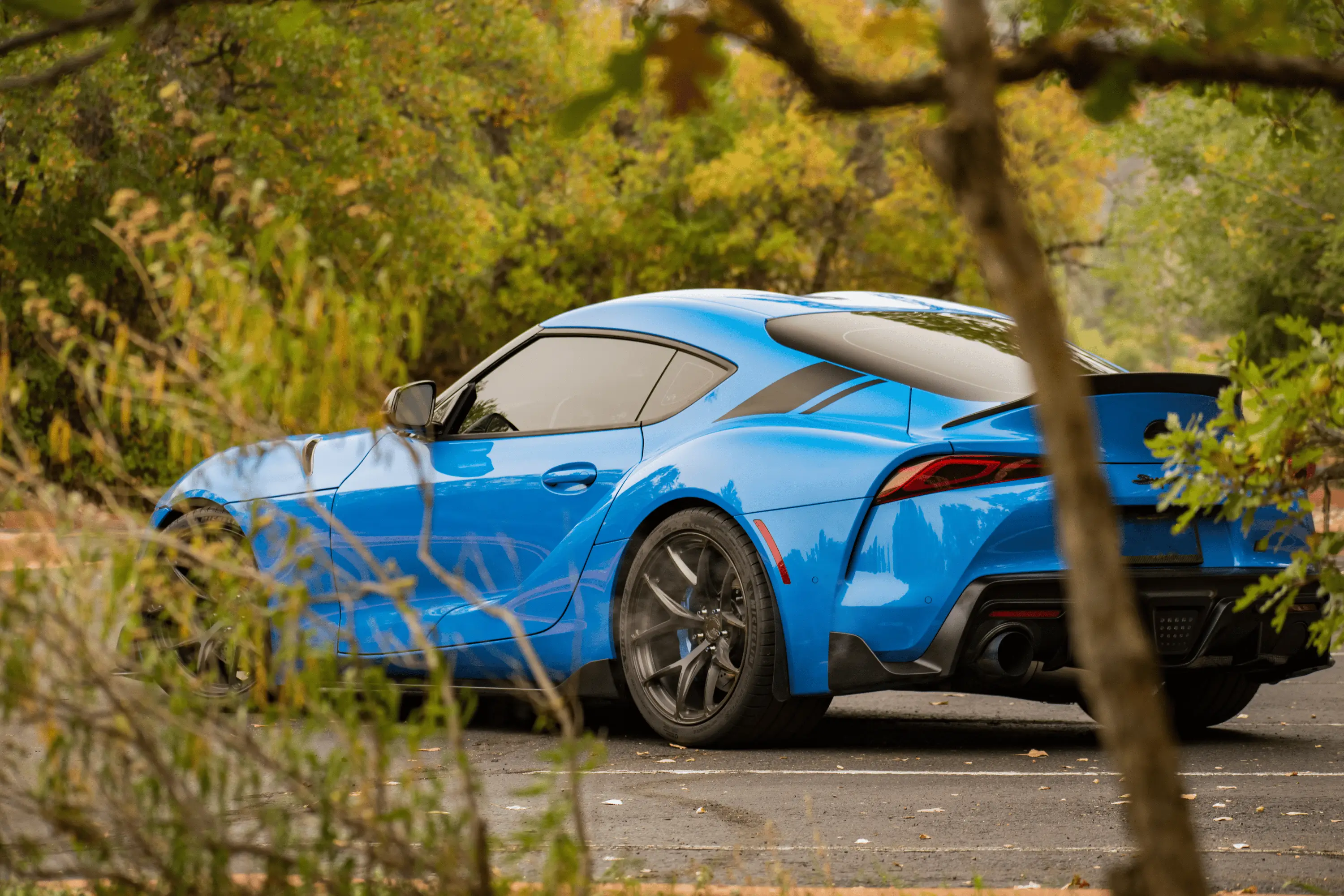

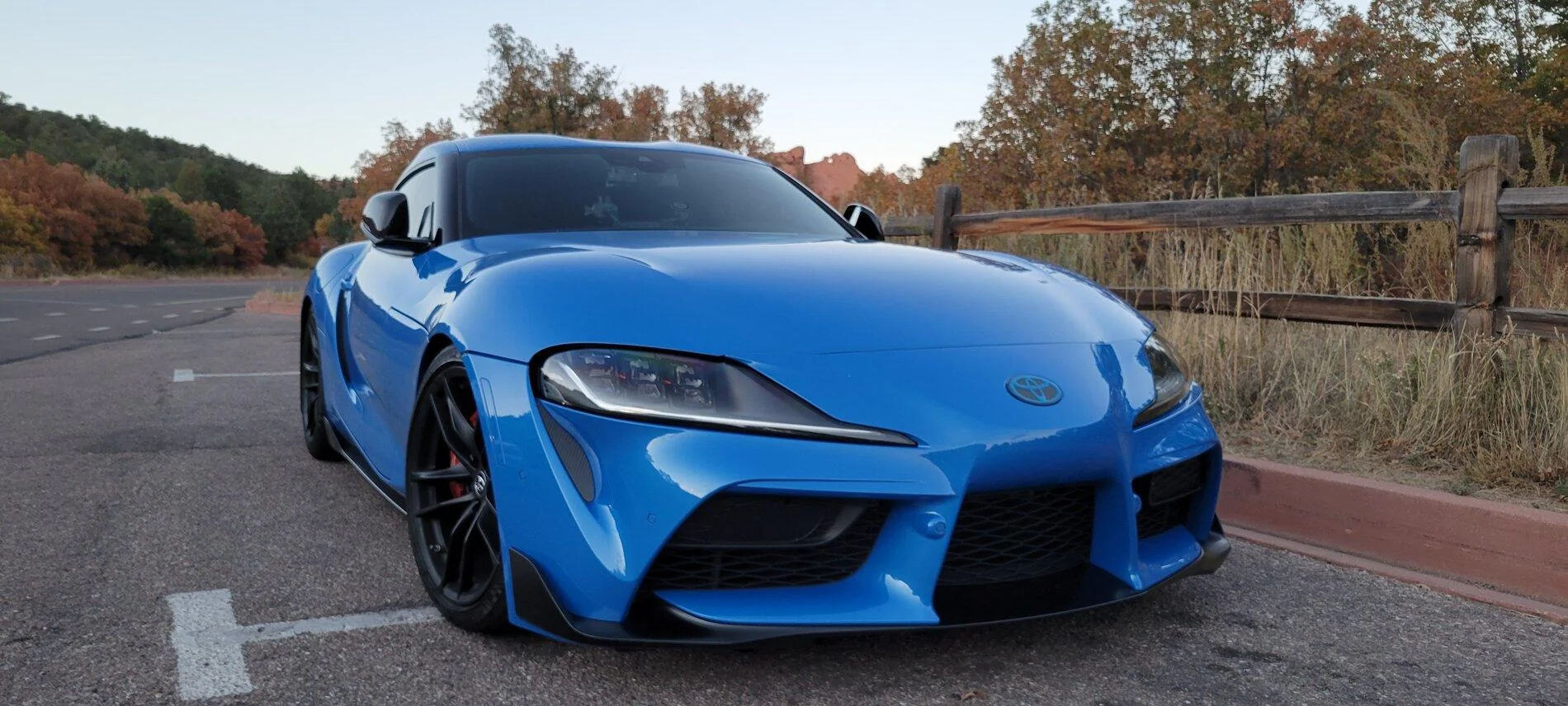

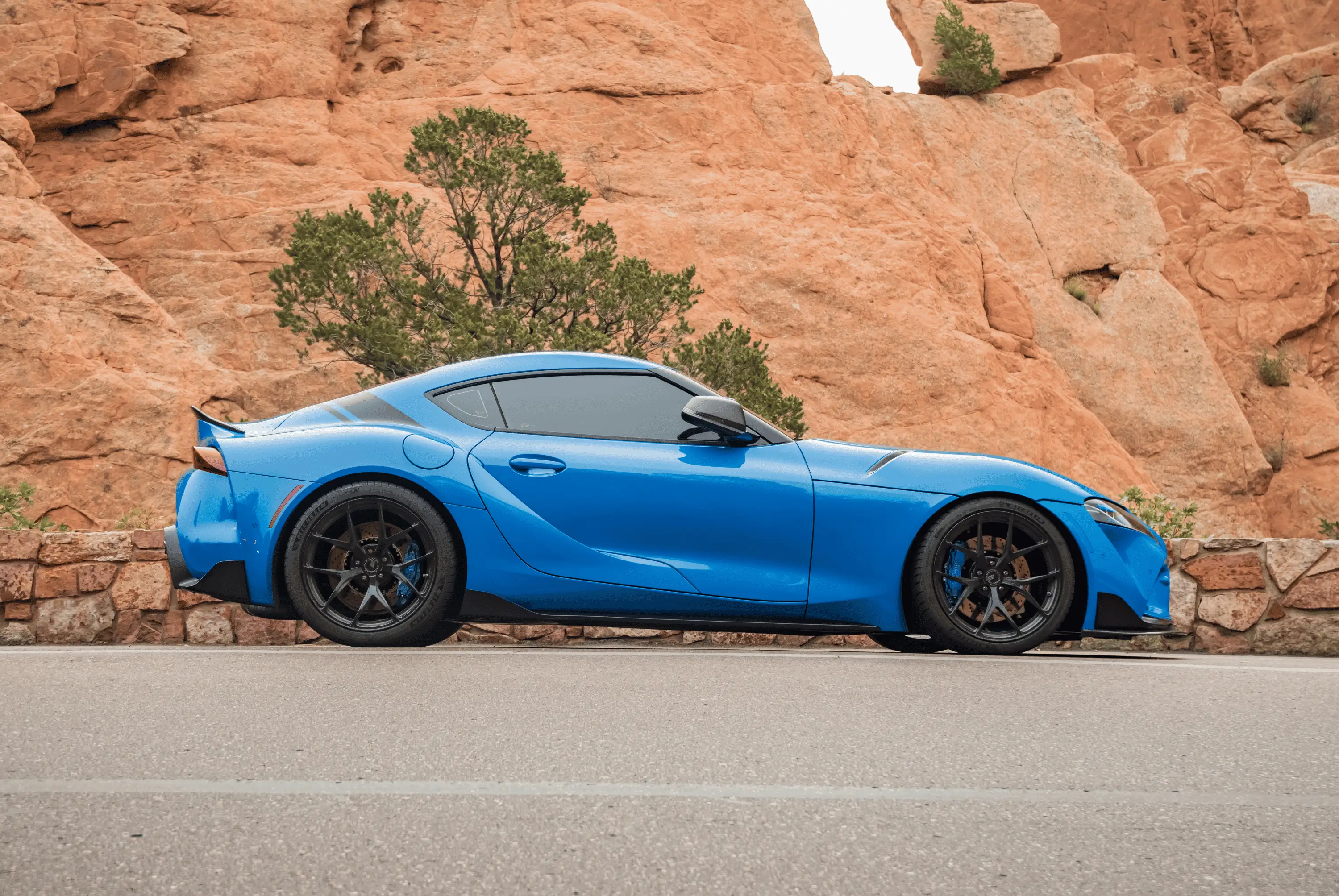

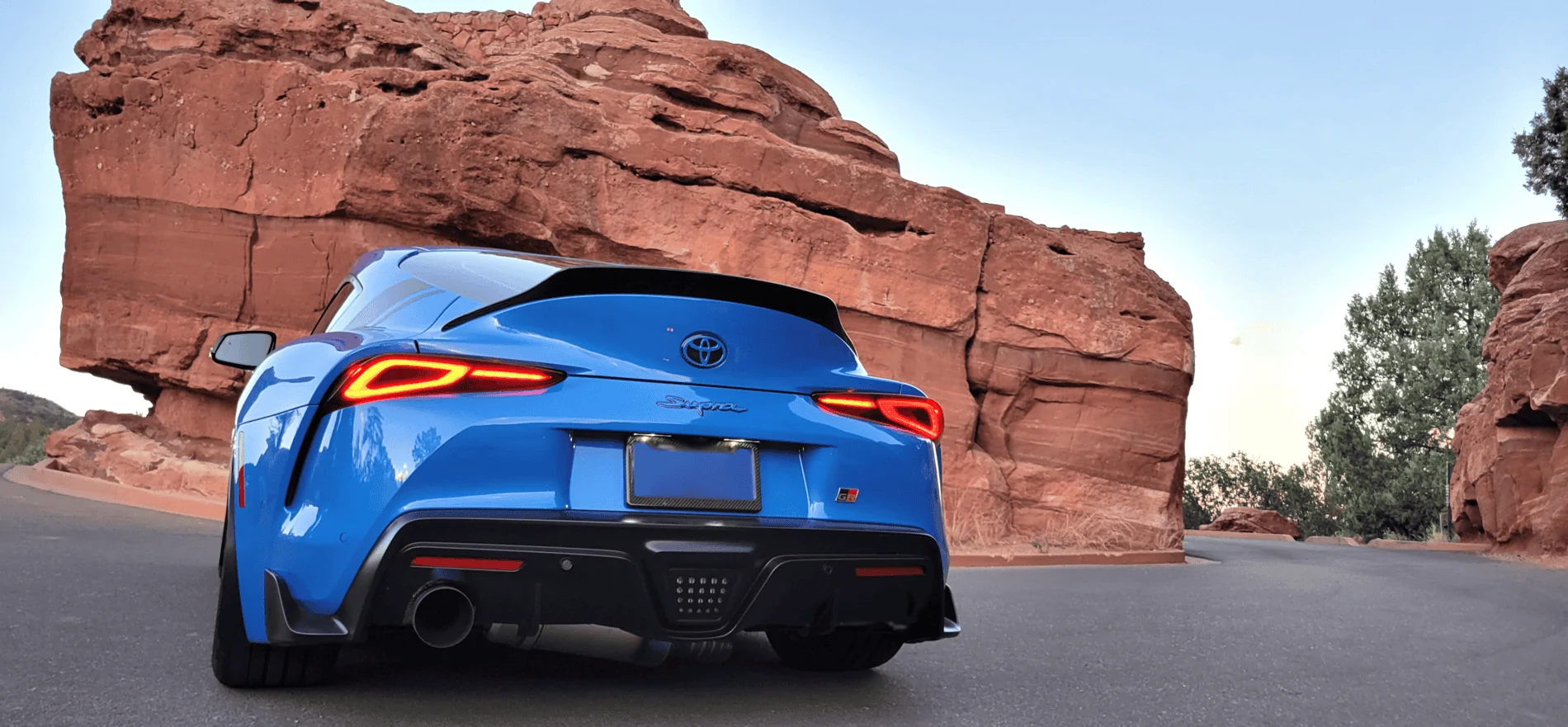

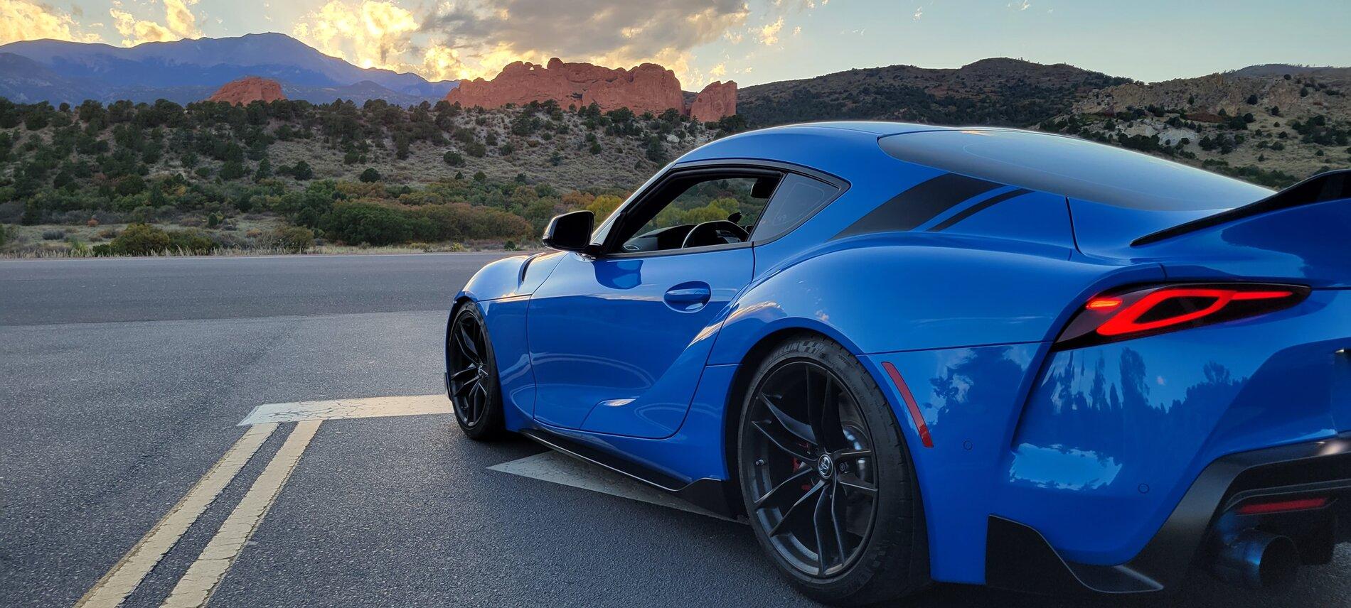

Updated 2/14/22:
Aftermarket Parts Installed:
  • Performance Mods:
    • SOLD-JB4 with custom tune from Jesse Dabears
    • Cloned ECU from Femto
    • ECU unlocked and EcuTek License by Marin
    • Boost Logic Port Injection with IDX1050cc injectors
    • Reflex MOTIV
    • LPFP upgrade with Hydromat
    • Jack's Transmission 750 Drag Pack Upgrade
    • aFe 2-1/2" to 3" Charge Pipe sandblasted and painted blue
    • Eventuri Supra Carbon Intake System
    • Tomei Type-R Titanium Single Exit Exhaust
    • Euromotive Performance Downpipe
    • Lightweight LiFePO4 Battery Replacement

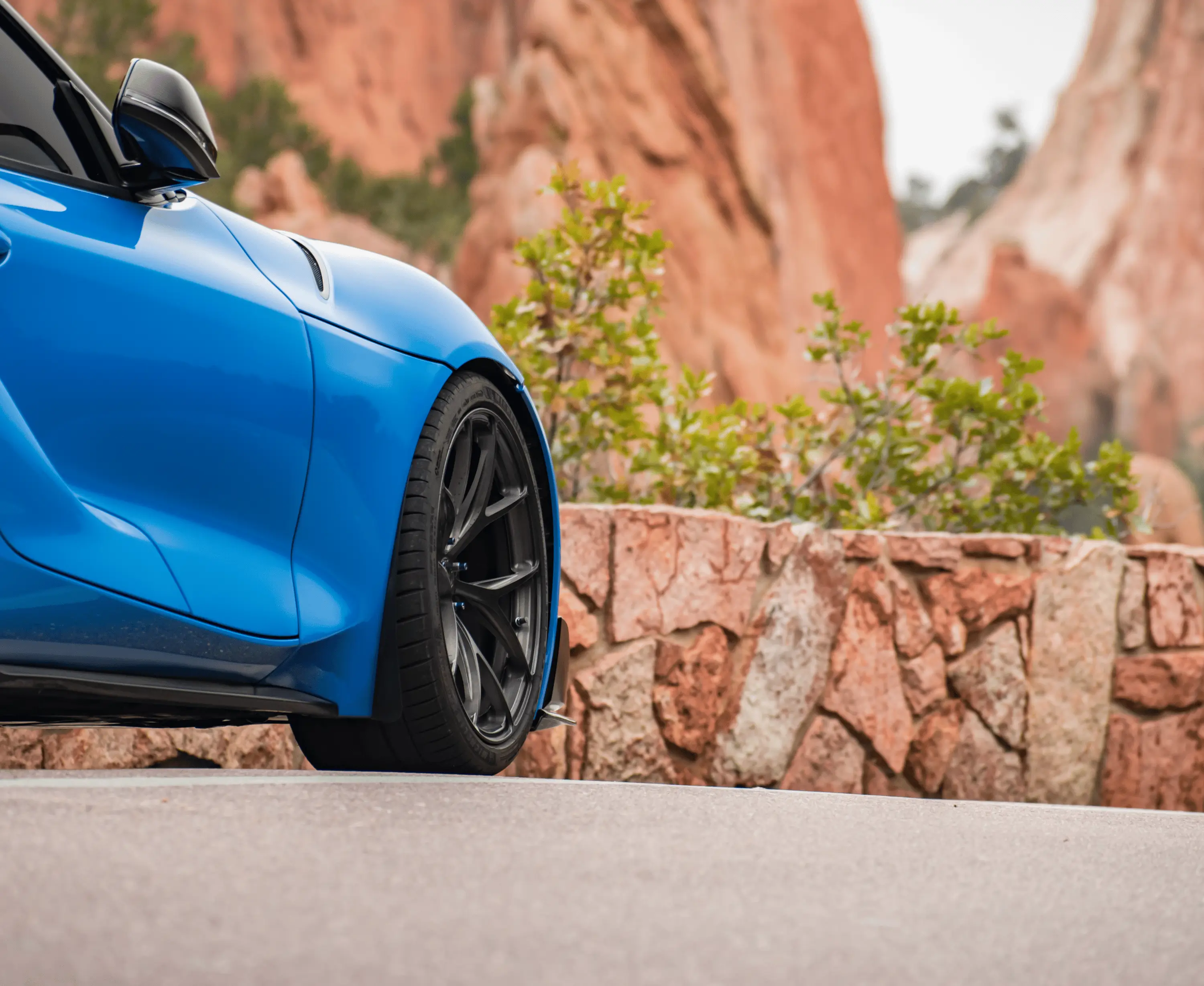

  • Wheels
    • BC Forged RZ21
    • Front: 19x9.5 ET22
    • Rear: 19x11 ET35
    • Titanium Stud Conversion Kit
  • Tires
    • Michelin Pilot Sport 4s
    • Front: 275/30
    • Rear: 305/30
  • Brakes
    • R1 Concepts Forged BBK
    • Castrol SRF Racing Brake Fluid
  • Suspension:
    • Swift Spec-R Springs
  • Heat Management:
    • Verus Engineering 6 Port Turbo Heat Shield Kit
    • Exhaust header heat wrap
  • Engine Bay Aesthetics:
    • NVS Carbon Engine Bay Cover Set
    • NVSPEC Carbon Engine Cover with Custom Blue Toyota Logo
    • MKV Carbon ECU Replacement Cover
    • NV Spec. MKV Carbon Radiator Cover
    • Underground Graphics Blue Supra Engine Decals
  • Interior Aesthetics:
    • Custom CF Steering Wheel
    • NVSPEC Carbon Cabin Brace
    • NV Spec. MKV carbon armrest cubby
    • NV Spec. MKV carbon seat inserts L & R side
  • Exterior Aesthetics:
    • NV Spec. MKV carbon Front bumper vents L & R side
    • NV Spec. MKV carbon dash vents L & R side
    • Functional carbon hood vents L & R side

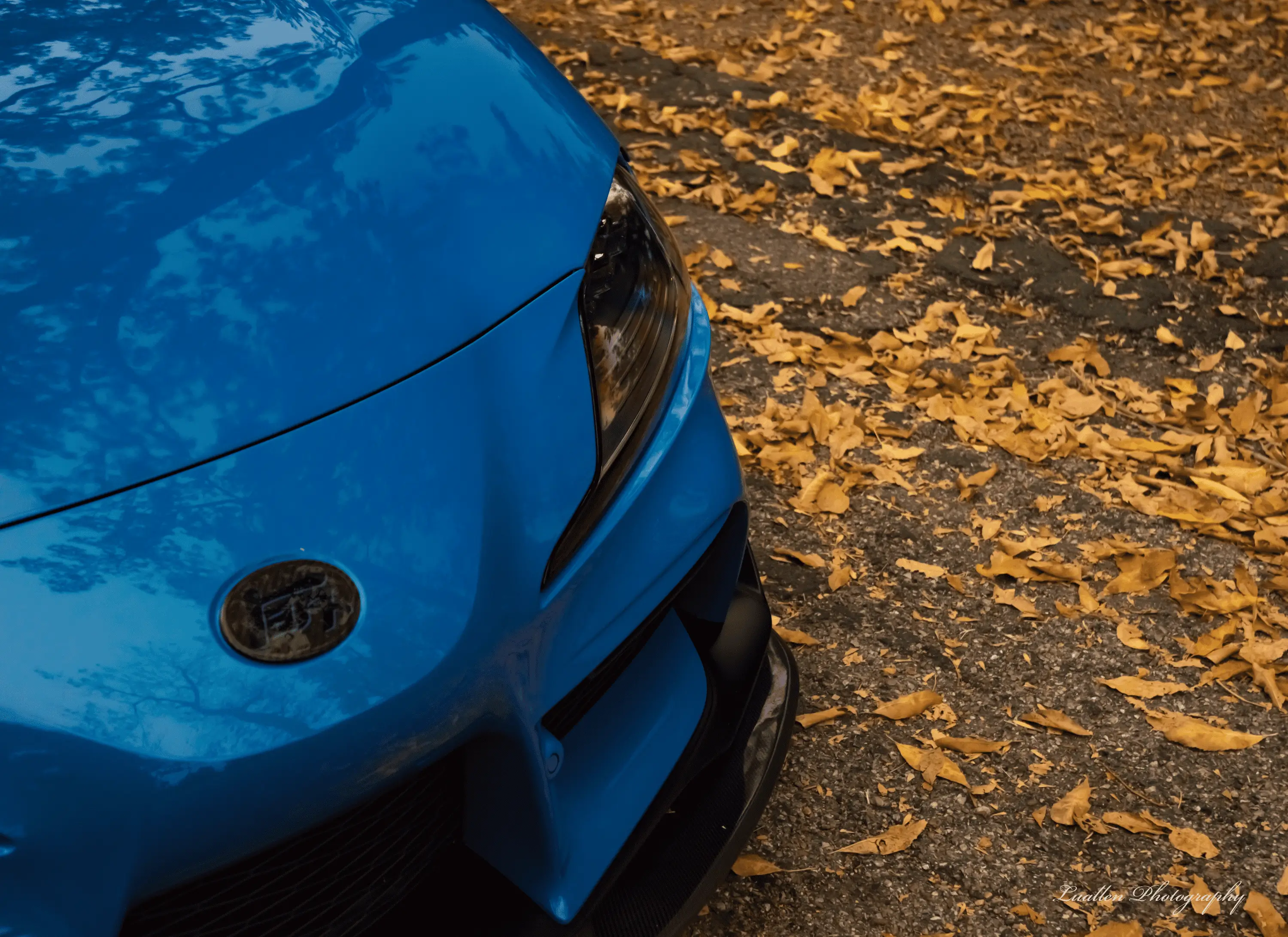

    • Etsy Custom CF Front and Rear Toyota Emblems
    • Custom Supra CF Emblem
    • Artisan Spirits Front CF Lip
  • Exterior Accessories:
    • ZL1 Rock Guards
    • Automodz A91 Edition Spoiler in CF
    • XPEL Ultimate Plus PPF
    • Ceramic Coating
Parts on order:
  • Just a few goodies... Stay tuned.
Future Plans
  • Done ?-ECU/DME Unlock HOPEFULLY! Otherwise the remaining list is useless!
  • On order ?-Pure 850
  • Done ?-Port Injection
  • Done ?-Transmission Upgrade
