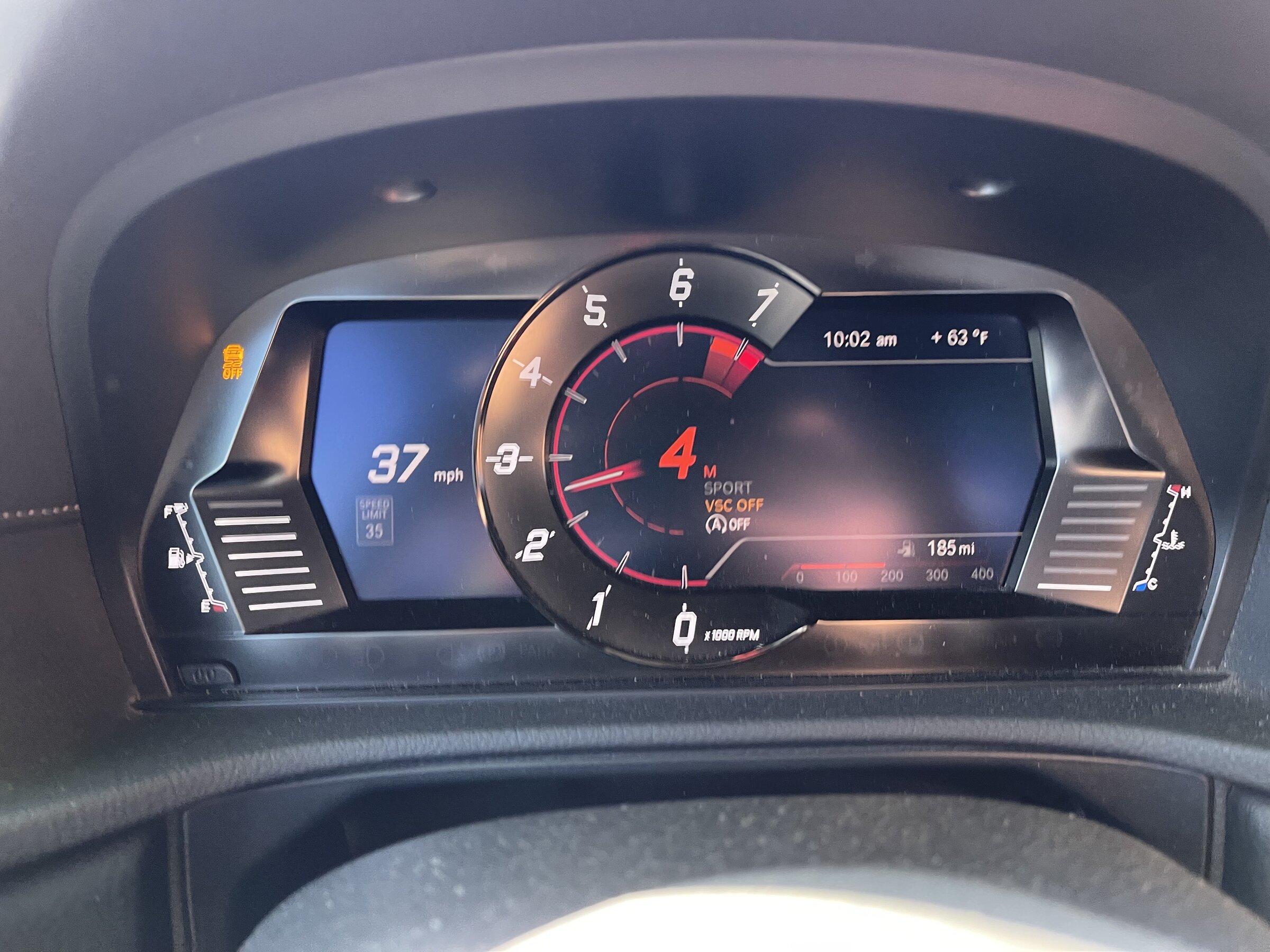

hi guys,
i am sure some of us have already installed aftermarket seats on this beemer supra.
Need some insight on how to turn off the airbag dashboard light on.
i have been reading some in beemer forum that they use 2.2 ohms resistors to disable the light, and some even have the black module that you just plug into the airbag sensor under the seat.
Coming from subaru we always use 3 ohms resistors to turn it off.
Does anyone here have successfully turn off the airbag light on??
thanks

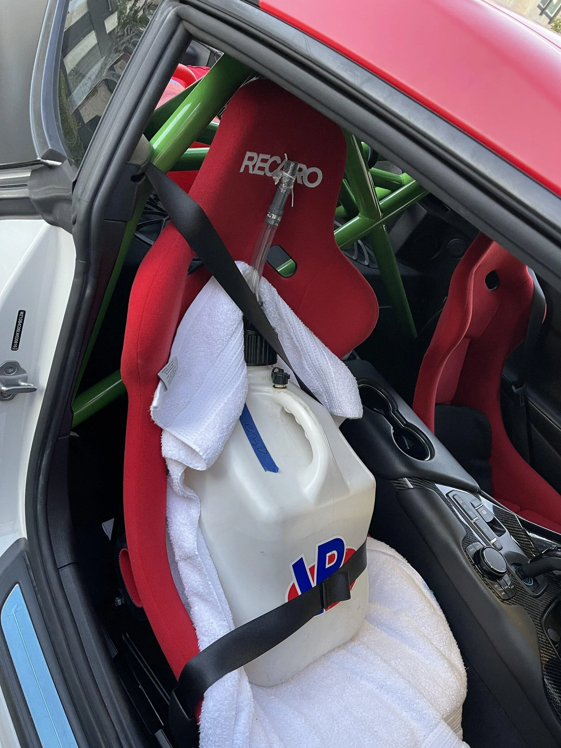

Hey guys! I’ve done this already and I used remote coding service by AlpineMSS here in SoCal.
https://alpinemss.com/
