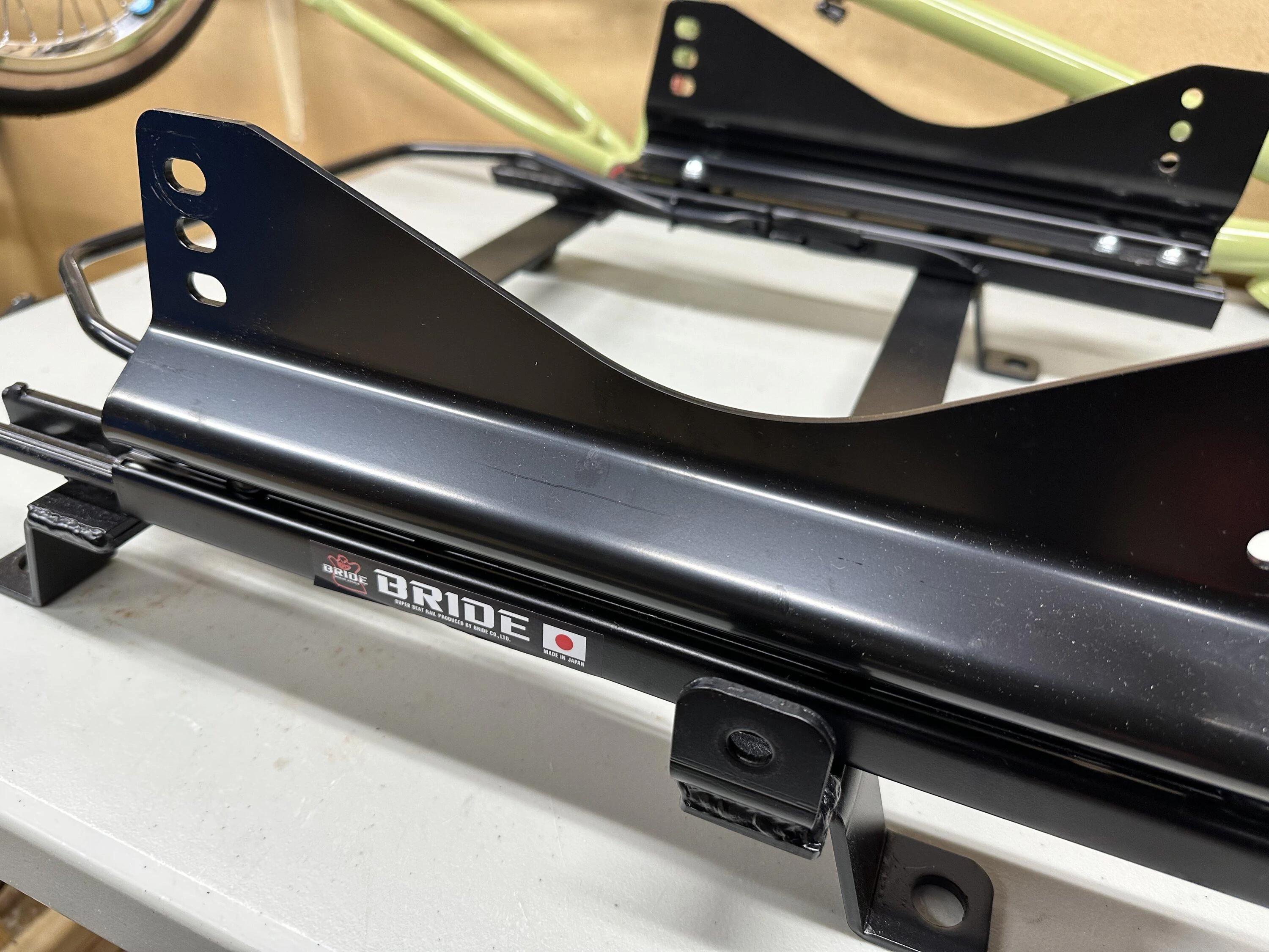

Anyone know if the bride seat rails can fit a Recaro Pole Position ABE? Think it's wider than normal Pole Position
Recaro Pole Position ABE Fit I have them in mine. the bride seat rails didnt work with the Recaro PP ABE I tried them so i had StreetFaction Engineering make a set for me. here's a video with the seats and brackets i used. quality product!
you can get the brackets at streetfaction.net or you can email the owner at [email protected] for any questions
