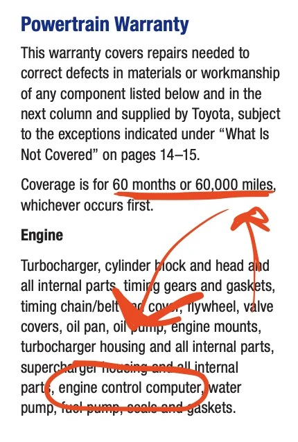

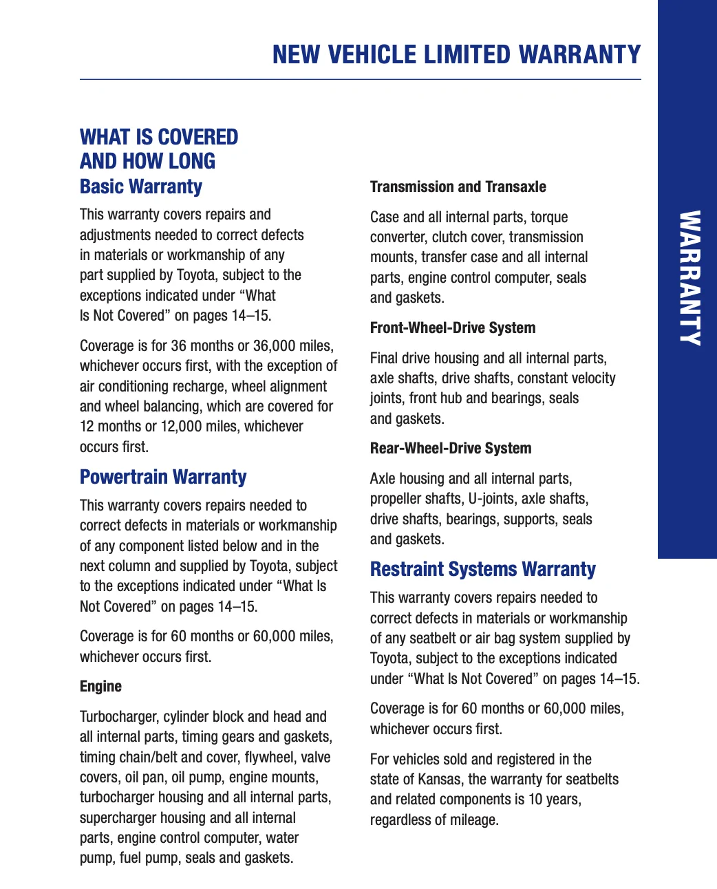

I'm in the UK, we have a set up called an extended warranty from Toyota, so if you keep taking your car back to the main dealership for servicing has per scheduling, the car is further covered for an extra 5 years after the initial 3.
Yea that is a nice perk in the UK for sure. Here in the United States, again, there is a 60k/5yr powertrain warranty to which the DME is a part of. Concept is wrong as usual.
