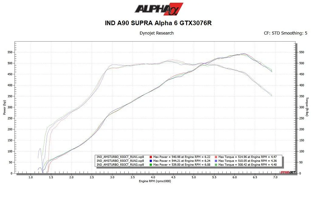

Here's our Alpha6 results on 93. Unfortunately (or fortunately for someone), we've already uninstalled as we've moved on from the car to focus on other platforms so we do have a barely used Alpha6 kit we need to sell.
Look at that flat torque from 3000 - 5500 rpm. Nice!?
