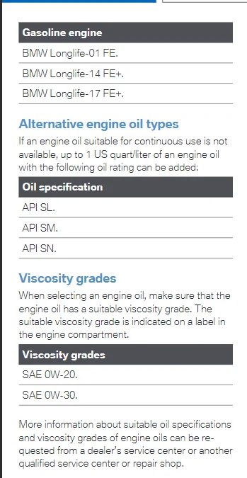

This is from the Z4 manual.

Ok, so seems maybe 0w30 isnt an issue. Guess I'll research some more of what to make the switch to, if anything. Was looking at the oil change kits offered by FCP euro and saw a lot recommending the 5w30 oil.
