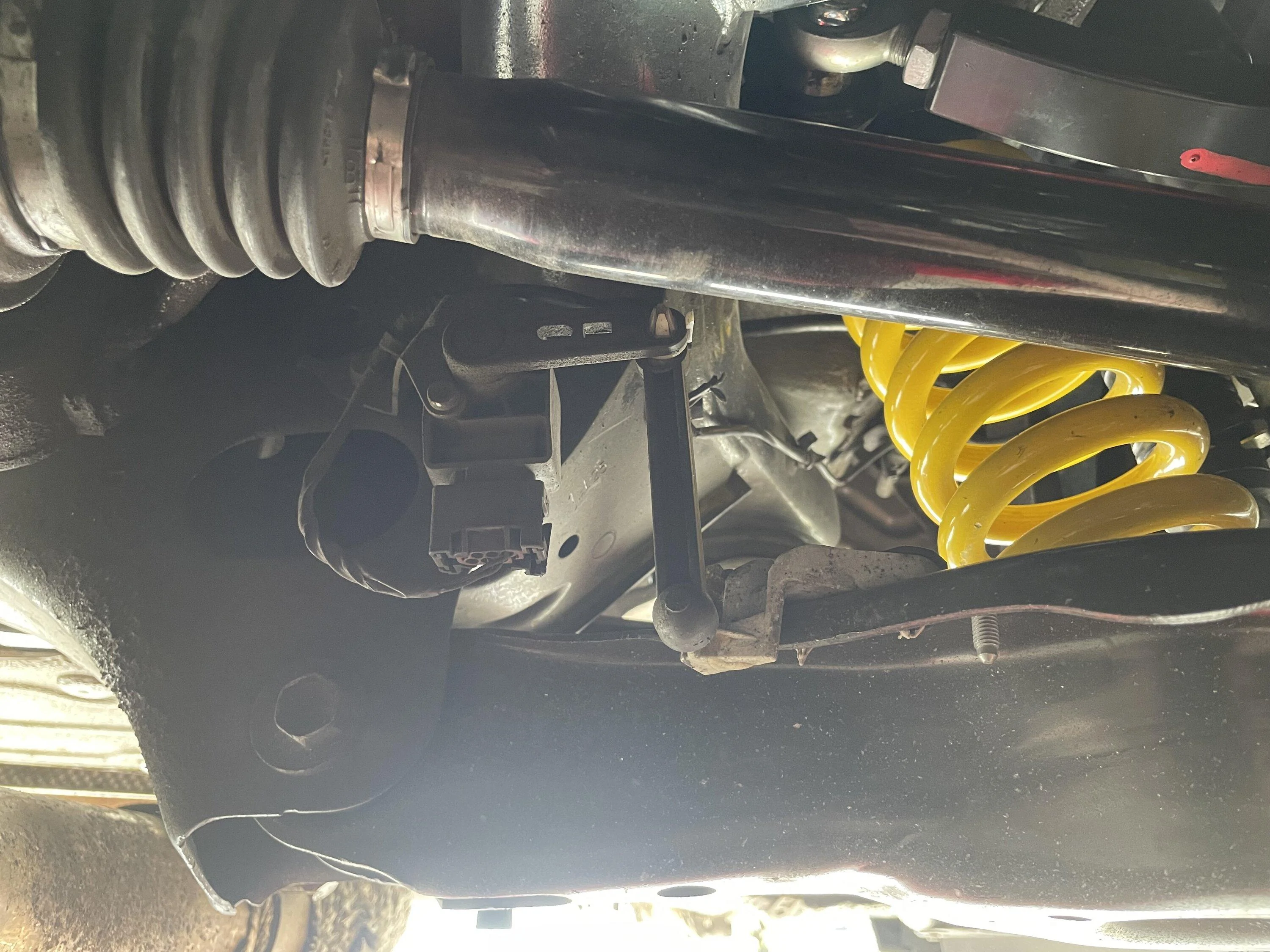

Jack up the car and take a picture of your front and rear ride height sensors

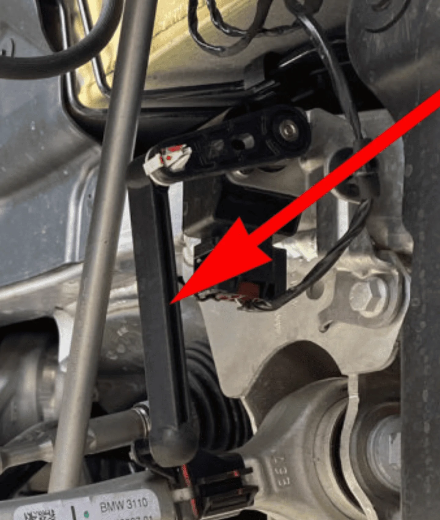

This is definitely related to the sensors. Both are on the left side - one on the front lower control arm one on the rear. Here is a pic. Of the rear.

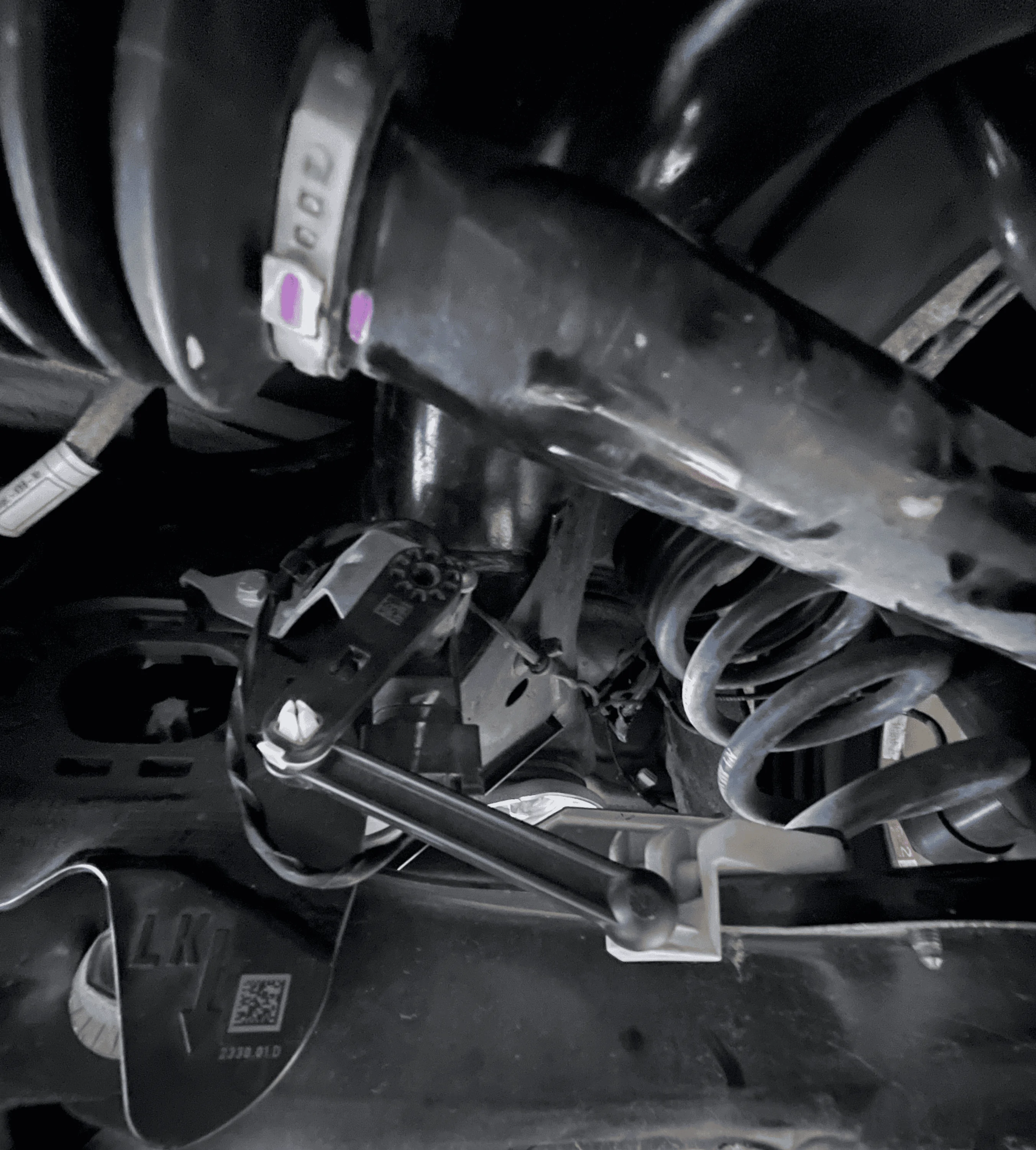

Hi all, short update. Just had the car in for a new exhaust and asked my mechanic to take a look at the ride height sensor brackets. The front was good, but the rear was not (pretty disappointed that both Toyota techs told me that the brackets were fine and that it was because the car was lowered...)
Rear bracket.
Rear bracket
Thank you @Todday1 for the reference image.
The chassis code is gone. I'm hoping that when I go out for a cruise tonight my headlights will not point directly at the ground.
Hopefully this thread helps others as well :)
Thank you again everyone for the help.
Do you happen to have a pic of the front? Thank you.
