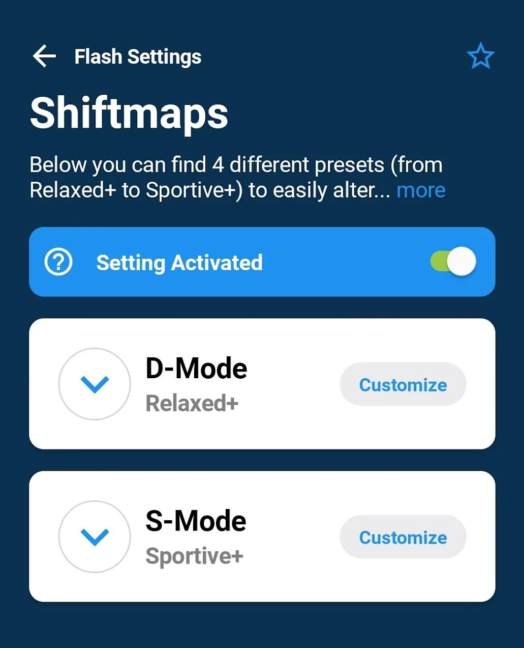

Have you updated?
There was a version 1.4 update recently.
-Injection duration changed to prevent a potential torque limitation.
I've been running this the same Multimap for ~1y (since release), no issues.
My 2nd gear was jerky but it was related to how I had setup XHP stage 2.
I went down to stage 1, much smoother for my setup.
Relaxed+ also helped, its butter smooth.
