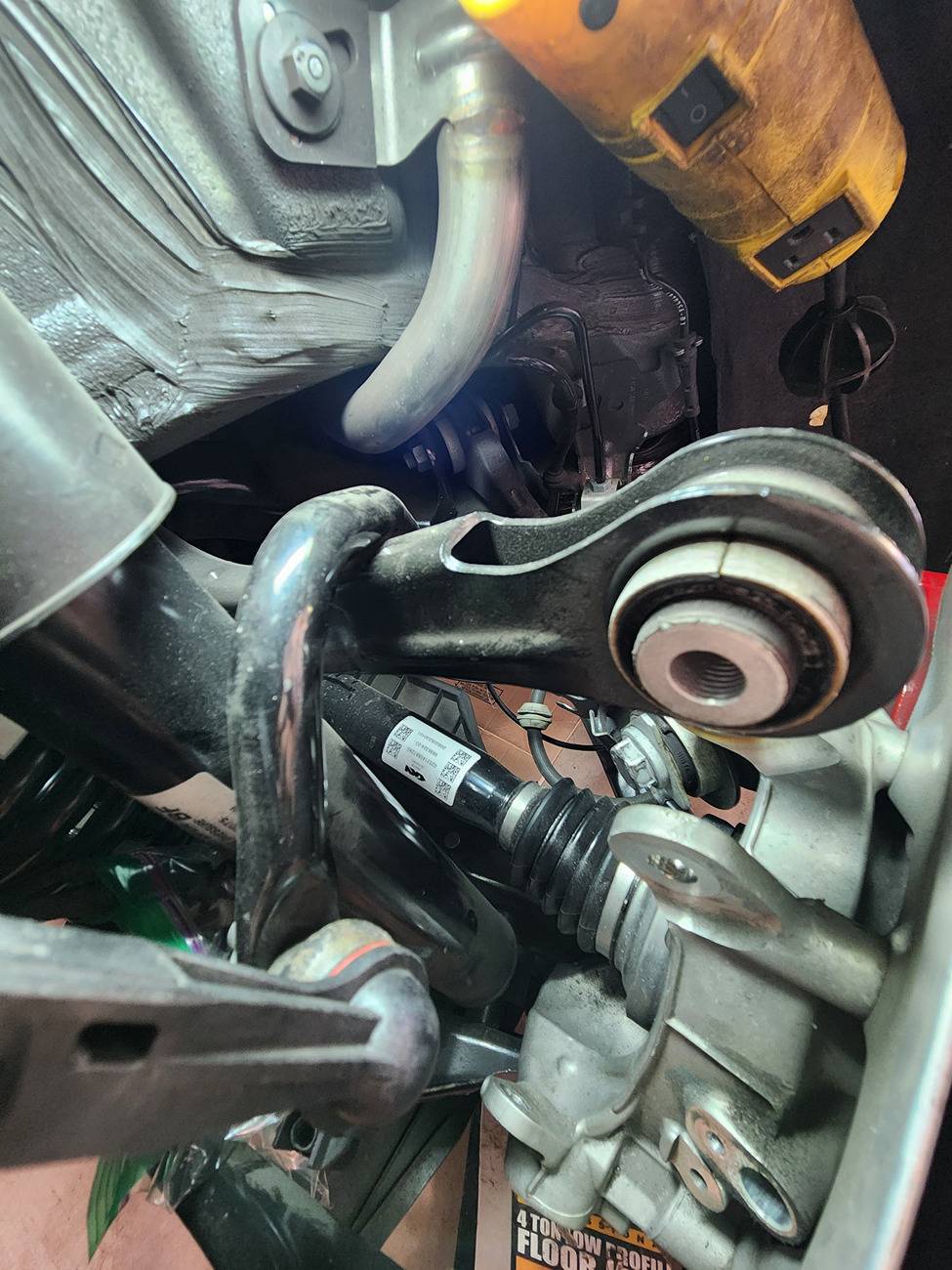

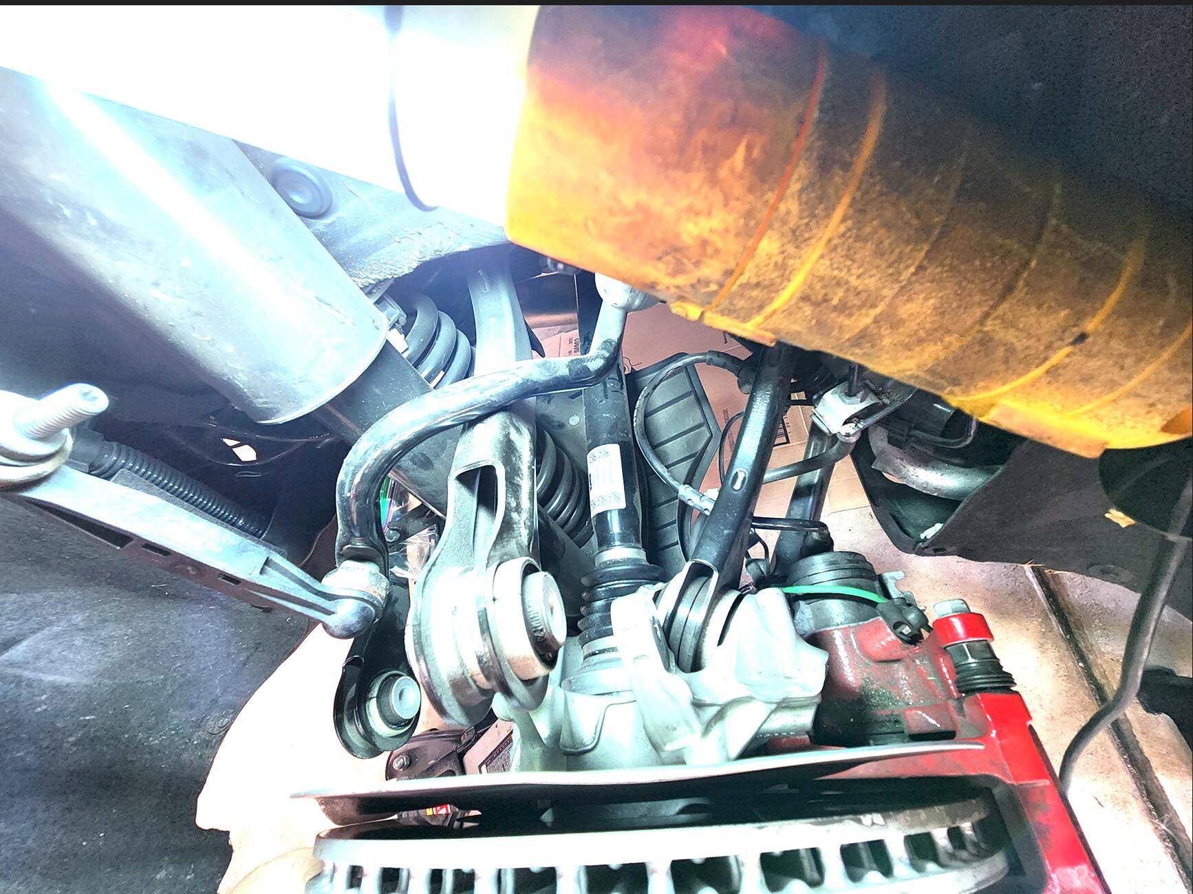

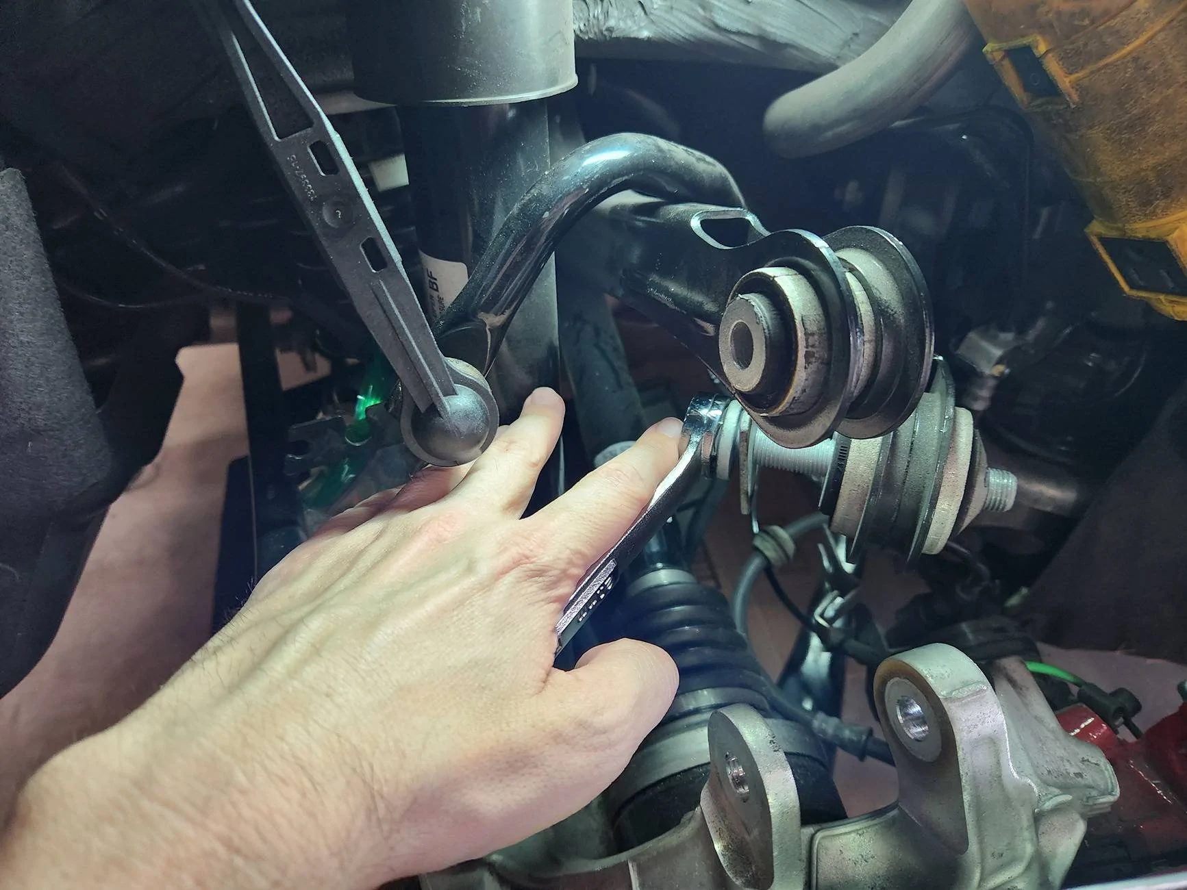

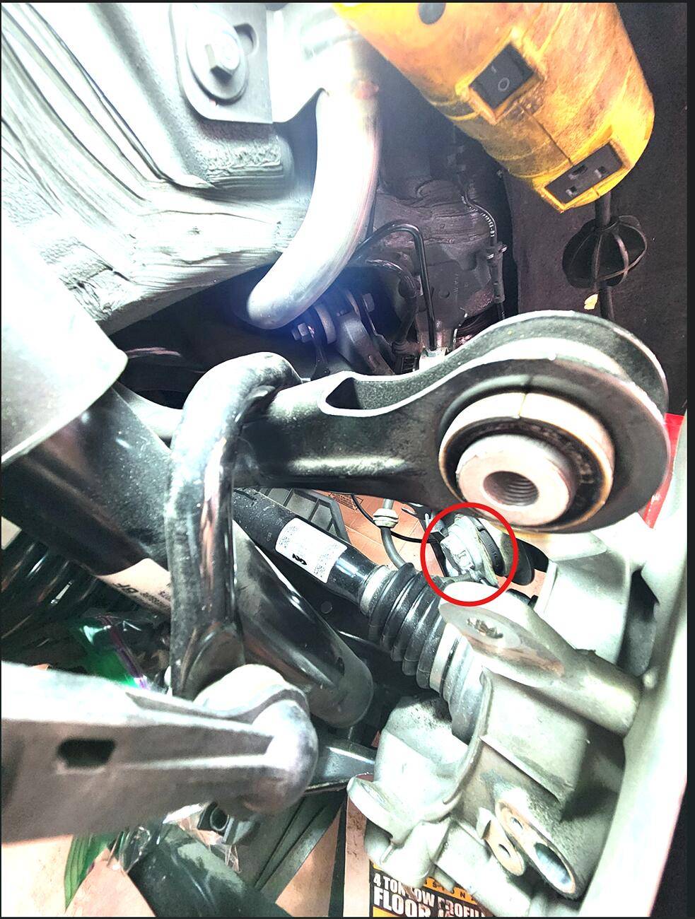

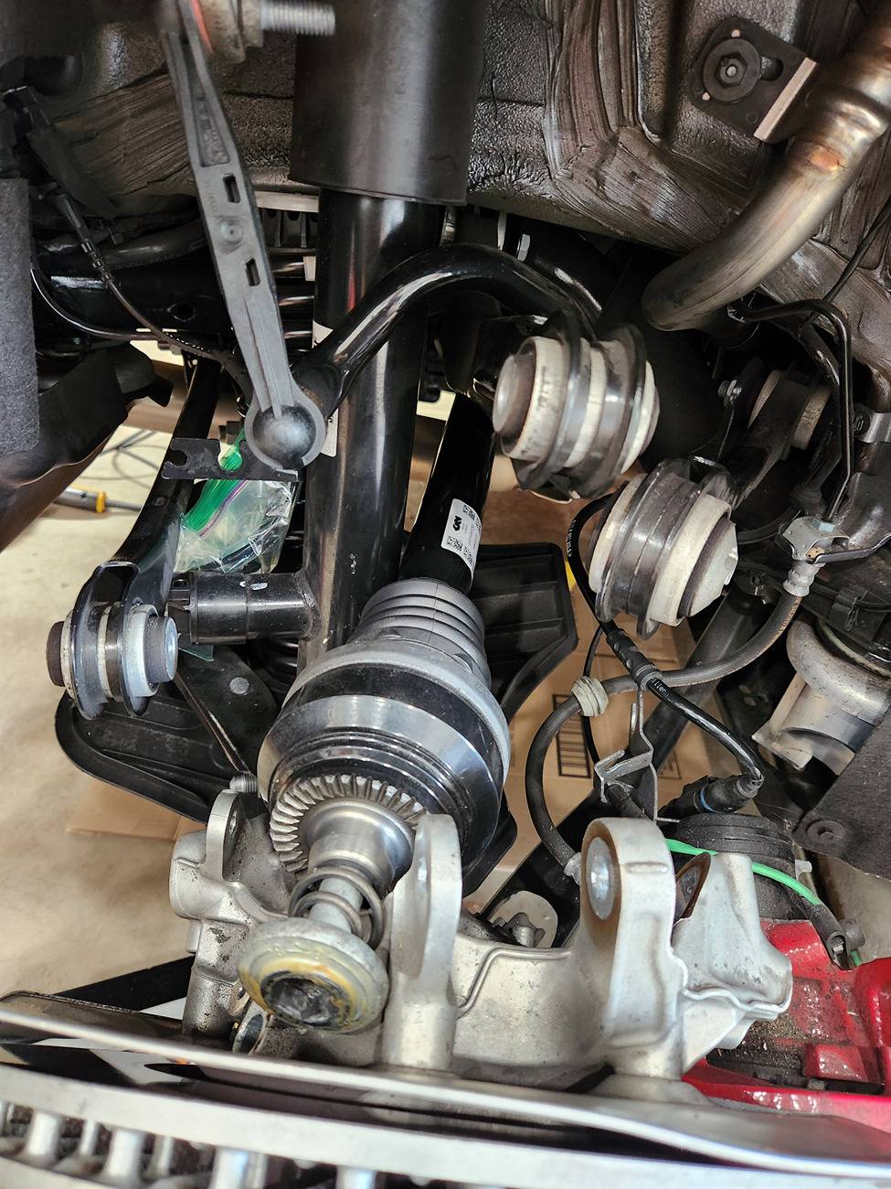

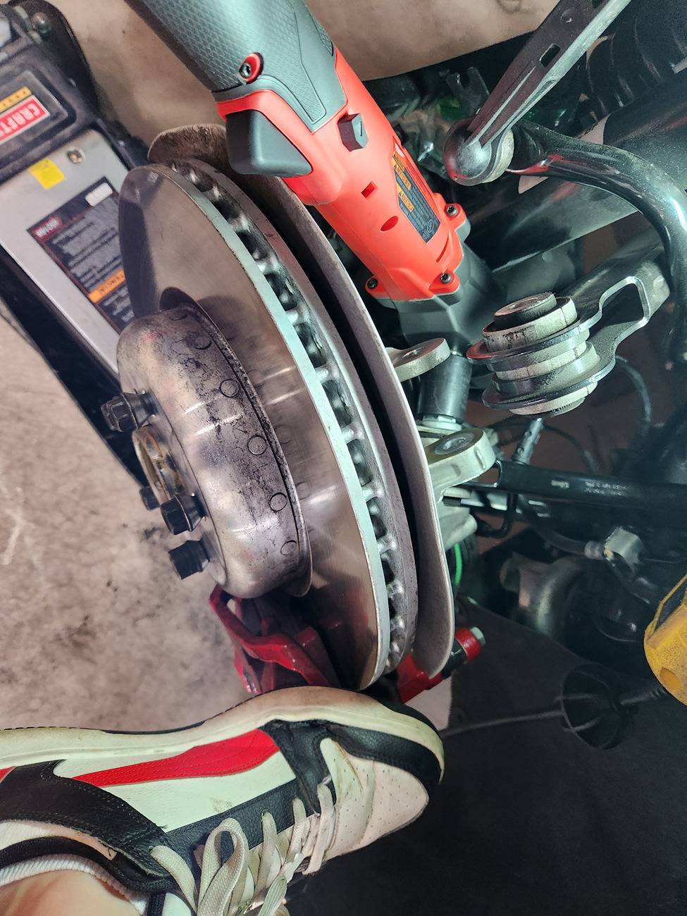

Yep just a good yeet will do it. The g force outlaw axles need a little trimming of the arm to clear or aftermarket arm, but the titan and dss ones use a smaller outer and clear ok. What did you end up upgrading to

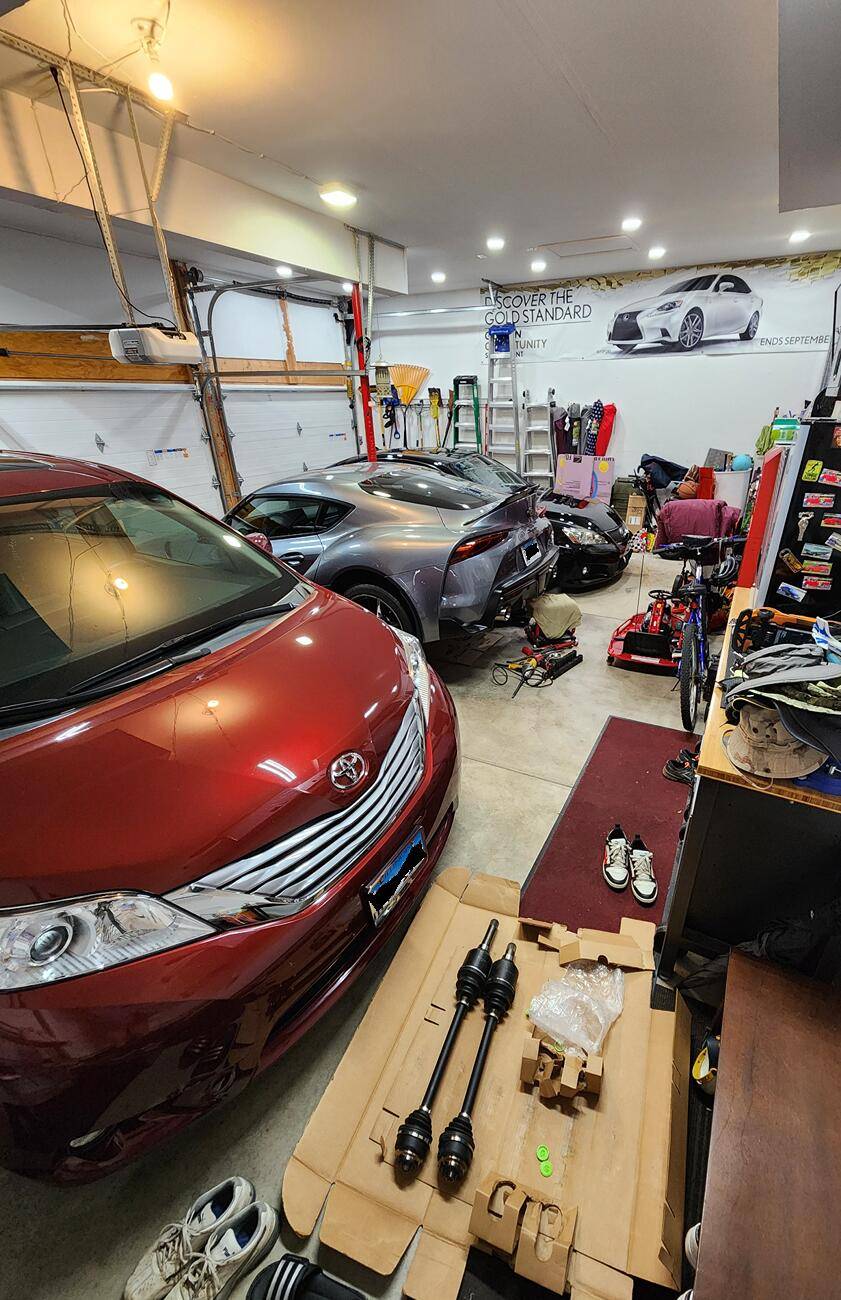

I got the Driveshaft Shop ones from a local speed shop named Boostin Peformance.
They had extra new ones from their drag car that they let go for $1700.00 out the door.
I also got their used carbon fiber driveshaft but not sure if I will end up using it or just sell it - to replace the driveshaft you have to take out exhaust, brackets, etc...all the same work that if I would upgrade the transmission - so I might just sell the driveshaft and buy another one later down the line.

Most axles are held in the diff with a circlip on the shaft and "I think" the Supra is the same. You'll need a large soft faced or dead blow hammer to release the clip or a piece of hardwood and a hammer to give it a knock. Sometimes a hard yank will do it but not always. Same goes for the install. A good thwak to seat it is needed.
No reason to guess. Laid out pretty simply in the workshop manual.

Got both axles in and everything cleaned up - took car for a ride and no issues.
I can now play around more and launch from 2nd gear without worrying about breaking anything...
Im going to write another thread from some things that I have learned :)
Thank you all for responding!
