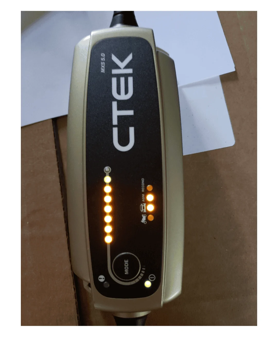

Yes, I have the MXS 5.0, hardwired indicator panel in the hatch. Its plugged in anytime i wont drive the car for more than a few days.
100% id suggest keeping it on a charger if youre going to go more than a week without driving it.

Identical to what I did, except I hardwired mine to the under-hood connection points. Same charger, same discipline. This is the way.
