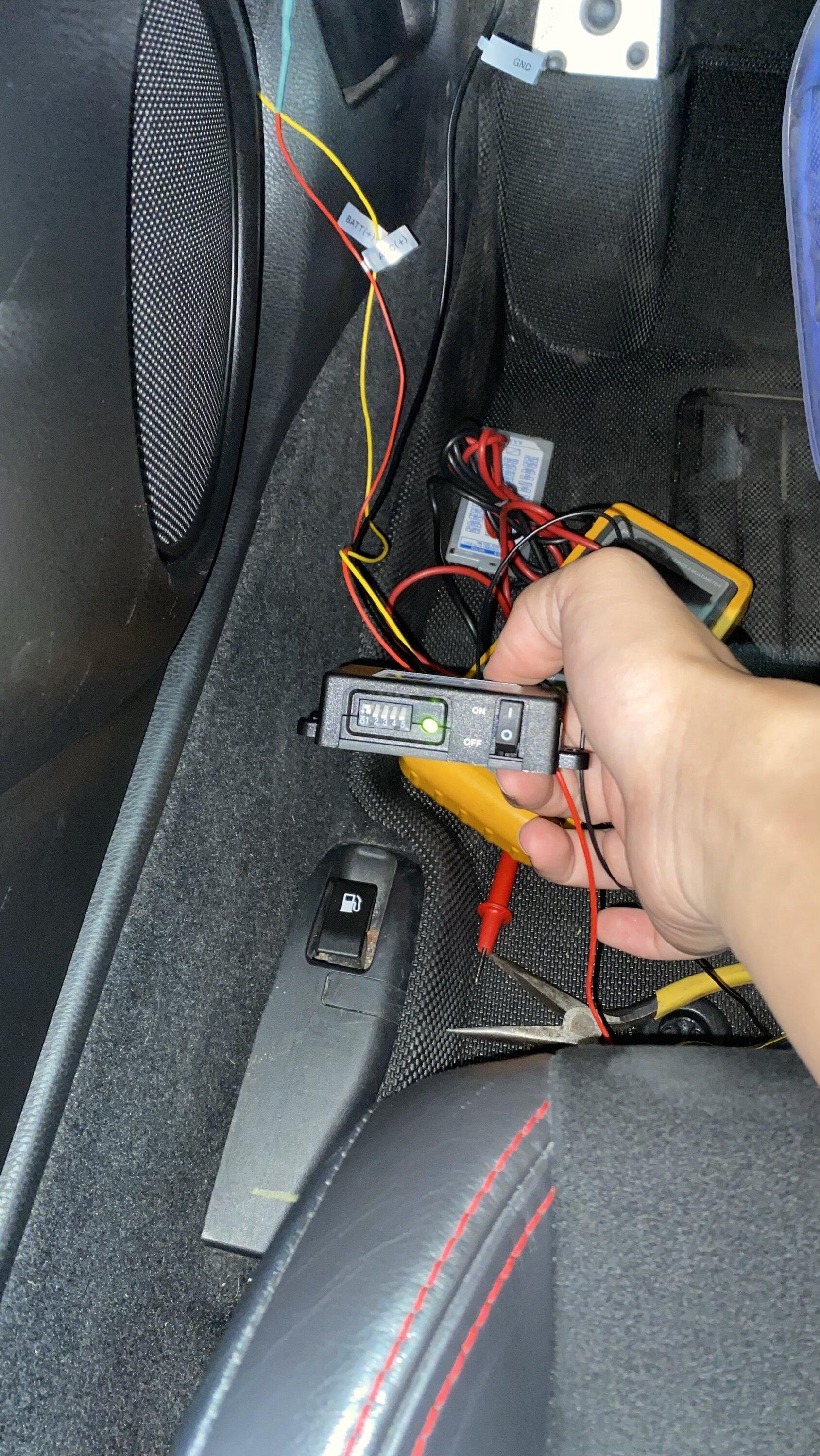

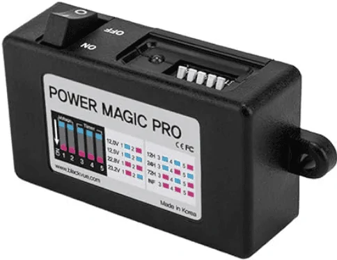

Hi guys,
I am coming from a Subaru BRZ where I had my Blackvue Dashcam tapped into an always on fuse with the BlackVue Power Magic Pro box, and had no problems doing constant parked mode recordings for 1-2 days straight on my cars AGM battery (made sure it cuts off at 60%).
However, on the Supra platform I haven't heard anyone doing it this way and would like to confirm if this is feasible or will cause the car to throw a code.
I am not opposed to doing an external battery, but unfortunately there's no easy on/off switch like the Magic Pro box as I wouldn't want my dashcam to record when I park the car at home.
If anyone has some insight or possibly wiring up a on/off switch on an external battery please let me know
Thanks

Sup OP. I also tried this route when wiring up my blackvue. I am going to say this. It will throw a code. Maybe that code won't be a big problem but the code it threw for me was:
"Battery malfunction while shutting down vehicle electronics" Just a heads up if you look on the bimmer forums, some people have also mentioned this. Not surprised lol.
Now idk if this is a huge problem tbh because this problem was intermittent. Sometimes it threw this error and sometimes it didn't. Car started fine and even survived cold Chicago winter winters with this error too. But ultimately I got the external battery because any warning like this didn't make me feel comfortable, and after that no warnings, and everything has been working smoothly ever since. Blackvue has some wonky user experience in their apps..but it's nice to see your external battery charge level.

i definitely recommend an external battery pack. the blackvue B-130X does have a switch, so if you put it in your glove box you can switch it on and off when you want. the only downside is it is max ~30hrs of parking recording.
