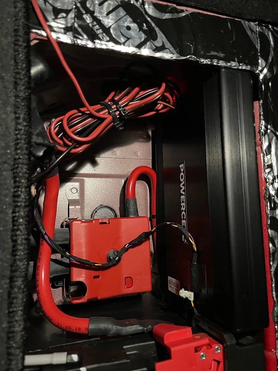

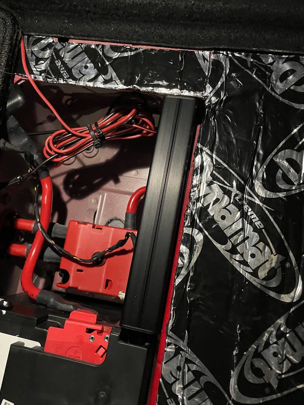

Finally got around to doing this after a year. Went way better than I expected. The blackboxmycar powercell 8 fits perfectly in the location shown in this guide.

You mind taking a picture of that? My powercell 8 definitely would’ve been a tight fit by the battery.

I tried leaving a gap underneath for the cables there but it’s a tight squeeze.

Thanks! I thought about it there but was real tight and seemed to put a lot of stress on the power cable.
Ended putting the battery in the foam by fuse box like someone else mentioned.

Ah okay. I might move it because I am scared of damaging that wire
