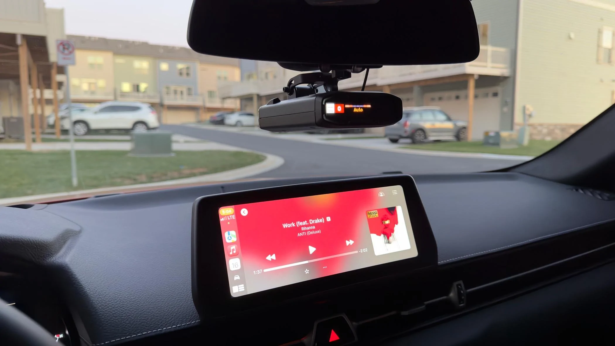

Right there with you puzzled. Here's my install of my R7.

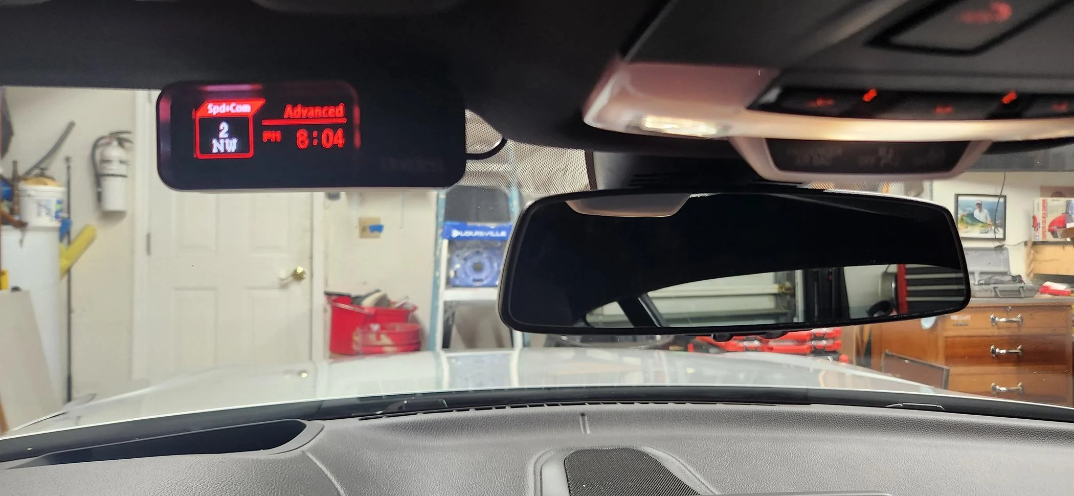

I replaced the two suction cups which tend to fail anyways with 3M plastic velcro tape (similar to this one https://a.co/d/7cdqqZ0 ) and got everything as close to the headliner as I could. This way I can move it from one vehicle to the next whenever I want to. These cars already have terrible visibility and getting a mount that hangs the radar under the rearview mirror or even using the larger suction cup mount that comes with the radar was just gonna make things worst IMHO. I can still use the visor within it's usable/effective range, just not fully open it which for me was perfectly fine.
Just want to quote this for emphasis, as my experience is the same. There's already a decent blindspot on the other side of the rear view mirror, no need to make it larger. I have mine tucked up by the headliner as you've shown and it doesn't impede visibility at all.
