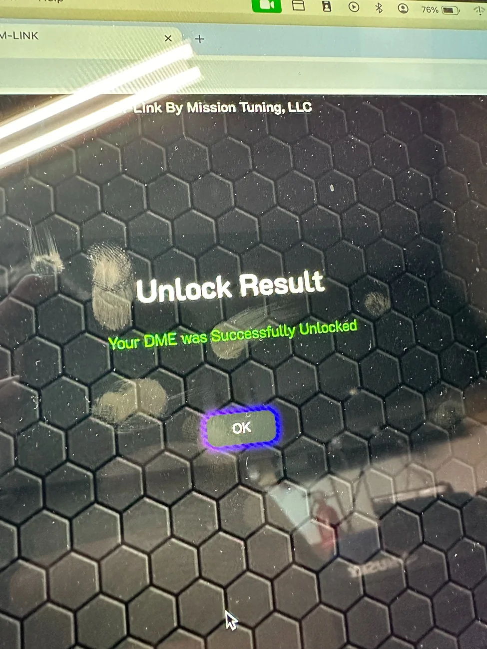

I have a 2020 LE that had been to the dealer for brake boost recall. I did bench unlock in my garage in under 15 minutes using MHD unlocker. EzPz. Flashed with MDH over wifi OBD2. EzPz.

Nice. Ya that's the way to go. Especially since my local shop wants $500 for a bench unlock. The unlocker software and a wifi dongle is cheaper. Thanks for the info.

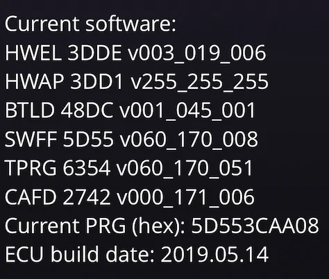

If you have an OBD2 dongle that works with MHD, you can download the MHD mobile app and check the DME date (no app purchase required).
Where it gets fuzzy is that the tools won't know if it truly needs a bench unlock or not. Example: My 2020 is bench unlocked and all the tools still state it needs a bench unlock even though I have flashed it 100+ times.
Example DME check with MHD mobile app (my personal 2020 Supra), ECU = DME:
Two follow up questions......
What if MHD says I need a bench unlock, I buy the unlocker, run it, but I was already unlocked from factory and I actually didn't need an unlock? Does it just fail, does it mess anything up?
What happens if I use MHD to flash and I do need a bench unlock but didn't get one?
Does it just fail, does it brick the ECU, do I lose my stock tune, will the car start & run?
Thanks.

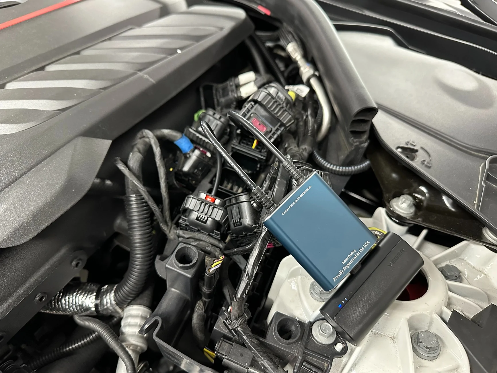

I would try to flash the car with MHD first before buying the unlocker. It will just fail to flash anything if it needs to be unlocked. Kind of hard to brick the DME on these to be honest.
The unlocker will know if the DME is locked or not. Won't mess anything up.
Hardest part of the unlocker is connecting it to the DME, and that is actually pretty easy. The actual unlock process takes like five seconds.
