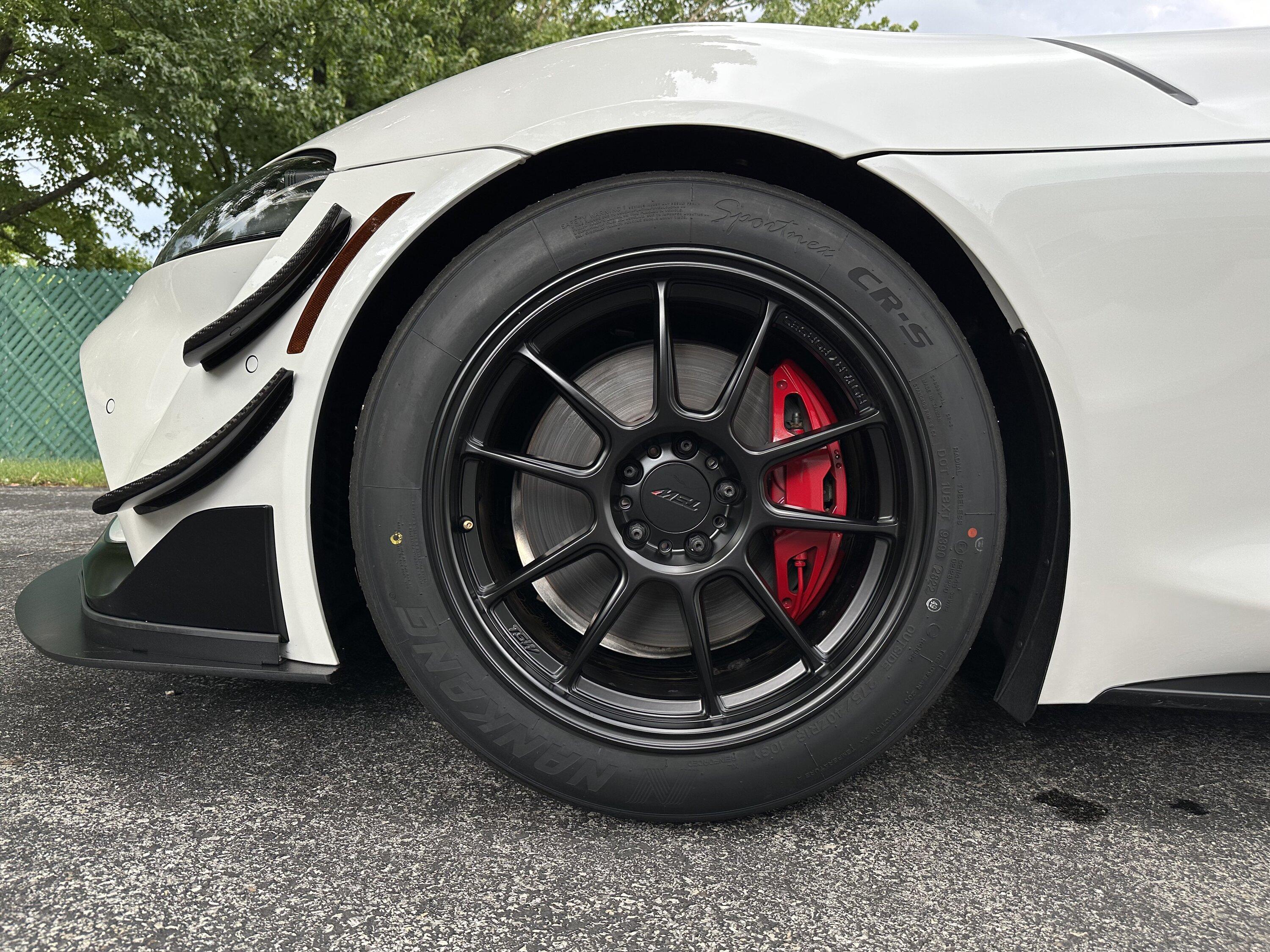

I run the apex 18” sm10 wheel 18x10. These fit 275/35/18 tires for a square set up and also use the apex stud kit. Rims are a little over $400 each direct from apex. I have two sets now and they have held up well. So something to consider. They have a lot of clearance and fit big brake kits as well as I also have a 6 piston front and 4 piston rear caliper/ 15” rotors all the way around and everything fits with no spacers etc.
APEX for me as well.
