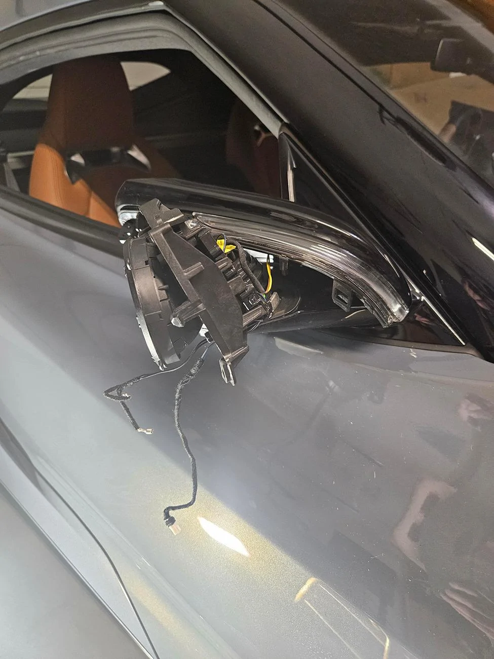

Guys, don't be like me.
Everything went so smoothly, I thought "I don't know why people were so worried."
And then after putting everything back together, the passenger mirror doesn't adjust.
Sad panda. Turns out I did exactly what ArmenLS1 did, thanks @ArmenLS1 for posting his mirror mishap...
I had been so keen to get the prybar back towards the middle of the mirror... i would have been better off nearer the edge.
I *then* failed to fully connect the BSM wire.. that guy is tricky because it's got a soft rubber plug on the back half (presumably for water), so it's hard to tell if you're all the way in. so I think in total, I've removed the mirrors 5 times.. I'm pretty dialed on this process now, so I'm happy to offer surgical assist to anyone scared to do this in Albuquerque :)

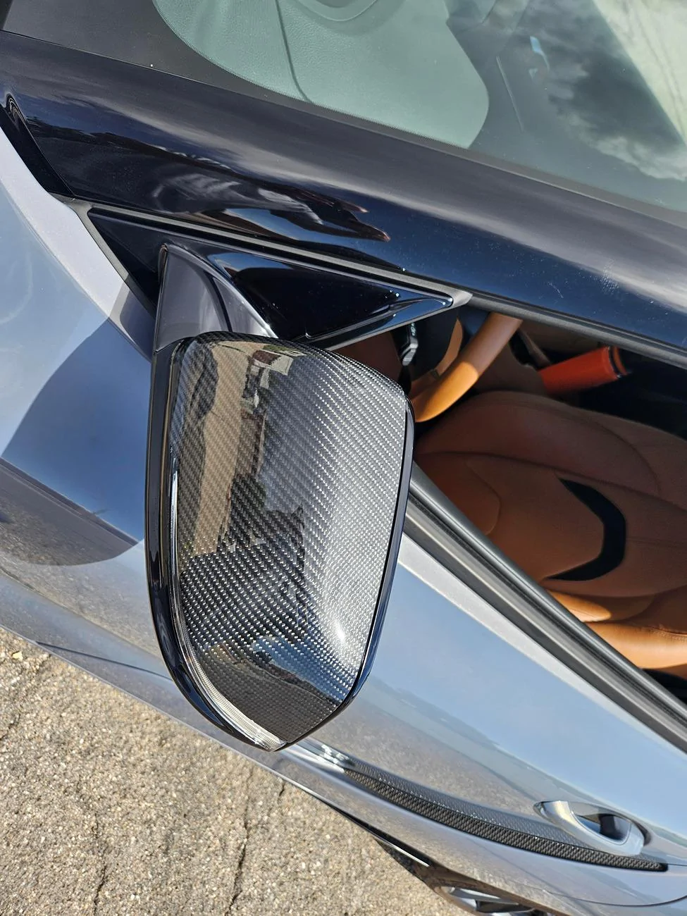

Now that it's all sorted, I'd say i think they're pretty great for $90 bucks and 2 hours of fear.

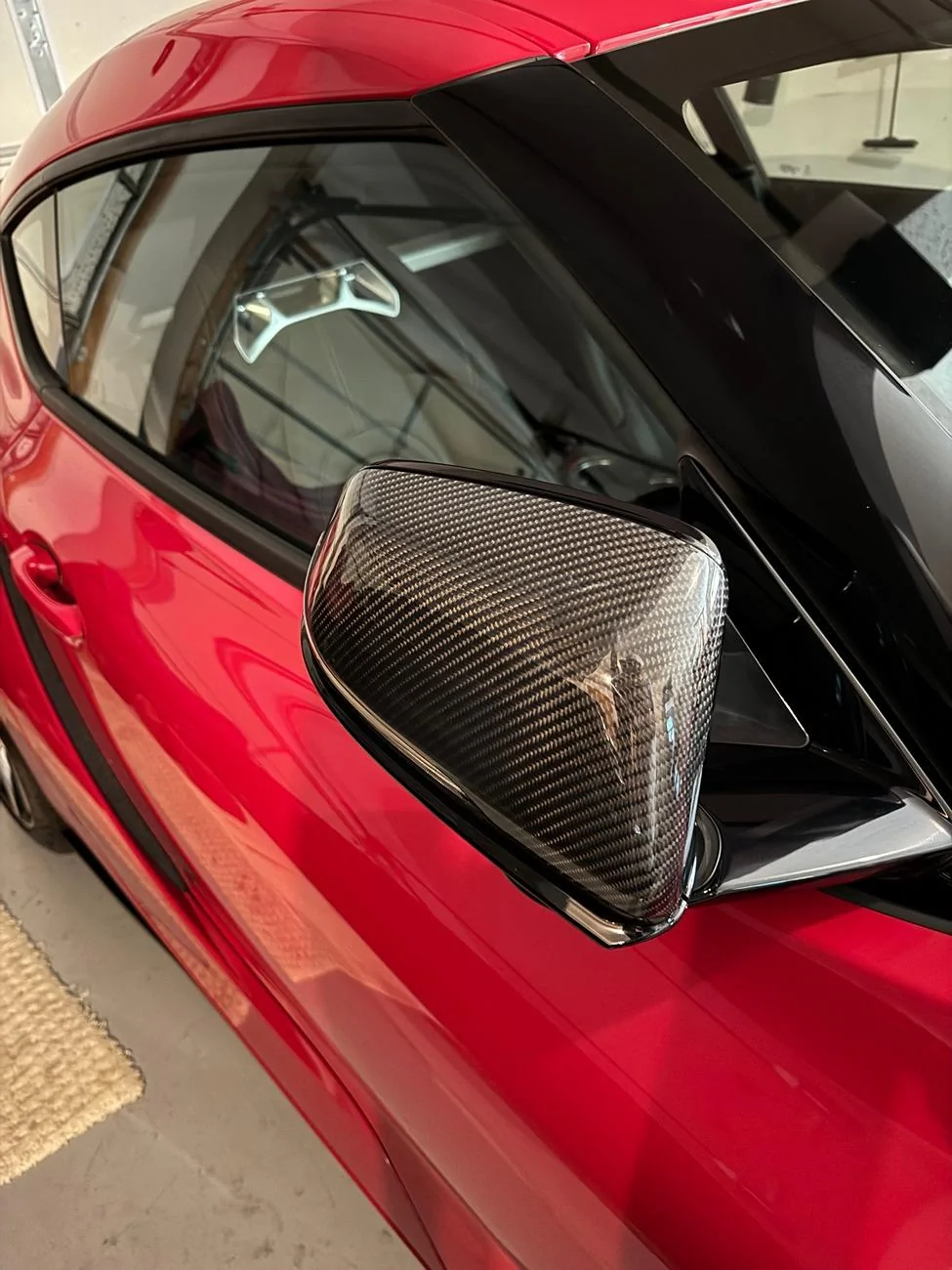

I just purchased these myself and they *do not fit* my supra.. the clips aren't deep enough to click into place, so I'll have to return them and try a different batch... Just a heads up all
They just look like that push like you’re gonna break it ?

While I generally agree that you get what you pay for, I bought carbon mirror cap replacements from AliExpress and they are great. After nearly two years on the car, there's no fade or yellowing and fitment is perfect.
I had some buddies who installed their own themselves and they didn't have any issues, I think I got a bad mold... I have a second set coming in from Amazon and will return whatever doesn't work lol

Turns out the new set which was even more expensive, isn't even fully carbon, and dull edges, they're horrible! Jeez.. anyone recommend another "best mirror cap"? Lol
I got the rexspeed dry carbon mirror caps. Perfect weave perfect fitment zero flaws
