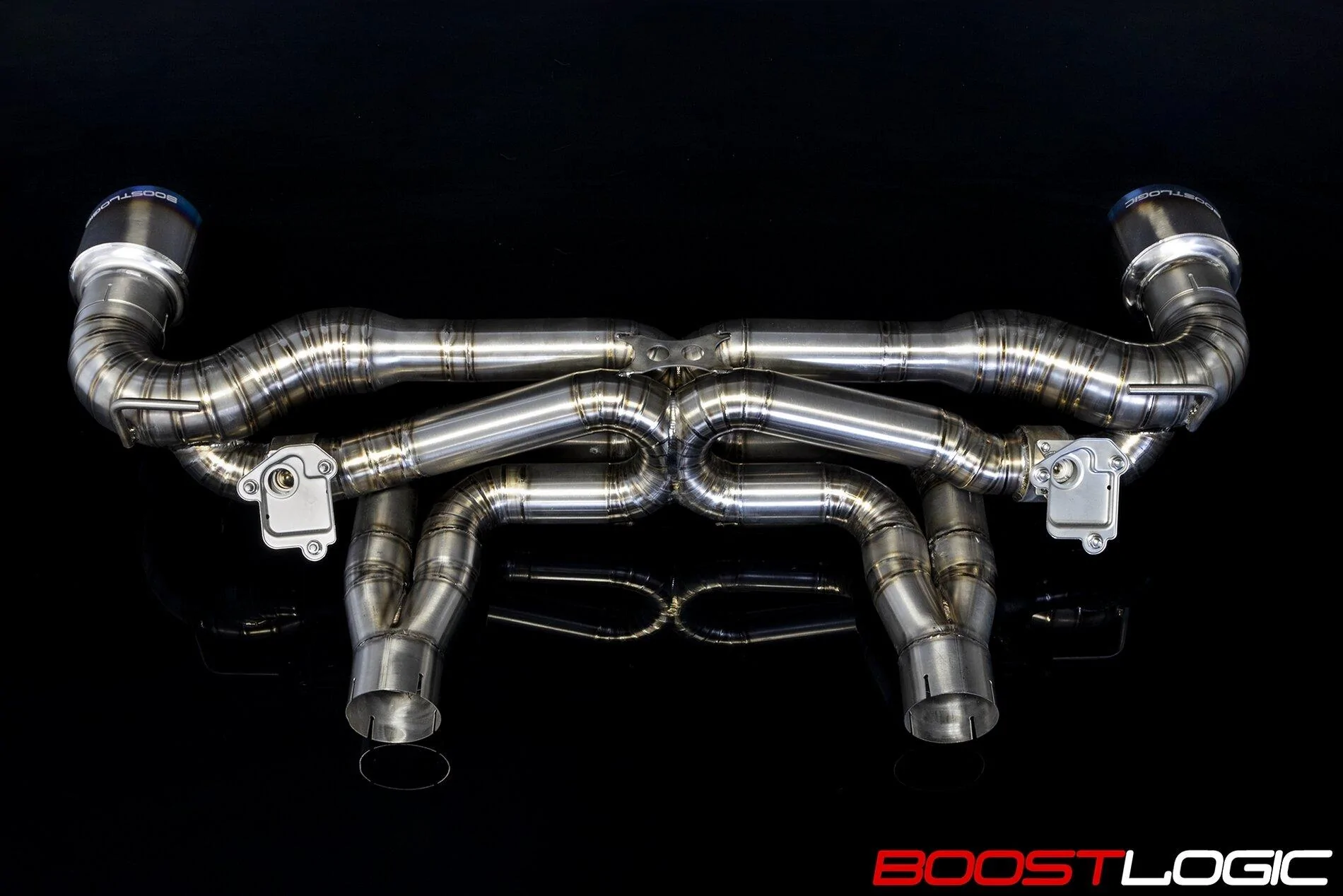

Pulled the trigger, BoostLogic Ti and catless DP
Anyone know why BL catback has valves on both sides?
Getting ECUTEK so should be able to clear the CEL yeah?

One side uses the stock valve, and they've installed a second one on the other side that piggybacks off of the first. At least thats what they told me on the phone. Mine arrives tomorrow! I'm a little afraid it'll be too loud (even with a '21 and a catted dp), but we'll find out soon!

Oh that's interesting though with both valves closed there'd be no flow right? Lol

If you look at the unit right where the midpipe joins in, it immediately splits and 4 parallel pipes run to the end, before merging again right before the tip. So with two closed, two are still open, which may be why some say the valves don't do a ton.

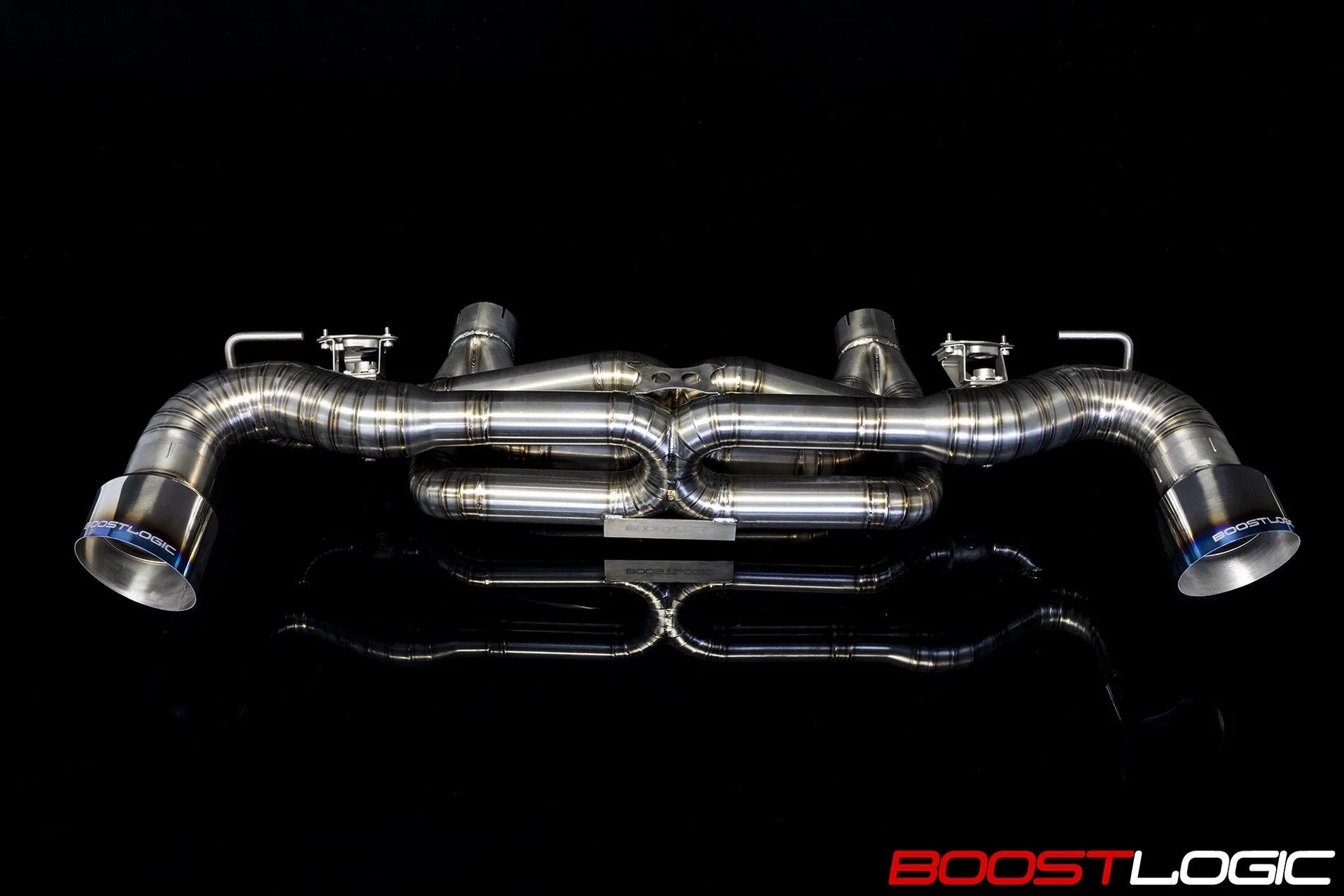

As for the tips, I'm on with the burnt Ti look and they appear to be bolt on tips so surely can be replaced with polished in future at an extra cost. Or anything really since it's probably a standard pipe size

Tip wise I'll install the blue ones, but I'm thinking about having them ceramic (flat black) coated in order to look a little bit less high school. There are also a couple of cases of the tips melting the plastic diffuser, and coating should mitigate that. I believe the tip is single-walled, which exposes the plastic to a fair amount of heat. I also got some shielding I may try to stick to the edge of the diffuser, but that's an experiment, not sure it'll work or look alright.

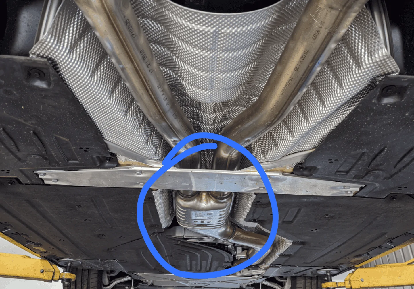

Sorry silly question, I thought this was a cat also but I think I'm realising now the only cat on the exhaust is in the DP right? Lol

Yeah I can imagine the diffuser getting hot cos of how close the tips get, keep us informed of what works well for you. Love the fact that tips can be removed so really can have a lot of options there
Worst case scenario you could always cut and weld the stock tips back on haha

That's just a resonator/stuffed canister, the only cat we have is the one on the downpipe. Your setup with the BL catback and the catless downpipe is gonna be one of the loudest setups you can possibly buy FYI
