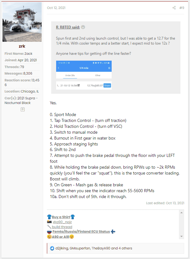

XHP settings for Drag Racing
- Disable 1nd Gear/Always start in second, there's a force option, do that
- Disable kickdown.
- Max RPM, set to your appropriate RPM for engine build/turbo
- Stage 3.
Follow above screenshotted advice.

What are "semi slicks"
- Disable kickdown.
- Stage 3.
Tires like the Toyo R888r, so track tires are referred to as “semi-slick” here in Europe. We don’t have drag radials so it’s about the best it gets here.
