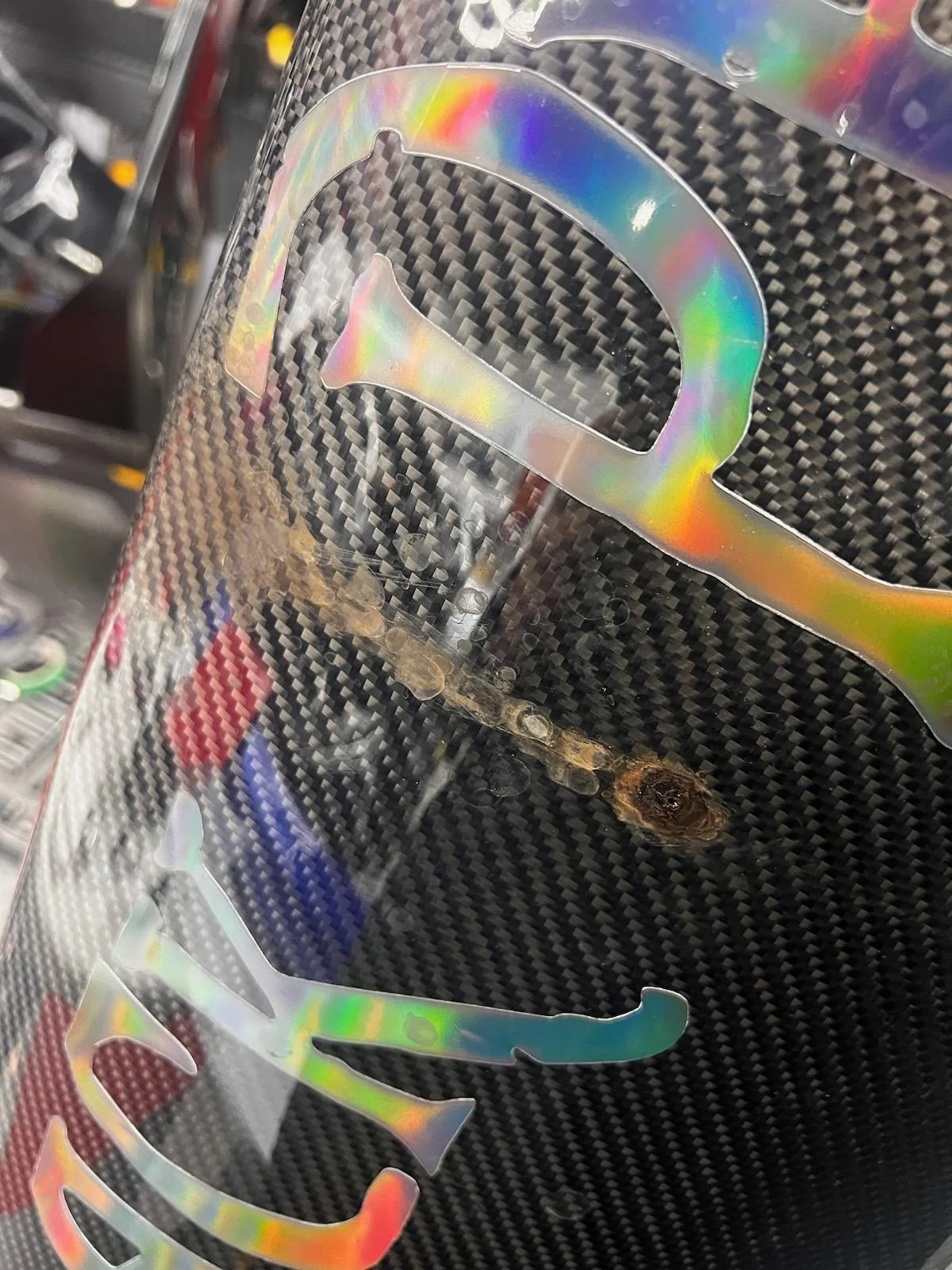

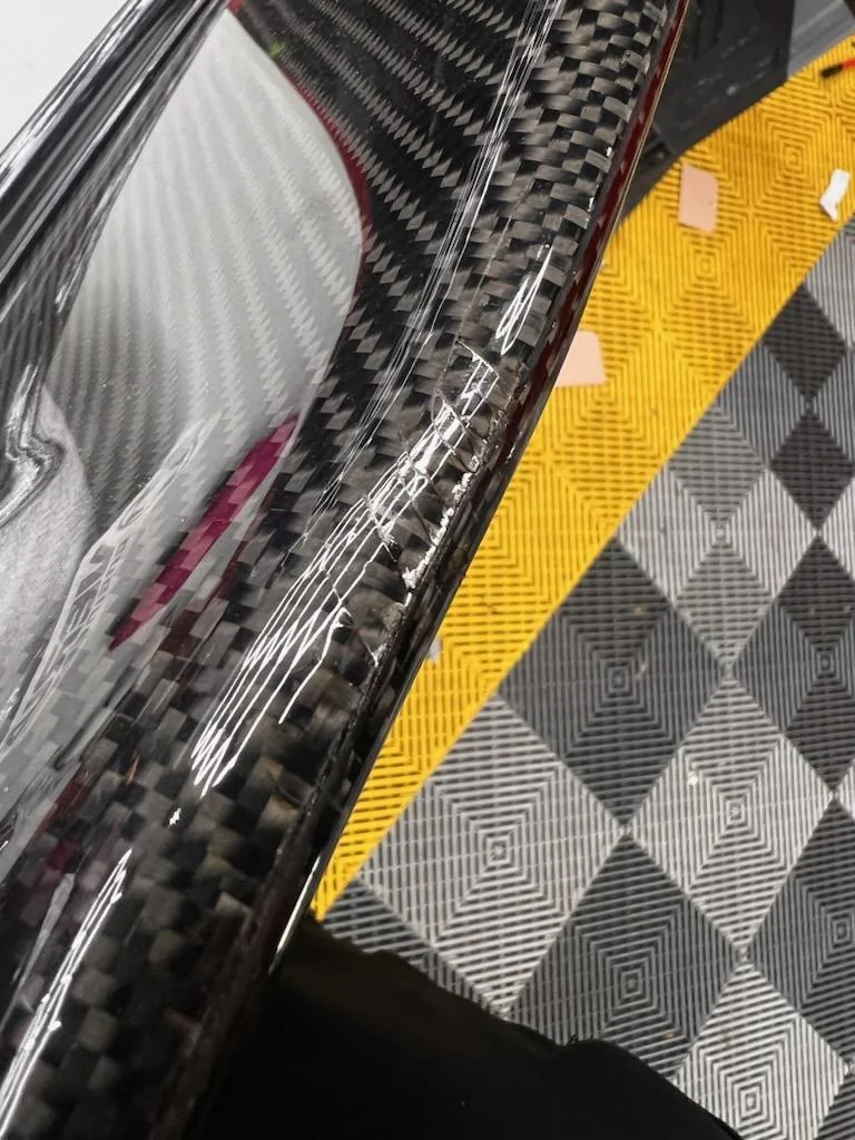

Hi Guys
I recently sent my car to get it wrapped and believe it or not a car that was purchased on 2020 and sleeps inside a garage with only 6029 miles, its Street Hunter wing was spitting rust due to the faulty cheapazz hardware included in the original packaging, the sides rivet/nuts had to be destroyed to remove the spoiler, at least holes are intact, so new hardware would do, but middle carbon piece has cracked due to rust coming from inside on all directions. Now Street Hunter wants to charge 750+ shipping if I want to replace, and thats just insane, specially whhen new spoilers in 2023 are around that price, for that reason considering the swap.. Im thinking maybe some people here changed wings without needing to repair big time the trunk/holes etc after conversion. Anyone has stories/pointers to share on this ?Please look at this pics! No guarantee left on spoiler defects etc, so maybe forced to change this for something with better quality. BTW this wing has been a nightmare since I got it. It didnt fit correctly, shop ended charging me more and plasticg spacers were used to cover for the pos.

Sorry to read your troubles, but expected. Good luck, brotha!

Sorry to hear mate. The Street Hunter wing was the only one I liked the look of but considering the price and the many negative stories I've heard, I'll be staying stock.

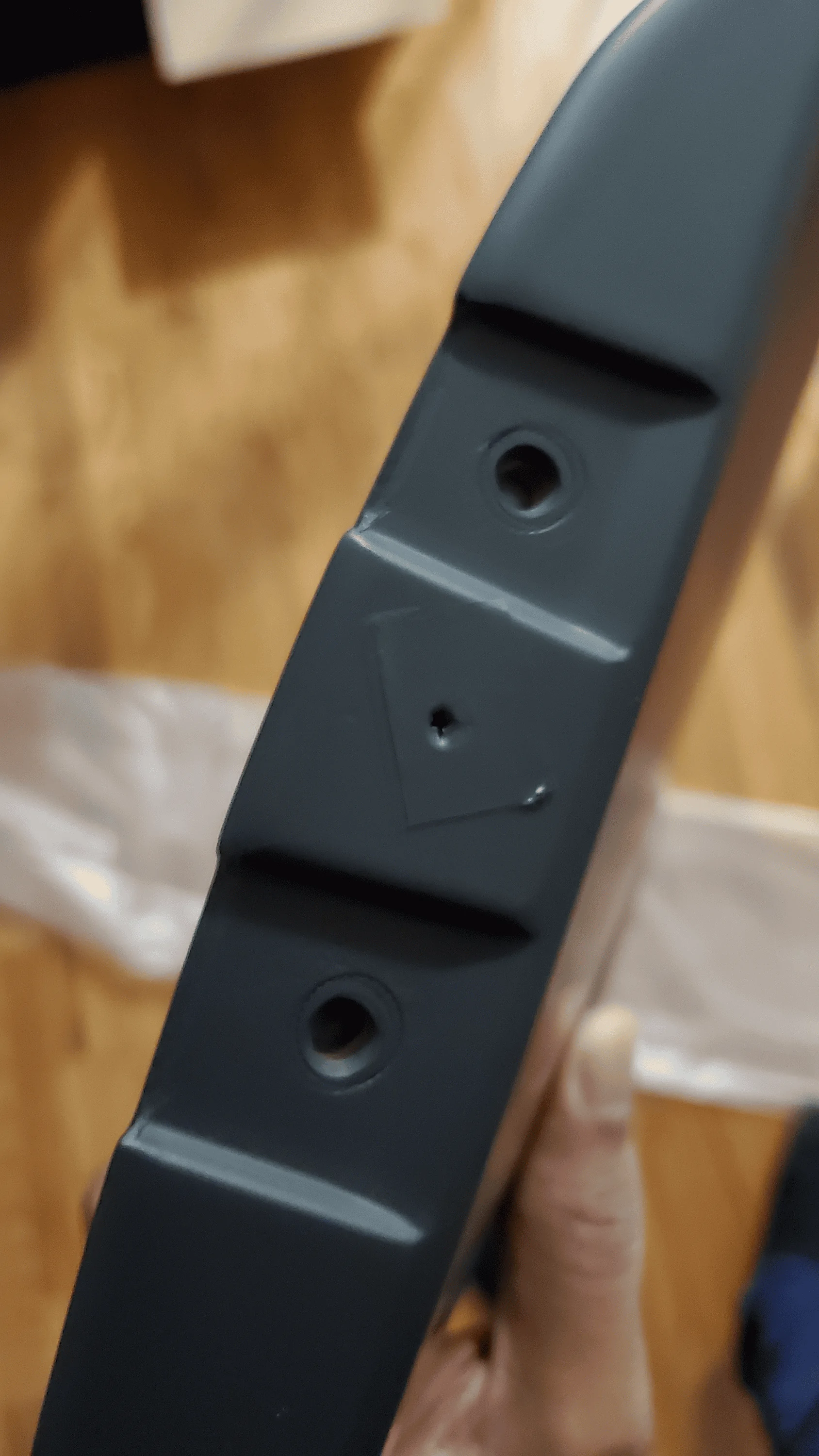

I can confirm that the Extreme Online Store street hunter style wing has pretty much identical mounting points.
Believe it or not the Extreme online store wing has vastly better quality and fitment across the board in every aspect. My body shop guy said the Street Hunter wing was the lowest quality aftermarket wing he had ever worked on and he was appalled
The main issue with the Extreme Online Store wing is that the wing blade is totally hollow and will vibrate at highway speeds unless filled with spray foam. (Ask me how I know)
I actually ended up doing the reverse and going EOS wing to street hunter FRP.
I only slightly modified 1 of the previously drilled holes.

You should mention about posting this up publicly and see if they still want to charge $750 just to replenish some defective parts.
On a diff note, Yiso Carbon makes a ducktail piece that covers the full trunk with a little built-in spoiler on top if you want something more subtle, or i've seen some nice wing options from CMST as well

I got a V1 streethunter wing and it still is the only cracked carbon piece (Cracked in same place as OP) that has arrived here with the worst packaging I've ever seen. Even my carbon fiber diffuser and hood arrived with no damage,.
1 year later in Canadian weather and garage parking, same issue as this post. Hardware is so bad I can't even take it off the car, so I'm waiting on a new wing to arrive.
Was honestly super disappointed when I went to take it off for a re-wrap.

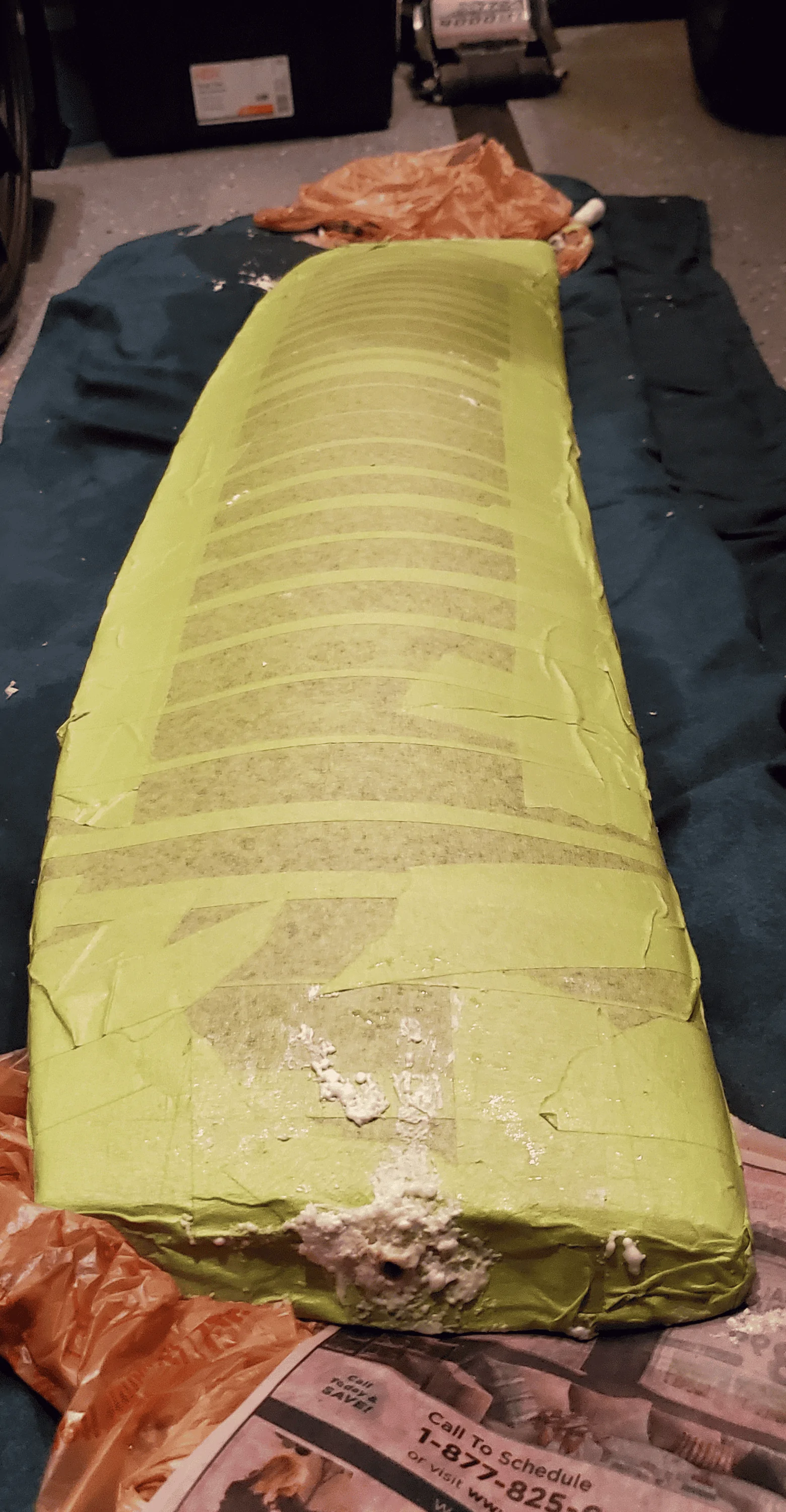

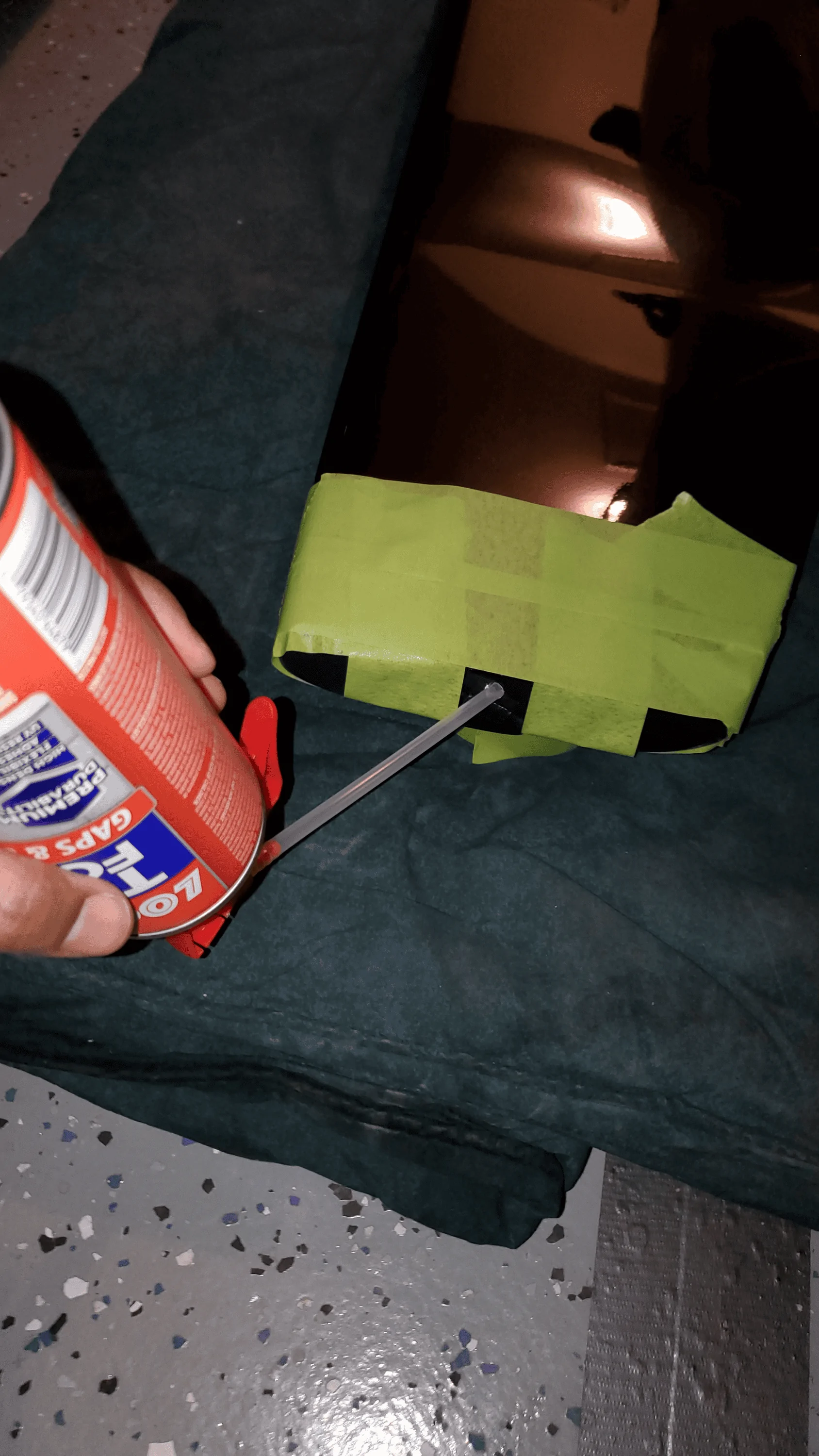

Hey dude,
In my case it ended in disaster twice. (I bought 2 wings)
The EOS wing already has holes on either side. They're covered with tape but if you take the tape off they make a perfect hole on both sizes for a spray foam nozzle. I used Loctite Titefoam small gap filler. (this expands less)
The problem is that spray foam needs air and moisture to cure, that's why there is a warning on the can not to use in closed cavities with no flow.
As a result, the foam never really cured on the first wing and stayed liquid for days.
Trying to learn from the mistake, I added a small amount of water to the wing blade and the foam instantly started to cure and expand even more. So much so that the wing turned into a sausage. 🤣
Straight up sausage
...This obviously ruined the wing blade.
Learning from that attempt, I bought another wing and attempted to right my mistakes.
Unfortunately, although the second attempt was way better, there were still places where the wing was lumpy after the foam cured. I even attempted to drill a center hole to more evenly distribute the foam but that didn't help much.
I could only really tell the wing was filled in by squeezing along the length of the wing. Some parts were rock solid and filled in. Others were still hollow. Generally speaking though, you could significantly reduce the flex or vibration by just filling in either side where it contact the wing bases.
Either way, I wasn't happy with the results so I cut my losses.
Meaty wing with a side of lumps
To answer your question, yes, I think spray foam can resolve the flex issue since in an enclosed space it can become rock solid if you use closed cell foam. BUT the real question is if you're willing to go through the mess and the trouble of doing it.

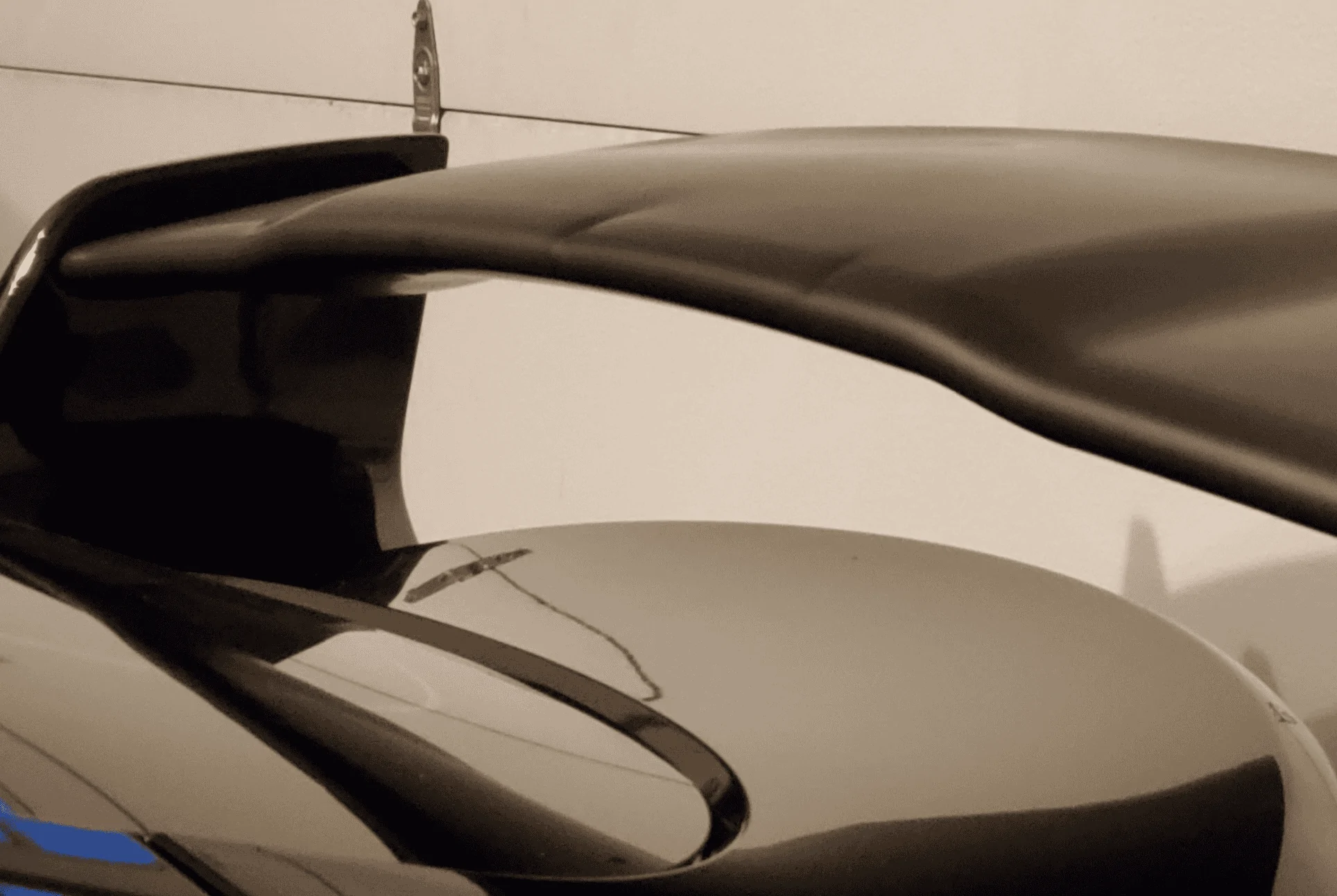

If you go with the Street Hunter wing, I would only go for the carbon fiber one. My FRP one cracked within 3 months of having it on the car. My car is never outside and I only drive a couple of times a month so it wasn't caused by elements.

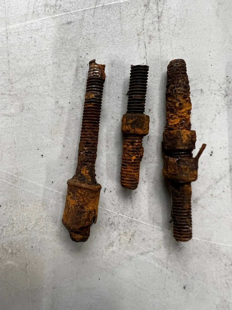

Similar to the OP, when I went to replace the wing, all the hardware had already rusted and I ended up having to extract and hacksaw all of the bolts off. I documented that on IG and can send if you're interested. It took me a week...
