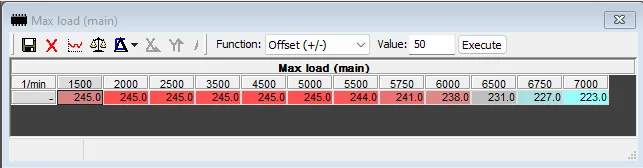

You still have 131072 code, which is closing the throttle down to 41%.
What are your Maximum Relative Filling Characteristic table values? and check if you are limited by other load limiter tables.
You might want to look at all load limiters, which I believe are 10 tables (some are already maxed out at 327%), and add 50 over stock values to get to 245% load. This should get you to 26psi more or less, and you can then fine tune it later based on your boost curve.

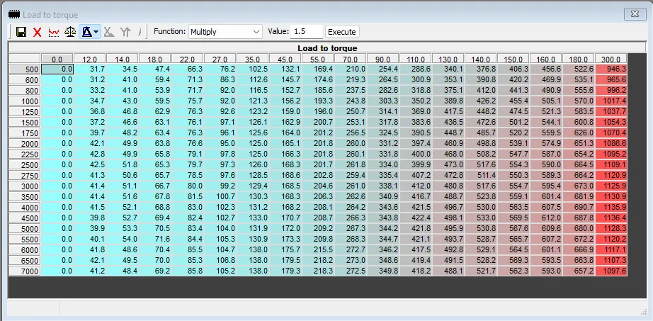

For load to torque, I only changed the last column from 200 to 300 and multiplied the values by 50%, this will make it easier to track limiters later.

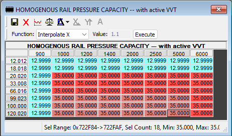

You are also crashing your hpfp at 5000rpm and probably in the lower rpm, there are 4 rail pressure tables that look similar to the one below. Change the highlighted cells to 30MPA and then you can continue to fine tune the rail pressure as you continue to raise boost and adjust afr.
Your boost target is 25-23 psi, but the actual boost is 16 psi because your throttle is closing. This needs to be fixed before we try to raise the target further.

I made those changes to all the torque tables you mentioned and read through the bootmod3 guides. Raised all the limiters to 1000nm and disabled all the torque flags/intervention. Is there one i shouldnt have disabled?

Don't just increase the last column in the load to torque table. Great way to get transmission slip if you are making any power.
Whats your guidance on the scaling of the load to torque table when upgrading a turbo? Obviously hard to know exactly what torque the car makes at MBT even with a dyno, since we don't run at MBT.
Even on stock turbo, dyno results are ~100nm > than what the log shows when only the last column is increased.

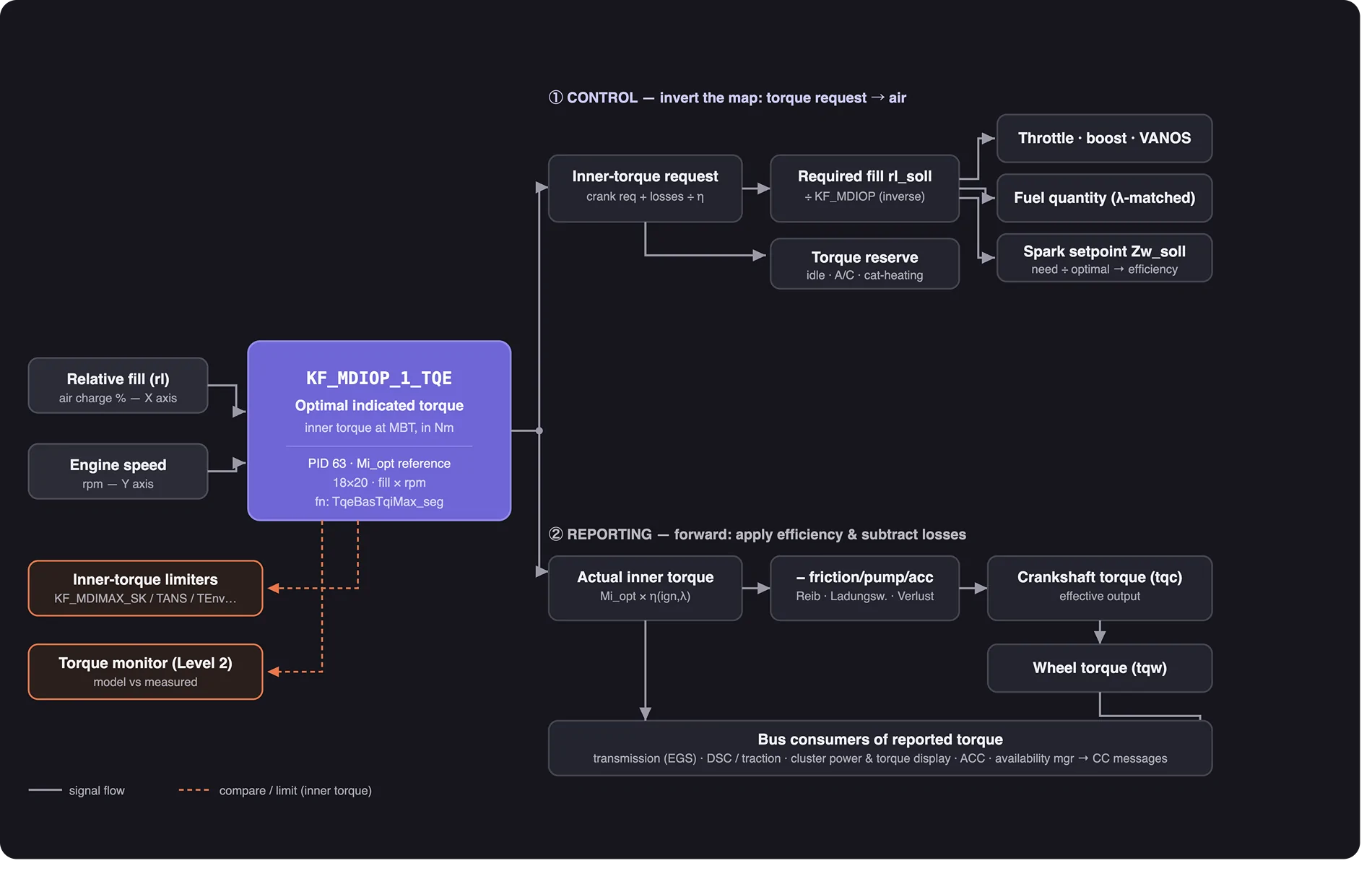

The load to torque table Z values are inner indicated torque, in Nm.
Inner torque is the gross torque produced by combustion inside the cylinders: the torque the expanding gas exerts on the pistons, before any mechanical or pumping losses are subtracted. It's a pure thermodynamic/combustion quantity.
This is different than crankshaft torque. The difference between crankshaft torque and inner torque are the losses. Kind of like the loss differences between crankshaft torque and wheel torque. The DME subtracts from the inner indicated torque values, losses from friction, pumping, aux/accessory loads, and drag = crankshaft torque. So inner torque will always be higher than crankshaft torque.
It gets even more complicated as there is also a step within inner torque: the optimal inner torque (at best/reference spark, MBT) versus the actual inner torque after spark and lambda efficiency.
The torque to load table (KF_MDIOP_1_TQE) values matter a lot in the system because it's basically the modeling for all air flow. They are the best-spark inner torque the given air charge would produce. The DME then multiplies this by ignition and lambda efficiency to get actual inner torque, and subtracts friction/pumping/accessory losses to arrive at the crank torque. It's the air-charge-torque model:
  • Forward, it turns your measured fill + rpm into the reference inner torque used everywhere downstream (reporting, limiter comparisons, reserve calculation).
  • Inverted, it turns a required inner torque back into the fill target the boost/throttle controllers chase. Every torque request becomes a fill target through this map. Boost controllers less so when using MHD+.
All that is why it's important to scale with added power. The TCU uses reported values to help determine clamp pressure, along with a ton of other models.
I'm not actually sure which torque channel MHD has for it's torque logging. I'm going to assume it's either requested torque or crankshaft torque. There are a few different torque channels that the DME reports out:
  • Inner (indicated) torque — combustion torque before losses.
  • Crankshaft (effective) torque — the real output torque after friction/pumping/accessory losses.
  • Wheel torque — crank torque multiplied through the gearbox and final drive, minus driveline losses.
Thanks for the explanation. Yeah I have only ever scaled up the final column, I thought you had written that in the self tune thread, but its definitely underrating the tq.
Do you recommend scaling the entire z axis evenly, staying relatively linear?

Here is a visual diagram, created from the official BMW SwCalDocs, that shows what KF_MDIOP_1_TQE influences. Clearly showing that the TCU is a consumer.
OBD PID for the reference torque coming out of KF_MDIOP_1_TQE: PID 63 (Nm)
Other noteworthy PID's:
61 — driver's demand engine torque (%)
62 — actual engine torque (%)
63 — engine reference torque (Nm) referenced above
64 — engine percent torque data (idle + points)
The PID's that report in % (61 and 62) are a percentage of the Nm reported from PID 63
So 61-64 are all reference torque.
Just remember that normal OBD PID's are slow-as-molasses.
