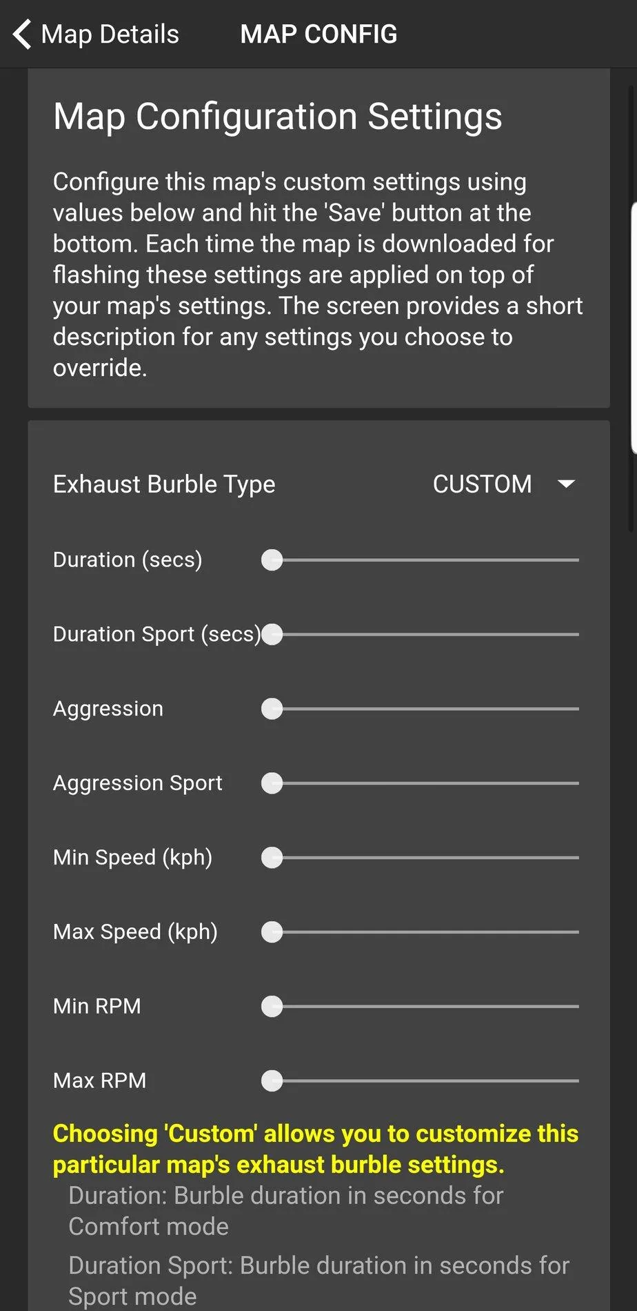

Just some online picture I found, which shows the BM3 config below:
Where you see word "Sport" that's sports mode and the other is for "Comfort" mode.
You can use this when you're sending the Tune to the vehicle.
If you don't know how to get this screen, please refer to BM3 online manual.
You're not supposed to use diagnostic screen to alter these... (you can, but it's not permanent)
To answer your question, yes what you're looking for is possible with BM3, or any other tuner.
But of course, first make sure it actually works for you..

Those setting only changes the burble though. Below that it has flap preferences but only for sports mode.
The diagnostic open/close/auto was more to test if it actually changes the position.
I suppose I should find a tuner and ask what their experiences are.
