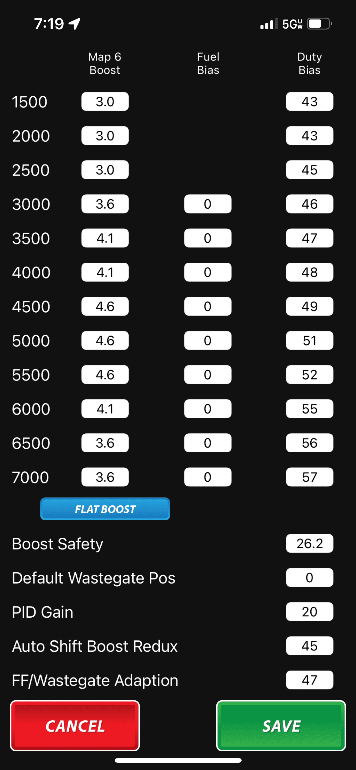

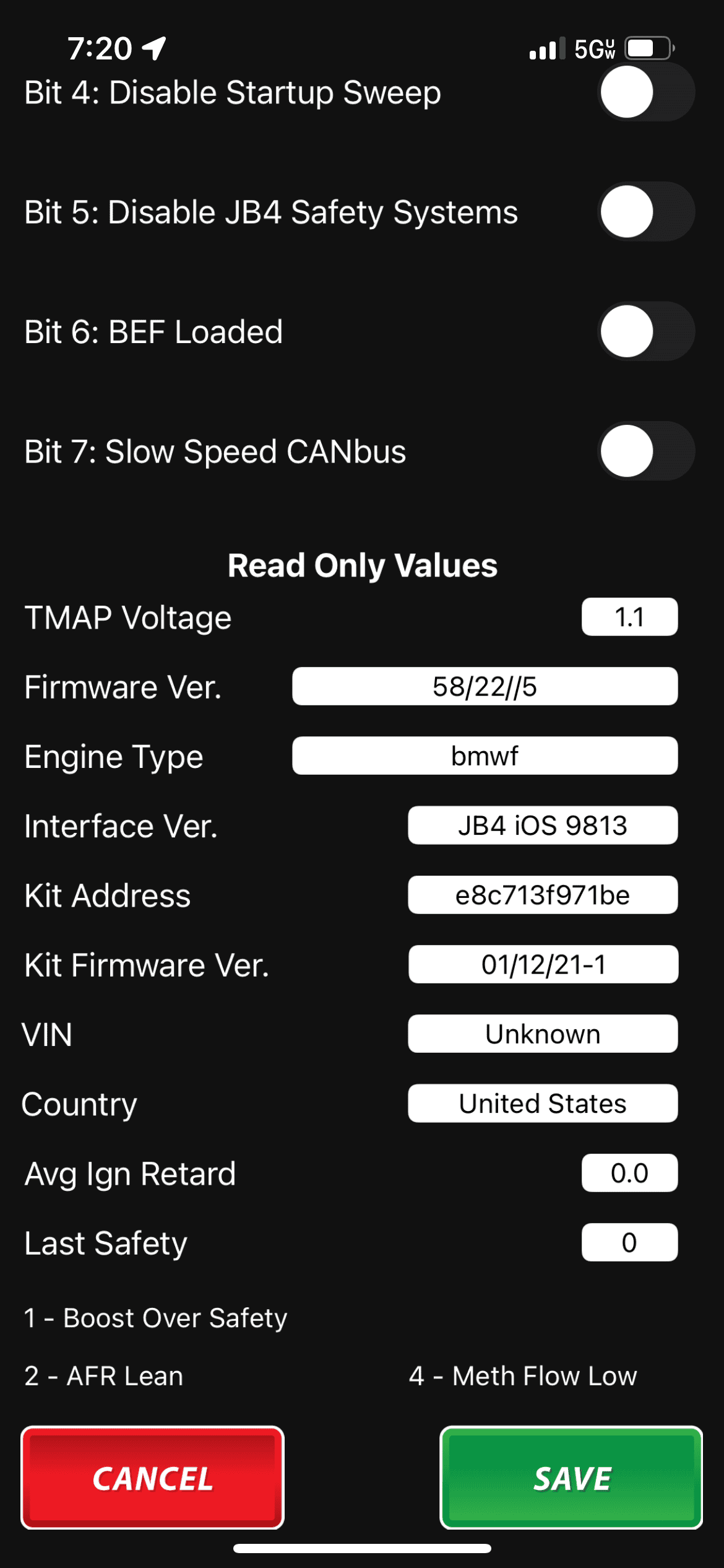

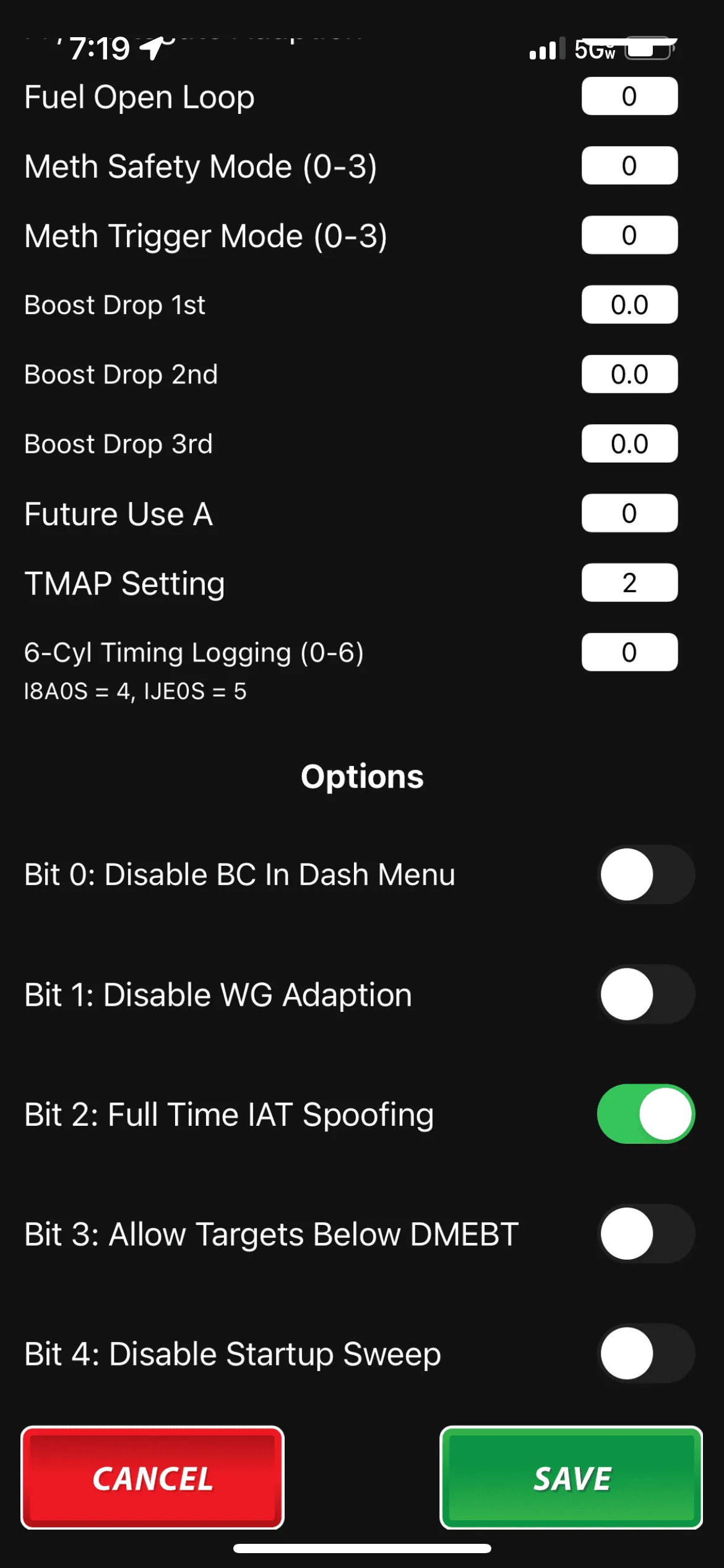

I bought a used JB4 with EWG and Bluetooth some time back and have kept it on Map 2 the entire time I have owned it. I have updated the firmware a coupleof times, but that’s about it. Today as I was updating the firmware, I started looking around in the settings and noticed that it looks quite a bit different than the defaults listed on the JB4Tech site. On their site, almost everything is set to 0 and some of the other settings aren’t listed. Can some of you guys that have defaults on your JB4s screenshot your settings and share them so I can see what your defaults are? Mine are listed below:

Set everything to default. There are defaults on the BMS forums.
I have changed everything to zeros like the site has, but there are settings missing, like TMAP Setting, PID Gain, etc.

Did you purchase this JB4 from someone with a Supra Mk5 ... and was it a 2020 or 2021 model?
The JB4 will detect the correct TMap ( 1 OR 2 ) .. if you change it you will probably get an error and it will change it back.
Default PID gain is 20
