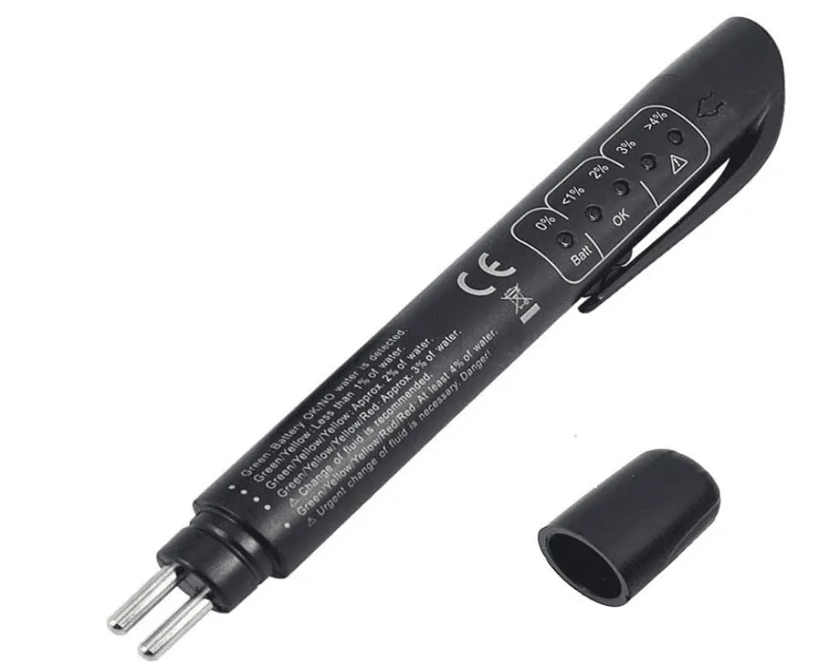

Hi Marcus ... sounds like you've boiled the brake fluid .... any water in the lines will steam off and cause this .... i would bleed of some from,at least front brakes, to be safe. use a water check tool to ensure <1% water in lines ... preferably none.
ive had this many times on runway days and speak from experience.
BTW your spoiler and front splitter are still on my car.
I have one of these and have checked their calibration and they are accurate. Well mine is anyway.
