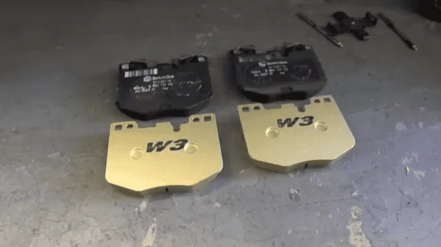

Trying to swap pads but I never experienced such difficulty on any car getting an OEM pad out. Anyone have any step by step instructions? pics or vids would help. Another reason why I always opt for Aftermarket BBK on any of my cars but this one, simple unclip... old pad out and new pad in....less than 5 min per side if that.
I ordered from Carbotech (Silver) and comparing...... clearly you can see they are different from anything else.

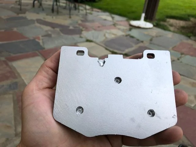

The backing plate is glued on to the brake piston from the factory. Just use a pry bar and pry hard. You can't break anything. Might help to put a towel between your pry surface so you don't scratch the caliper.

I found everything pretty simple except the pad removal, but once you know about the adhesive and get the first one out, the rest Is easy.
Tap back the 2 pins, remove the retaining clip and then remove pads. For the rear, you have to rotate the piston before pushing it back in.
As others have said...try to push back the piston with a prybar to give you more space to wiggle (wrangle) the stock pad out. Any pad swaps after that should be pretty painless
