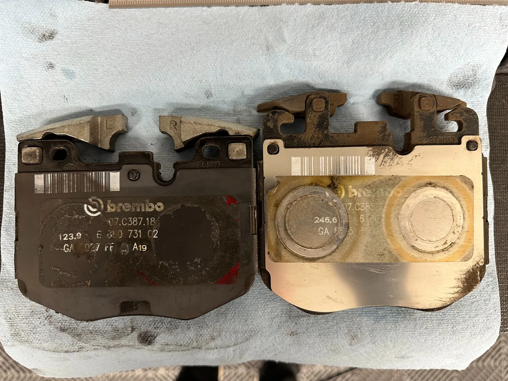

Were the ds2500s provided in brembo big brake kits? I remember using the supplied pads of brembo kit for some light track duty and they were suprising great on street and held up at Tremblant mid summer intense heat after a set of Pagid yellows were finished.
I’d like a pad 30% more capable than the stock oem pads - though they’ve been surprisingly good for spirited driving! Not sure who makes the supra oem pad.
There are anecdotes about several OEM's using pads that were very similar to the DS2500, and lots of stories about people able to use OEM pads to get through a session or two as well.
As mentioned, Brembo makes the OEM Supra pad. They've had some pretty good compounds lately since I know the C8 also runs Brembo pads from the factory, and those work fine on track.
