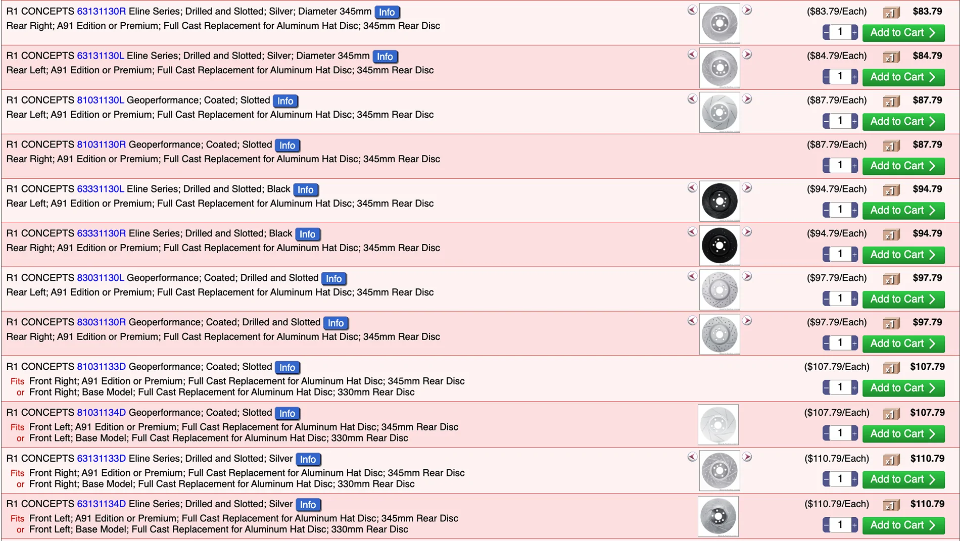

I just swapped for R1 concepts slotted/drilled rotors and hawk ceramic brake pads and love it. No dust better performance and look good to boot.

Do you have a purchase link for the R1 rotors?

Costs me $150 a pair of front rotors and last the same, if not longer than OEM and perform the same on track. No brainer for me. Rotors are consumables.

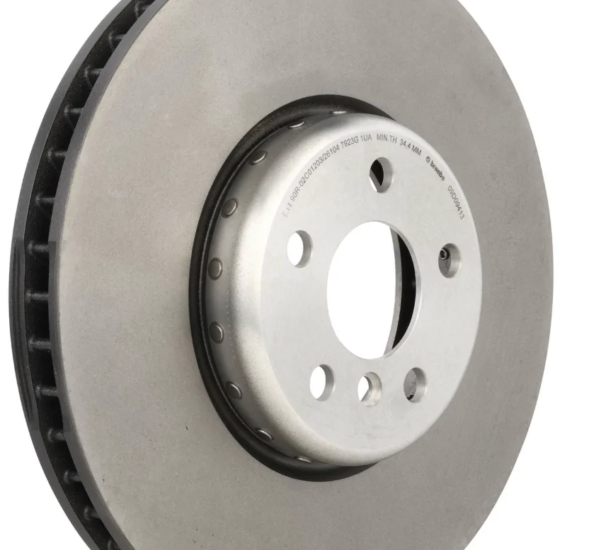

The OEM rotors aren't actually 2-piece. They look like it, but are one continuous piece. I believe some trims of the Z4 have 2-piece rotors, however. The fact that OEM rotors from Toyota dealer sites are $200 or less a piece is further evidence they aren't real 2-piece units.
Aftermarket 2-Piece rotors for the Supra run about $1700-$2200 for a set of 4 if you don't go Alibaba. Unless you're semi-pro or positively dead-serious about time trials, buying 2-piece rotors doesn't make sense for track folk due to how many rotors you'll go through.

They aren't floating 2-piece but they are 2 piece. The hat is aluminum pressed onto the iron rotor.
Ah, that must be what I was seeing while i was researching rotors this week (due for a replacement myself); if that's the case then my bad @kaj !
