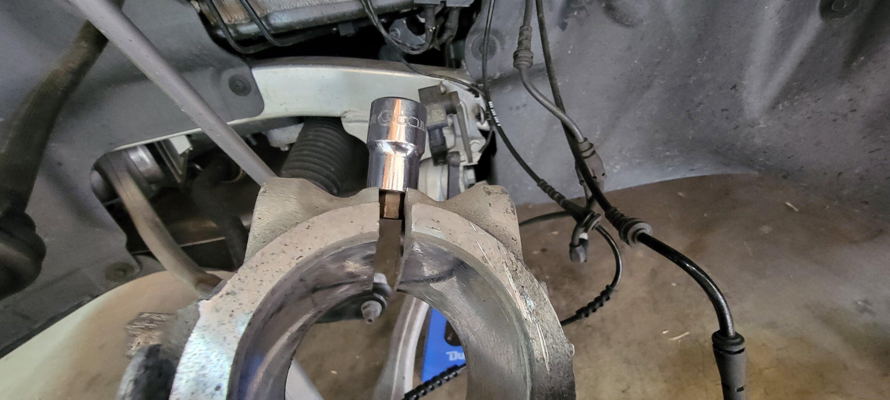

It was pretty straight forward. The only hard part was getting the knuckles to spread to get the OEM shocks out. Word if advice though, Ohlins doesn’t specify which spring goes in the front vs the rear. USUALLY the thicker ones would go in the front. Not in this case.

To spread them (next time obviously), use an Allen wrench. Get one that just fits in the gap, twist it a bit and it should stay there with it open.

I have the tool for it (https://www.amazon.com/dp/B08M6GHM93/ref=cm_sw_r_api_i_64ZPB70G7PT6NAKWDQ0G_0?_encoding=UTF8&psc=1) but it wasn’t spreading it enough. Ended up using 2 7 or 8mm Allen’s to get them spread. Something like this would have been better though. https://www.amazon.com/dp/B0B1PGN7N7/ref=cm_sw_r_api_i_DKSWYWGG1DY8Z8XKKPJW_0
