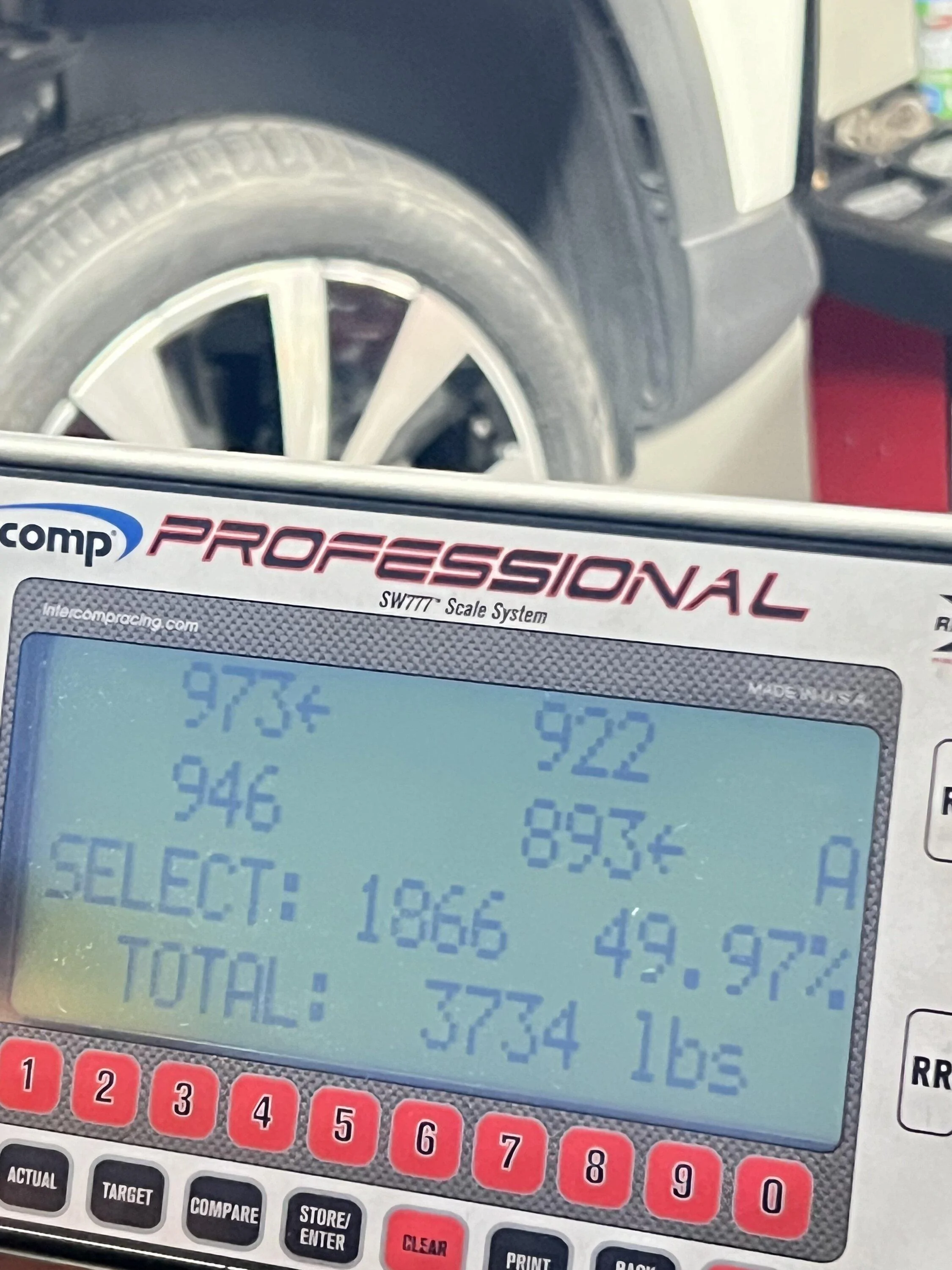

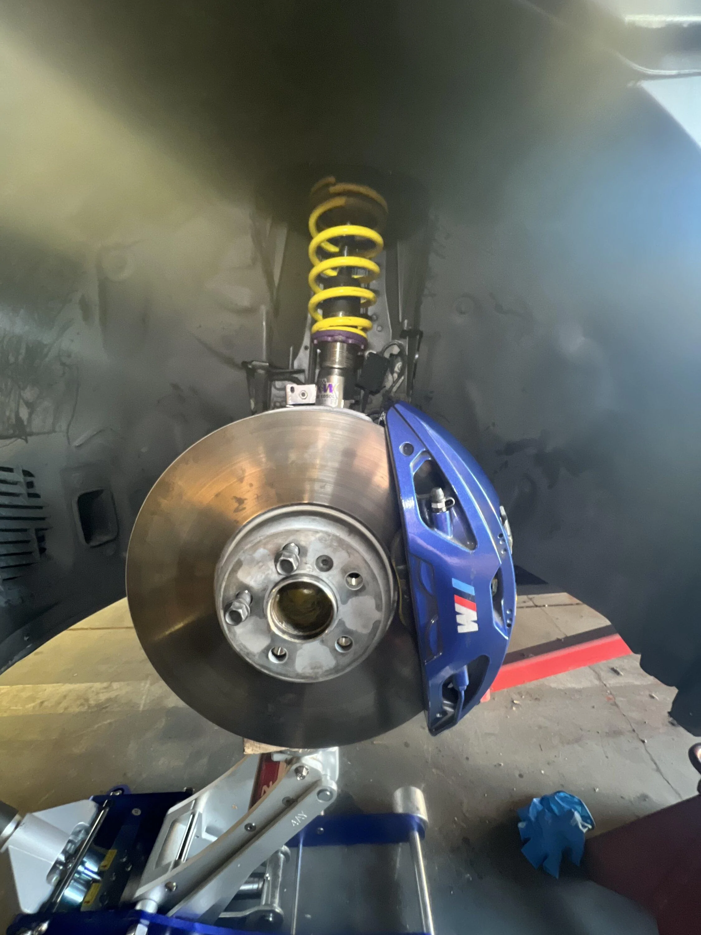

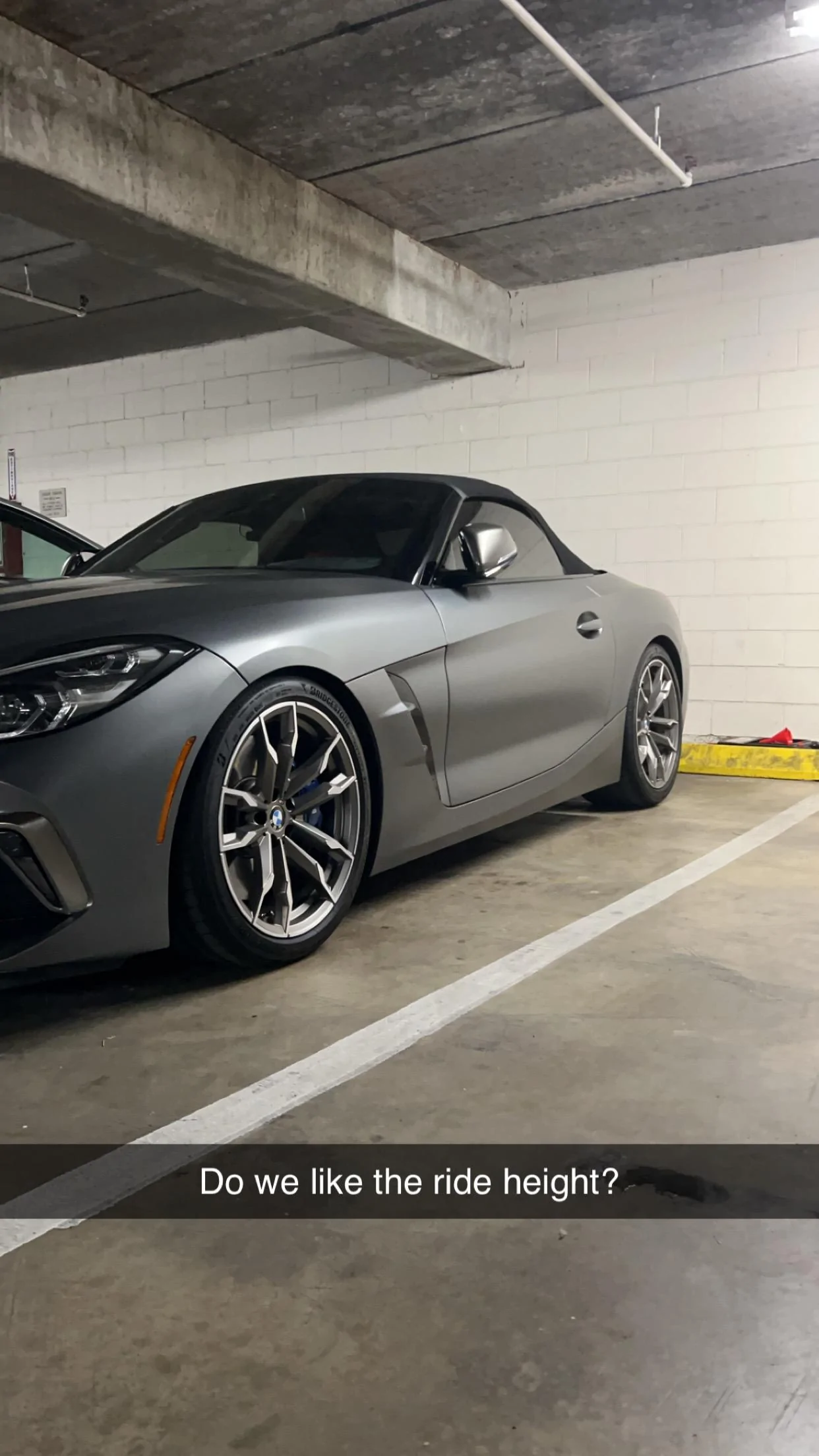

Also installed these coil overs about two weeks ago. Give some time to let the springs settle as I dropped about another 1/2”.
across the board I felt all drive modes to be more firm, where comfort was about a half step below sport mode with stock suspension.
Agreed- this was the best upgrade I’ve done for the car. The z4 was a little bit more plush stock than the Supra, but both have very capable stock suspension.
Also running a little bit of positive rake (about 3/4” height difference front and back) and did a corner balance. If the baseline suspension as neutral/flat steering, the slight positive rake added a little bit more response.
