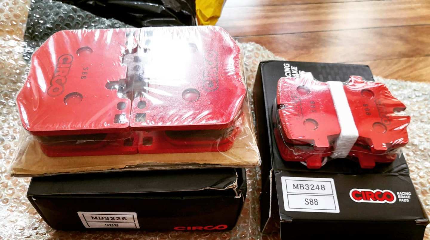

Hi Jeff, I like that approach; upgraded front caliper + rotor + pad, and only rear pad. Do you think the rear rotor is worth upgrading?
I've been keeping an eye on your Radi-CAL offering for the Supra and am very keen.
In the meantime, I'm just upgrading pads to the Circo S88 - lower dust, higher performance version of the Winmax W3.
Some people value the rear disc looking the same as the front, so we are offering an OEM rear disc with the J Hook slot pattern. If the aesthetics are important to you, then that is a good option.
That said, if you're focused mainly on performance (which it sounds like you are), I would just run the stock rear discs...beat them up until they wear out!
Circo makes quality pads.
