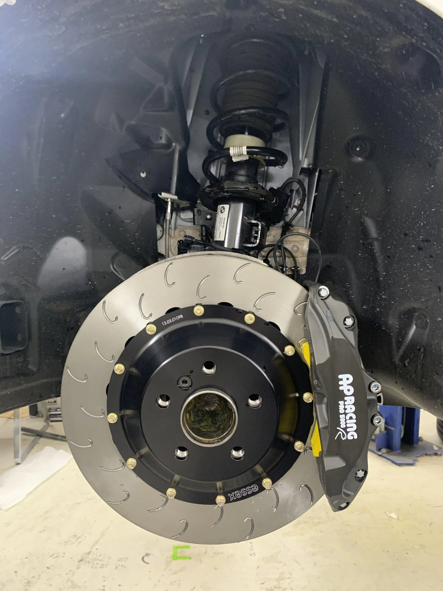

I went with the AP Racing front and rear from Essex. Gave up the parking brake, removed the actuater and then secured them so no parking brake light. Ferodo pads. The car finally feels connected and there is linear brake feel. I felt that the stock brakes gave really strong braking but as you eased off the brake when trail braking, there was a point that the rear brakes suddenly seemed to engage. Didn't upset the car but it did make for more slowing than necessary. No issue with the AP racing setup, firm pedal with great feel and the feel remains linear as you trail brake and ease off the brake. Cannot recommend it enough.
Apologies for bringing this back from the dead... but @jorligan I'm curious what pad compound did you go with for the AP kit?

Ferodo DS 3.12
