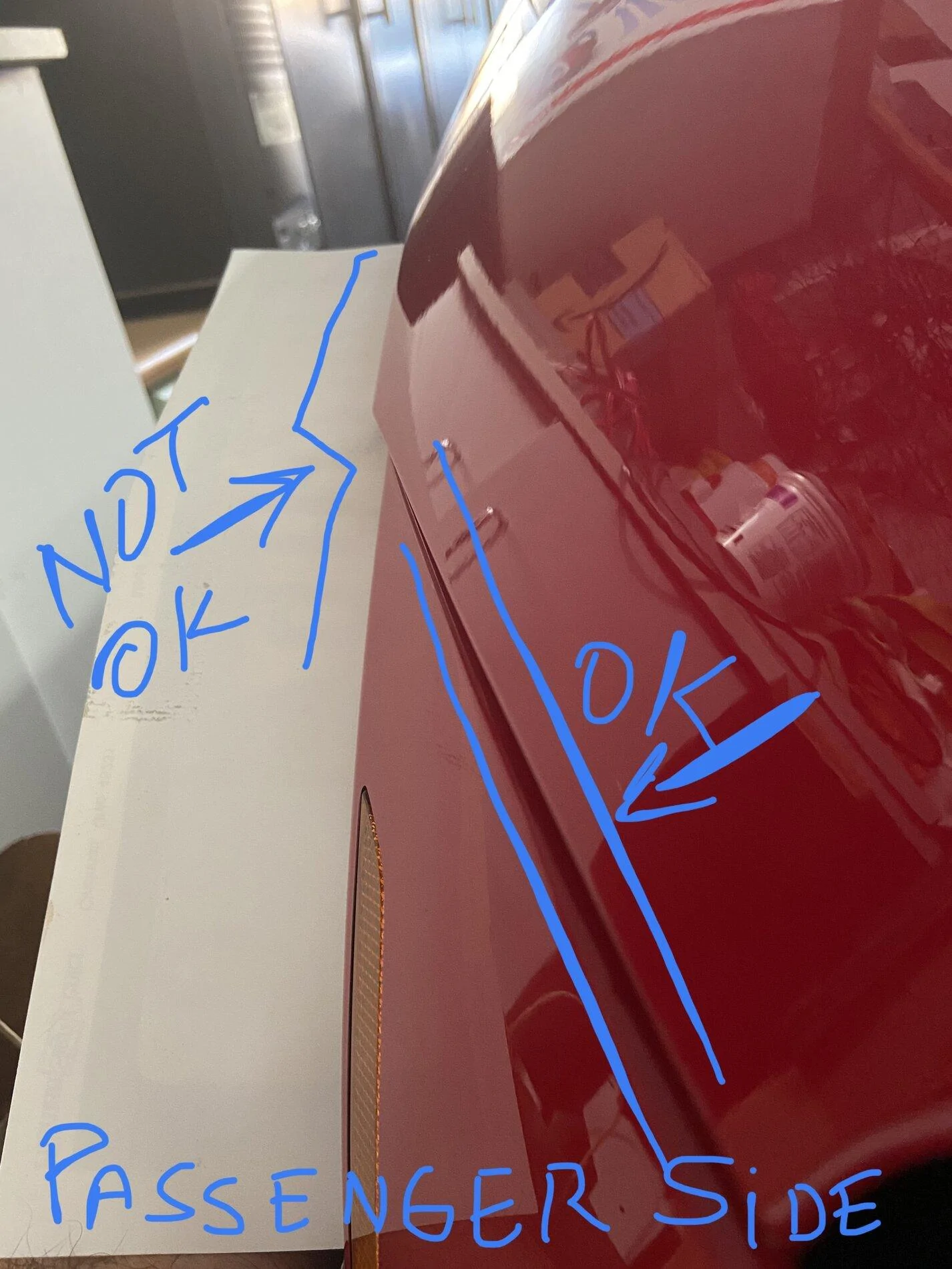

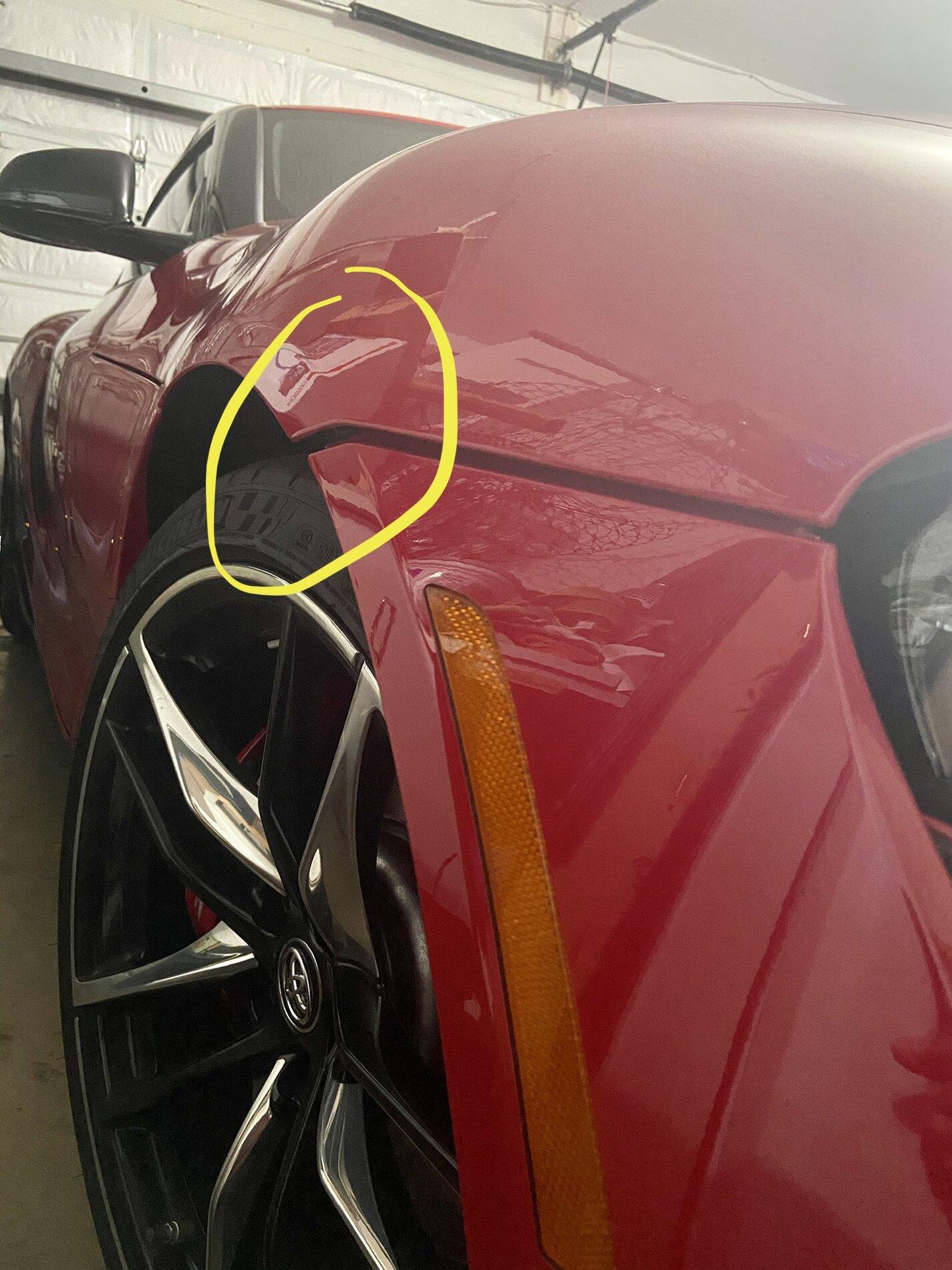

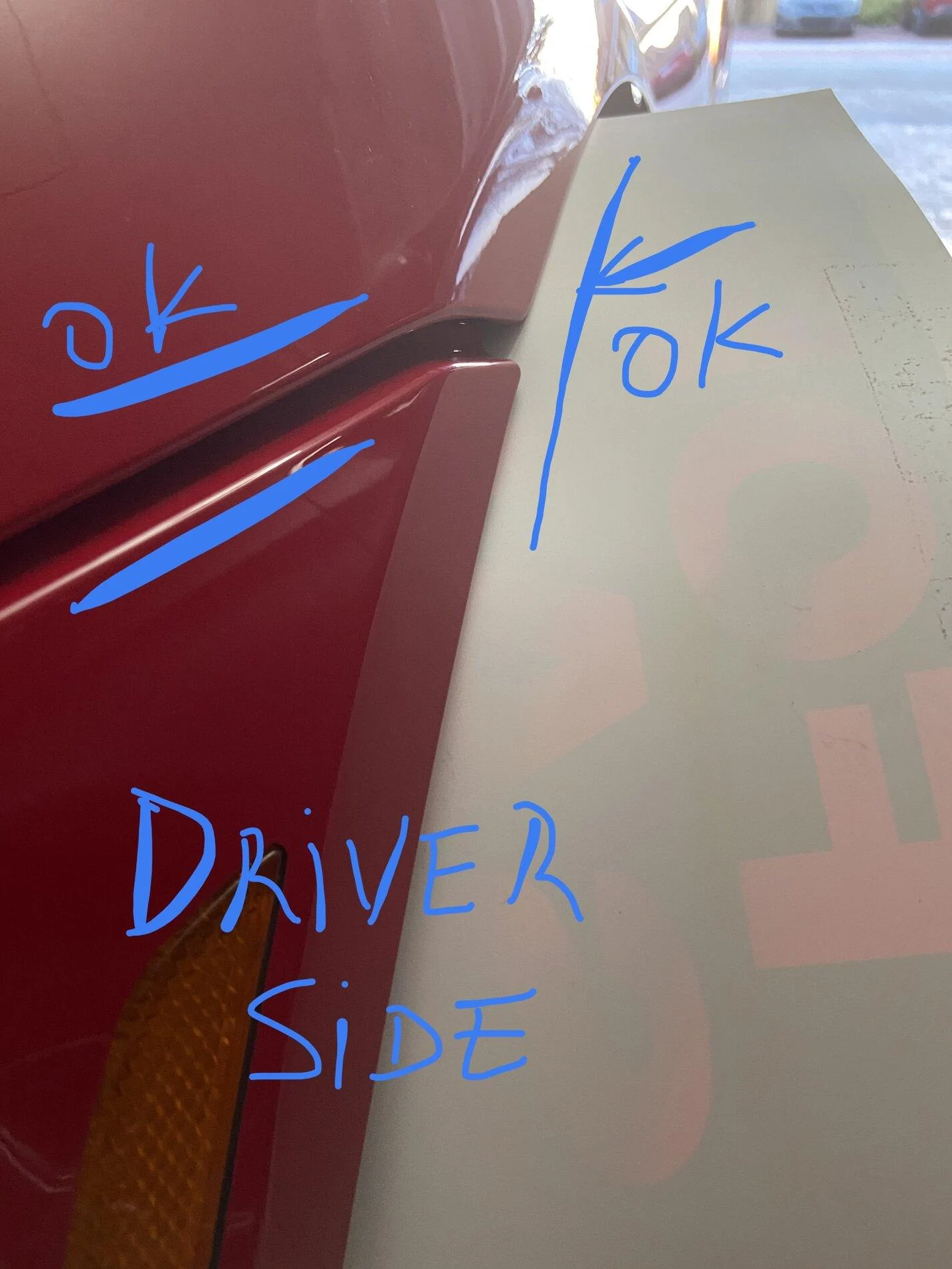

Noticed my passenger side bumper is not lining up correctly as compared with the driver side that looks ok. Its hard to notice in the pic but when you look down you can see the bumper is definitely in deeper than the hood. I feel like I can pull it out to line up but it doesn't stay.
The hood has an adjustment on the latch, but thats only up/down level. Anyone have this issue or a fix? The dealer wants to take it to a body shop and I said forget that. I'll just live with it. But thought I'd post issue to see if anyone has similar problem.

Nope. I know what you mean but it’s not a up/down hood issue or fix. The bumper is in too deep on that corner. I Can flex it out but no way it’s gonna stay there. I have opened and close hood many times. Not the fix. I’m thinking a clip or something is not aligned correctly.
