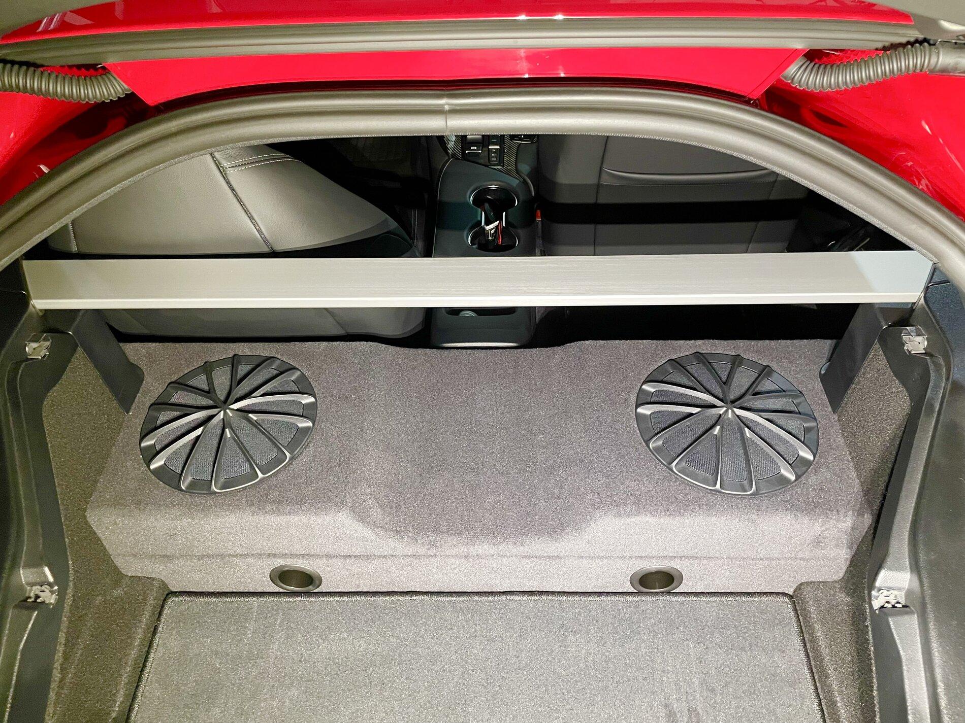

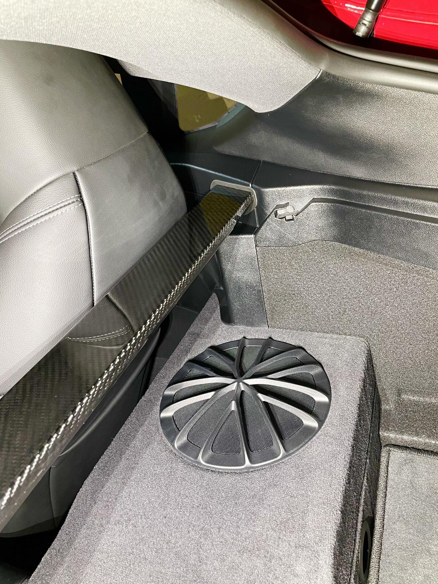

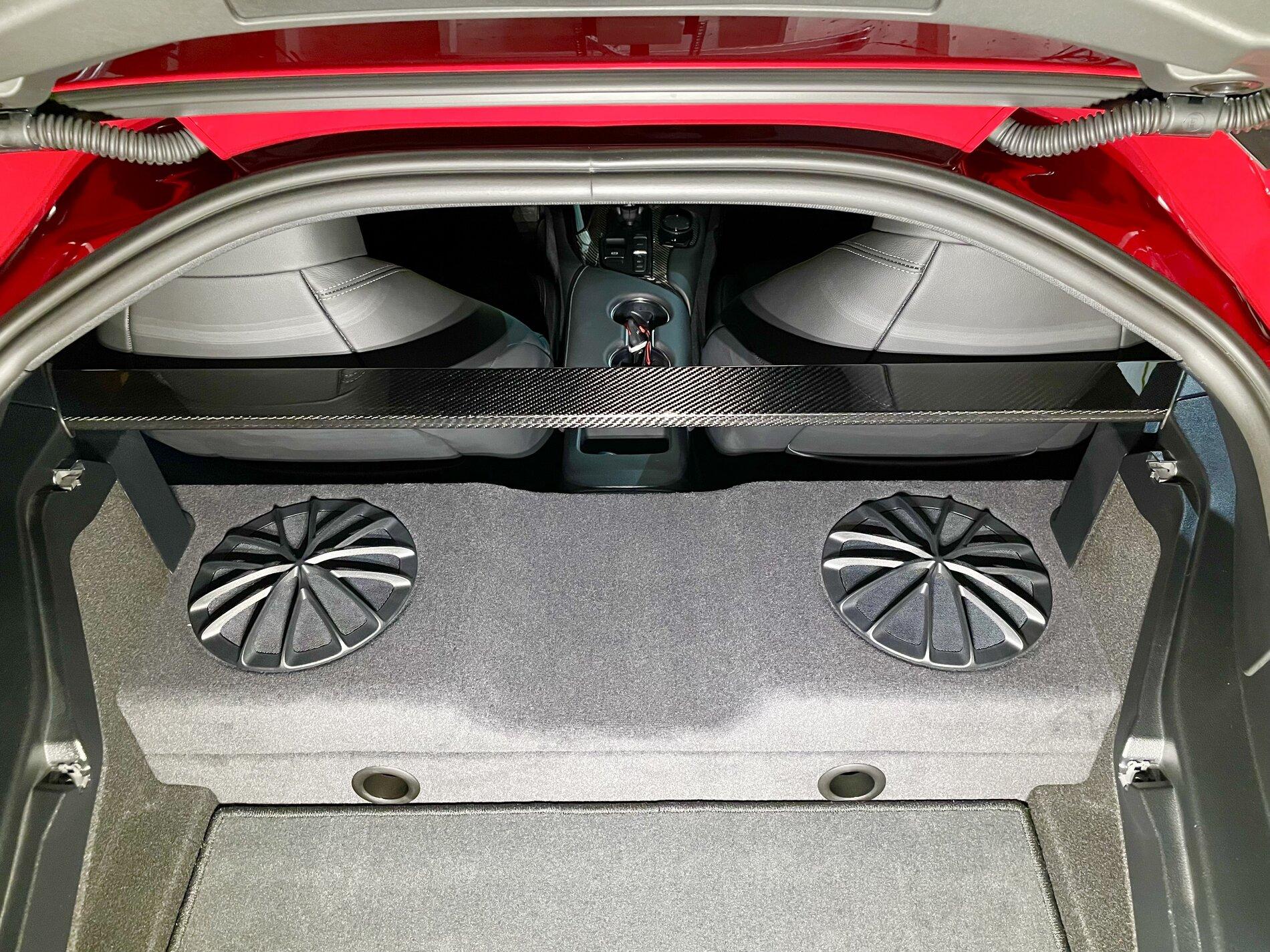

I’ve decided to add a little more carbon fiber to my interior. Its hard to say no sometimes. ?
At least this part helps with weight savings at 1/3 the weight of the aluminum brace. And no more creaks and noises when car flexes.
-RJM
Before:
After:

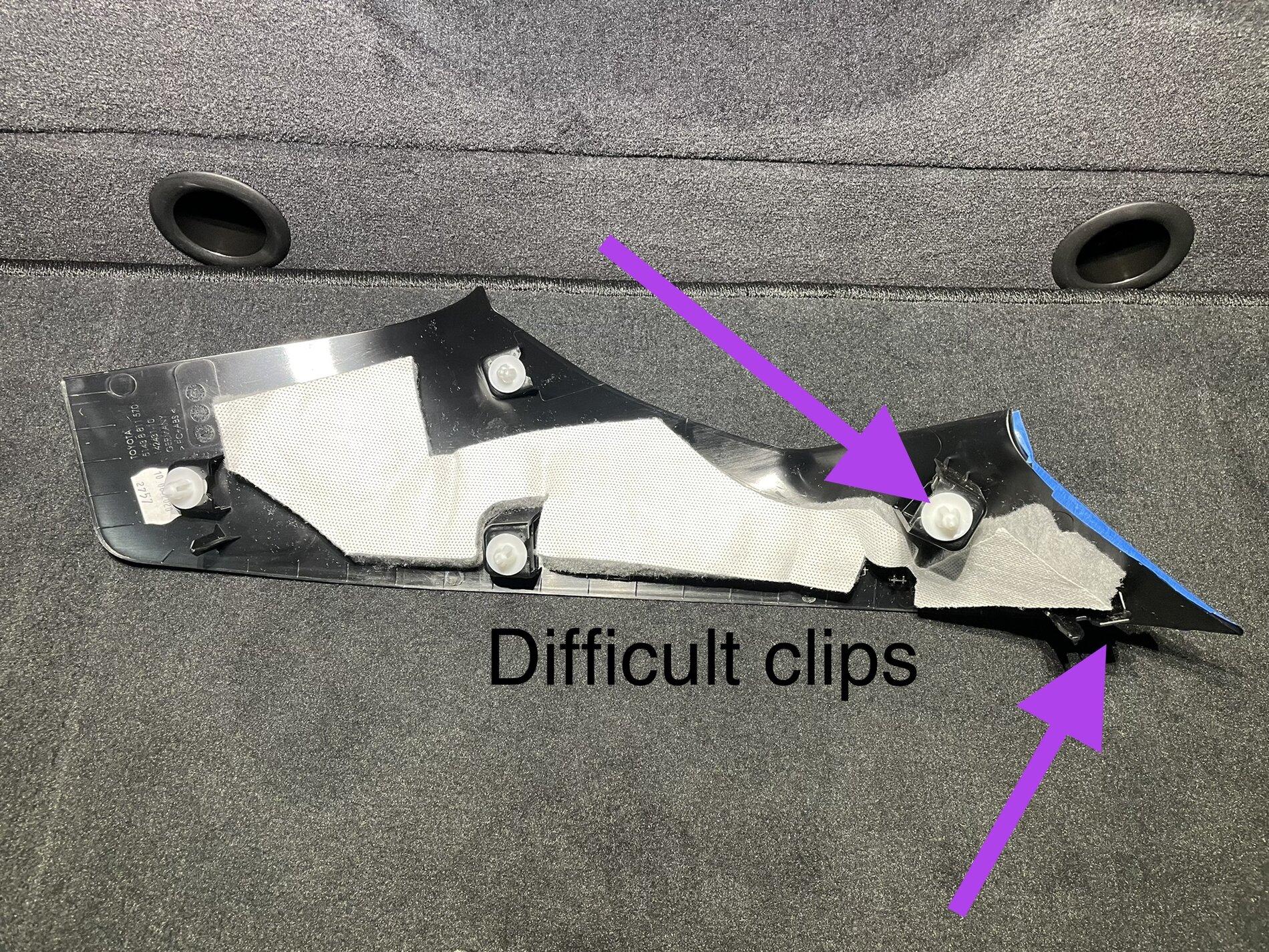

How hard was it to install? Looks great by the way!!!
Its not that bad of an install. There were 2 areas that gave me problems.
First were the clips for the panel that wraps to the small side window. The clips were tight and I had to take a plastic crowbar to break them loose.

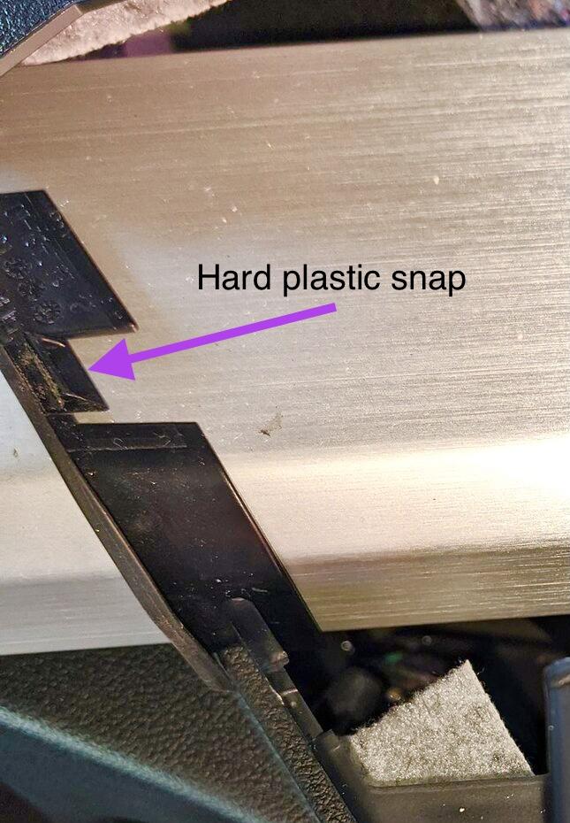

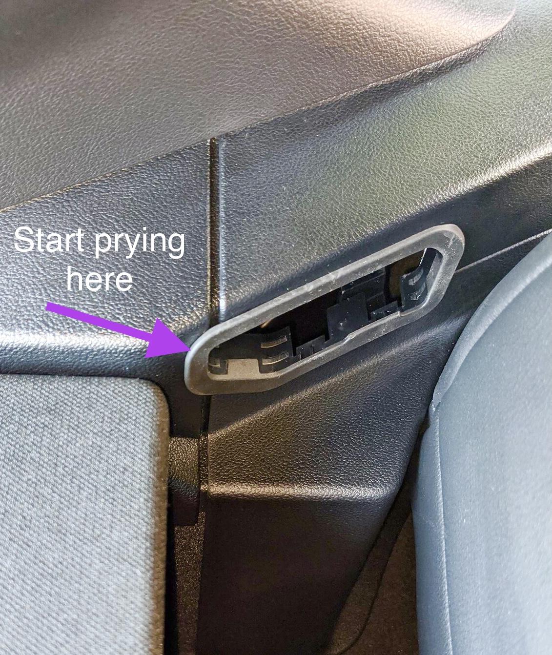

Second was the grommet around the bar itself. Its made of rubber and hard plastic. You need to pry it from the rear and work your way forward. It has hard plastic snaps that need to be popped past the panels.
