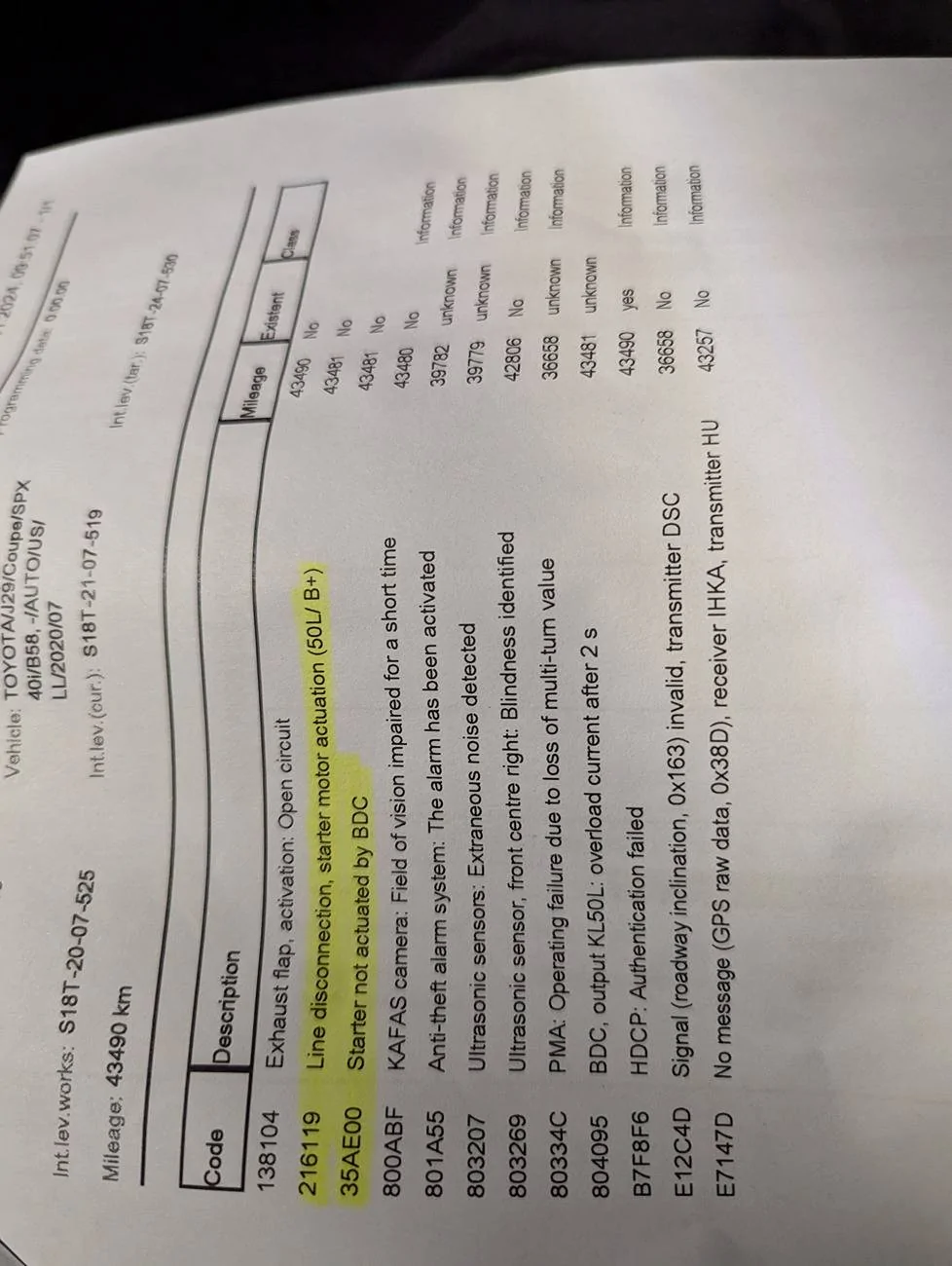

Hello Supra community! I've been a proud owner of a used 2021 A91 3.0 supra for almost 2 years (bought ~18k with armytrix exhaust with bt and AA catted downpipe, now has 26k) but unfortunately having my first mechanical issues ?.
It started couple weeks ago where, the car would not start. Sometimes it'll start the first time and if not, then second or third time. I tried unplugging the ob port Bluetooth dongle but still no difference. Took to Miami Toyota dealer and they said the battery is at 80+ percent so that's not the issue but said they got these errors codes and said the starter most likely needs to be replaced. They quoted me $1100 total for the work ? (higher than I thought it would be) and unfortunately my warranty ended in September (3years+). Does anyone have experience with this type of issue and also, anyone have a reputable shop they trust their supra with in the south fl/mia area? I'd like to get a second opinion and hopefully find another place where I can take my car to when I need more work done. TIA!

$1100 doesn't sound that crazy for NorCal.
The starter itself is $450-$675.
Labor looks like 2 or 3 hours (NorCal dealer rates are $275/hr).
You may get a slightly better price at a local BMW Independent shop.

Hey, so I actually just had this happen to me fairly recently. Don't know why this happens but it just seems to happen randomly I read 2 other people had this happen one was at 12k miles the other at 26k miles. I had it happen at 50k. Don't know what causes it, but the cause of this is definitely the starter, after much back and forth with my Toyota dealership and with the help of my service advisor I was able to get it warrantied under powertrain warranty which is good till 60k miles or 6 years. After they replaced the starter car worked perfectly. My recommendation is try to push and get it covered under warranty specifically powertrain which like I said runs longer than your basic 3 year/36k miles. You might have to go to multiple dealership till you can find one that'll work with you. But also its not the worst thing to replace your self if you have to go that route. I definitely looked into that if my warranty didn't cover it. I did see your in Florida so if your somewhat near me I can try to help but I'm up in the Daytona Beach area. Hope this helps.
