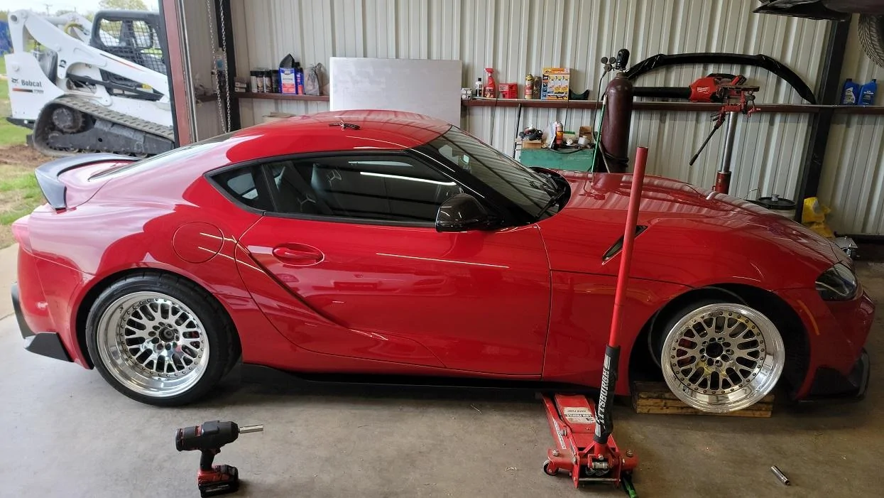

Off topic. Those CCW’s?

Yes they are, took me months to find some new lips but they will finally be on the car soon.
