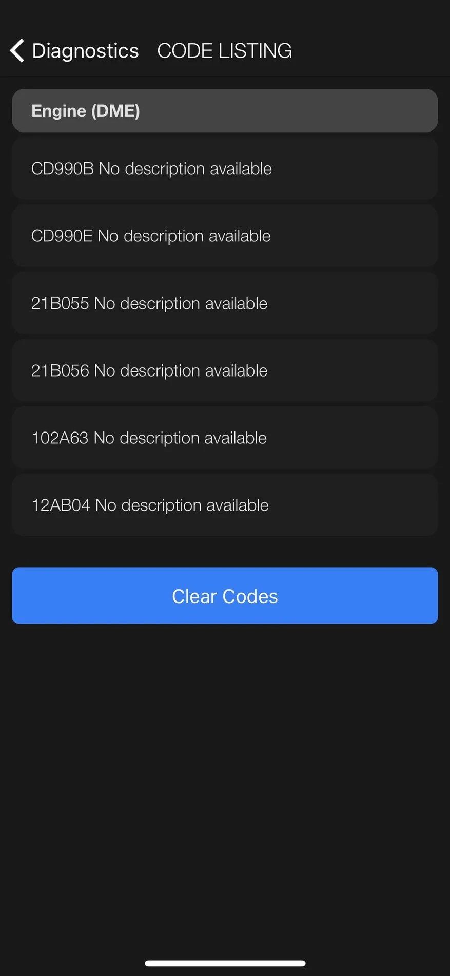

Is it weird that I'm getting the "o2 sensor stuck rich" and "p0141" CEL code and I got it dyno tuned?

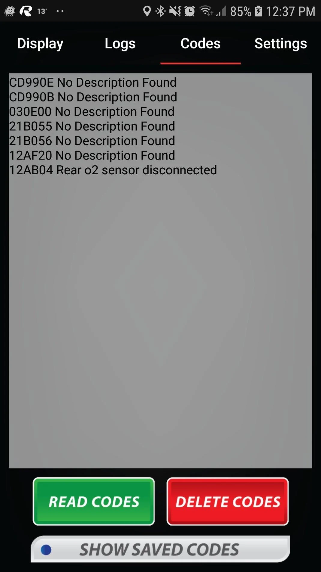

I have a Titan Motorsports dp and I have the fabspeed mini cat. I am running bm3 stage 2 ots tune. Threw a CEL after about 20 miles even tho I selected to turn the o2 sensor off in bm3. Fml
Superfly
Carter
Jun 15, 2020
26
PA
2020 Supra LE #1189, 2018 Honda Civic Type R, 2001 Honda S2000, 2018 Honda Accourd 2.0 Touring, 2007 Acura MDX
here are my CELs that were triggered:

Did anyone figure this out? I have ets catted dp with same codes...
