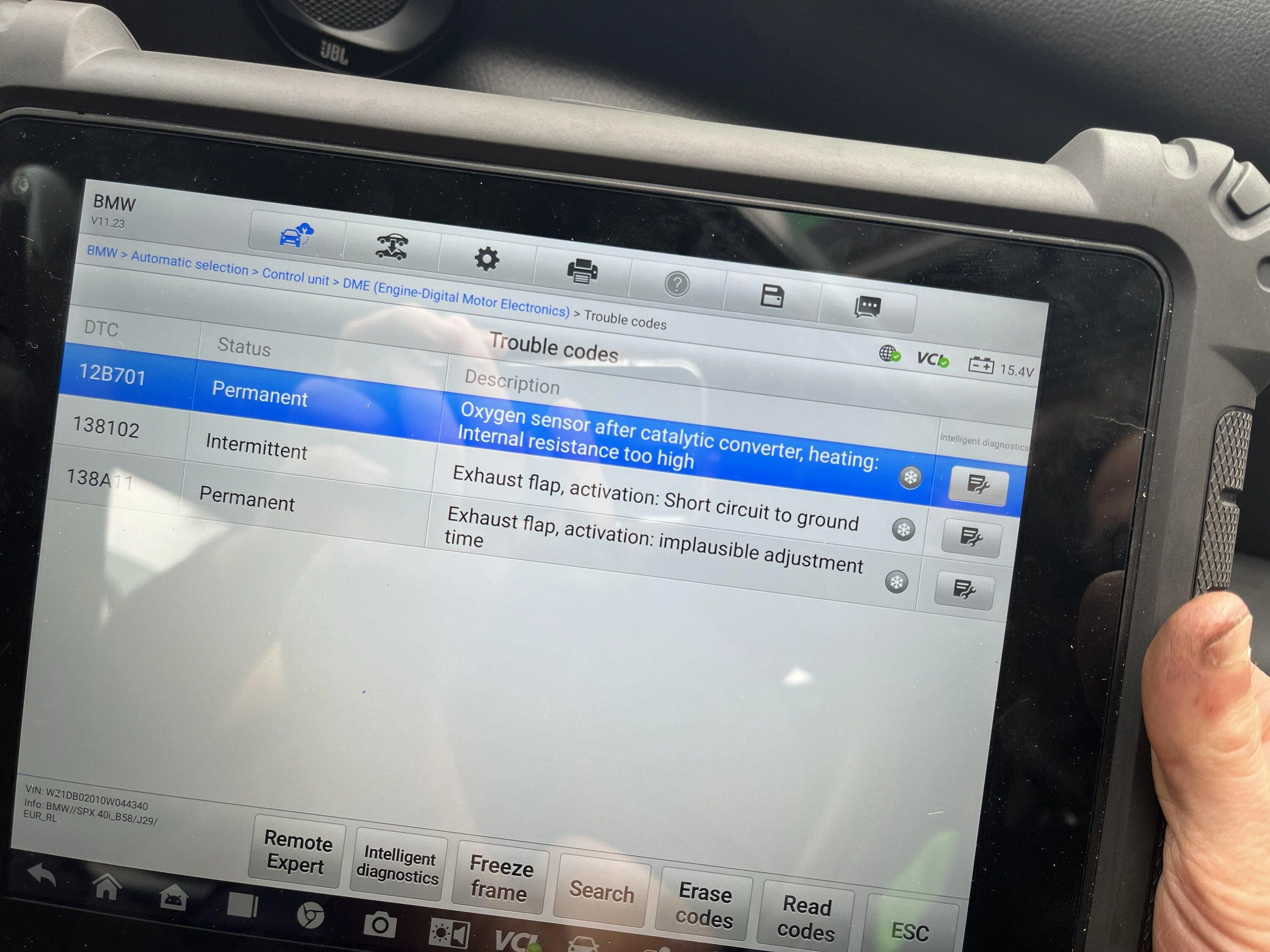

So I started the car today after 3 days of being garaged, drove to the gym and on my way back home the car threw a CEL. Got it diagnosed and the attached photo shows the codes. My assumption is, it might be because I’m running a aftermarket dp (Armytrix catted dp) with no tune (locked ecu ?)
Is it safe to clear this and keep driving? I drove for a bout 5 mins after clearing and the CEL didn’t pop back up. I will drive the car a bit more later tonight.
appreciate any insight on this ??

That's interesting! I have the catless variant of that downpipe with the defouler and never got a CEL in 15 months/21k miles

Might not be the downpipe. Just trying to figure out what the issue is haha. Wonder if cold weather has an effect too ?

Did you pull the exhaust fuse?

Check the o2 sensor and make sure it didn’t rattle loose.
