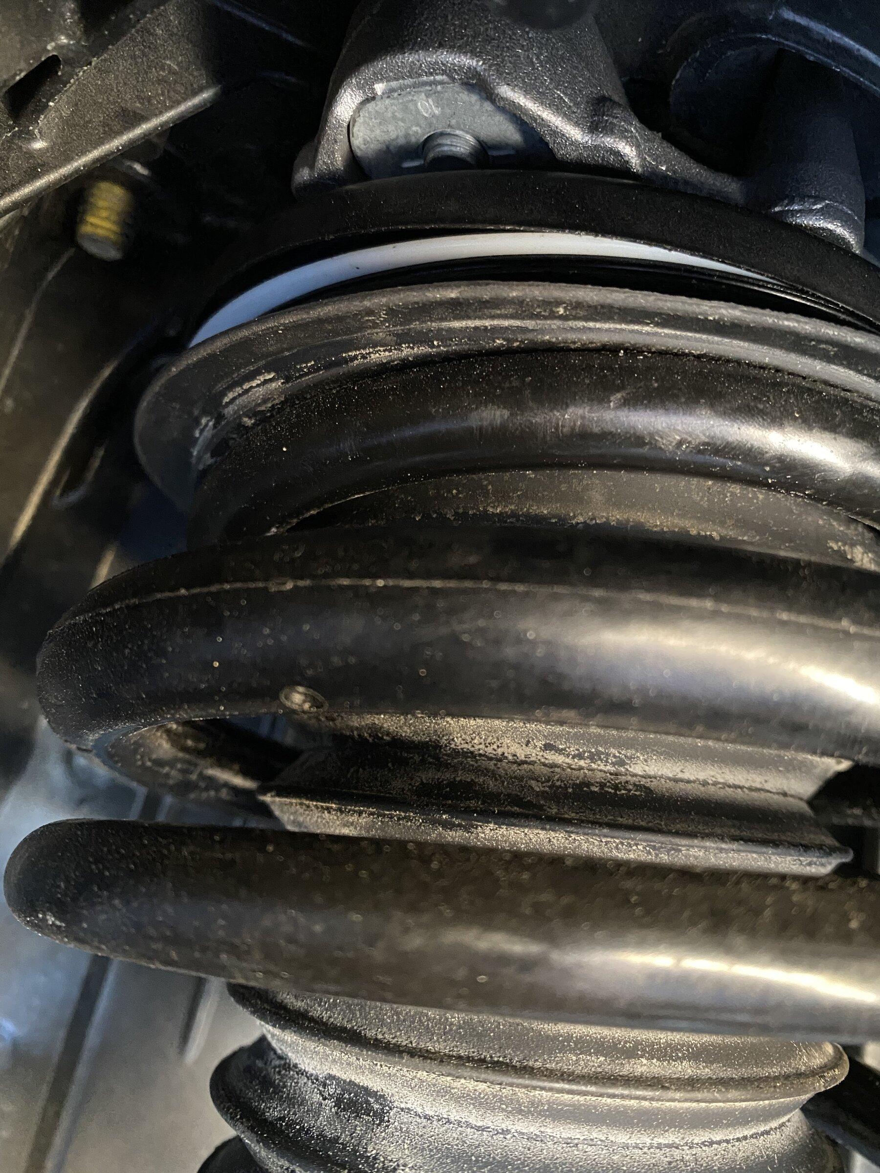

Update: I took off the wheel and turned the steering wheel and found that the sound was coming from the strut bearing as it turned. It was slightly misaligned, and I say slightly, I mean barely off. As the wheel turned, the bearing would kind of separate by a little and cause the clicking/ binding sound. I took off the strut mount and made sure the mount and bearings were all good. I then reinstalled that and instead of bringing up the entire strut, I attached the dust boot to the mount and held the spring up in place while I had someone else jack up the strut until the spring sat in place at the bottom. This seemed to have fixed the issue but we’ll see in the coming days

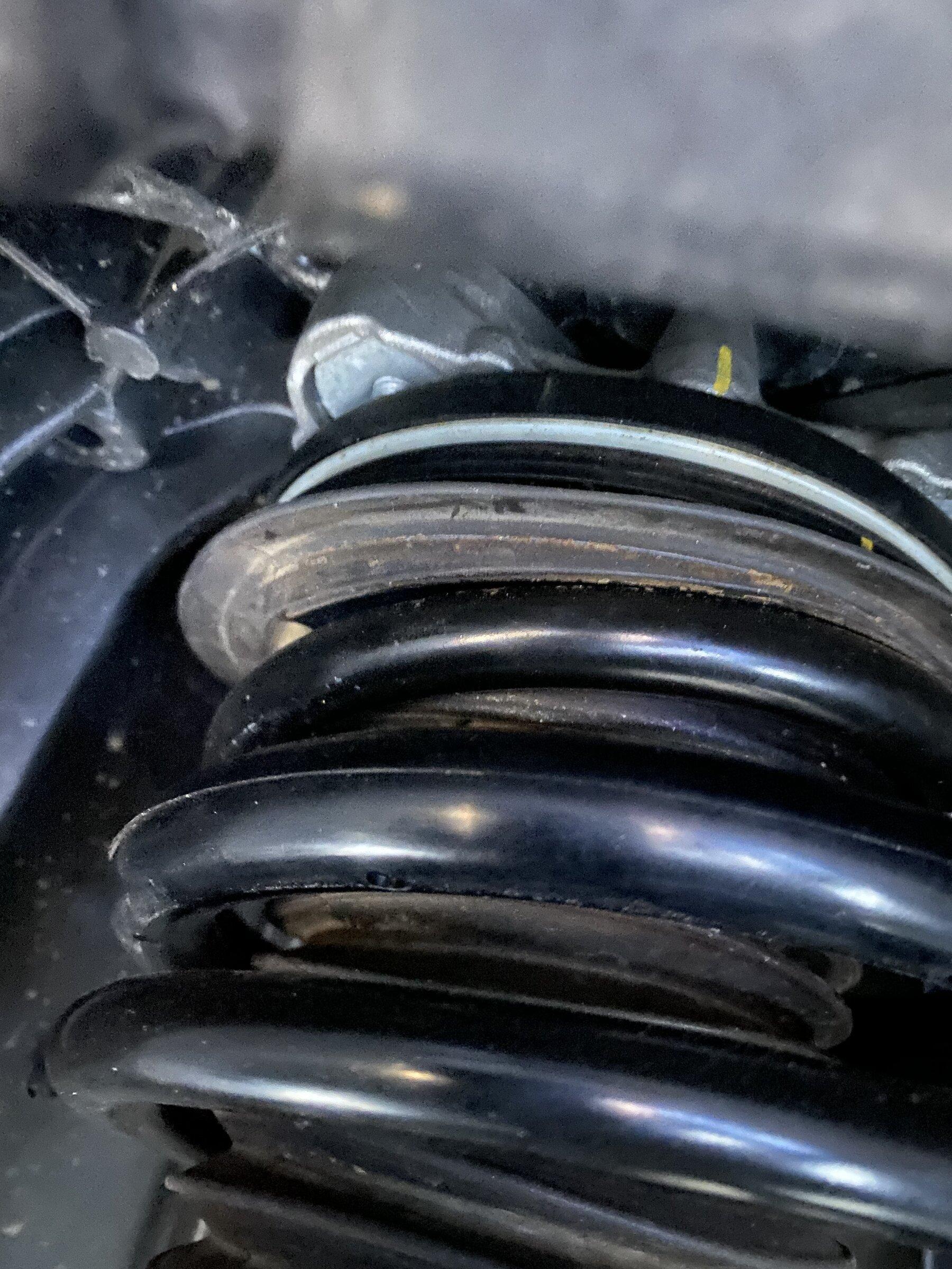

There definitely are. However, after lifting the car AGAIN, I found that the wheel bearings on the strut mount keep on separating a little when I drive even after I popped them back into place every time. I’m not sure why this is happening. I’ve narrowed it down to this being the cause of the sound. It’s happened on both sides and both bearings are still good and nothing is broken. One of them is actually brand new since the old one cracked and I replaced it. Keep in mind that my bump stops aren’t cut
Yep this was what was causing my issue as well, although only one of mine separated and it wasn't nearly that bad. The reason mine separated was because I used the lazy method of leaving the strut connected to the lower bearing and only pull out the tophat section...which is what causes the separation. The easy fix is to just replace those OEM tophats which has the new bearings already, but in my case I just had RSR coilovers installed which was the much better decision anyway.

I think the bearing coming apart just once may be enough to compromise it.

I think the bearing coming part just once may be enough to compromise it.
This. It compromises the bearing just enough to cause noises. The functionality is fine otherwise, but it's an annoyance that I couldn't deal with.
